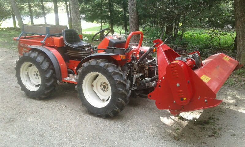

The right way is to have the mower in front of the tractor.

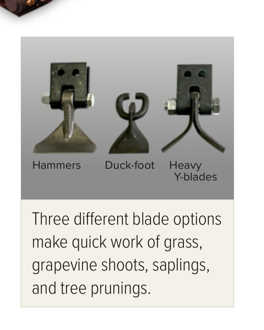

The cast hammer knives are used for orchard and vineyard shredding of limbs and both large and small pruned grapevines and berry canes.
The scoop knife is an all around mowing knife.
The side slicer is the best knife for mowing good sod and brush as you can recut everything on the second pass.

If you can swing the cost, the WoodMaxx 62H would be the ticket. With the hydraulic side-shift you can mow along the fence line and slide the mower in and out under the fence as you go along. This would require remote hydraulics.
The Y blades are a good course blade that doesn't leave a perfect finish, but will still cut heavier materials. The fine cut mowers use about 3 times as many narrower Y knives and achieve a better finish. The duckfoot blade is kind of an in-between of course and fine cut. It will leave a nicer cut than the course Y blades (flat top grass, not V shapes), but will still cut heavier grass when needed. The Hammer is good at what it's name implies- hammering. It will cut down small trees given a big enough power plant to run it. It will also cut grass, but it does require more HP to run it. They are also more brittle when hitting rocks.
It is difficult to find a newer mower that uses the duckfoot blades. It sounds like this is the kind of blade you are looking for. I would suggest looking for a used JD 25A or a Ford 917. They use similar blades - JD uses the duckfood, Ford uses an airplane wing. Both have some parts availability, but avoid mowers that are in very rough shape and missing major components.

Not who you are asking, but I'll answer. The Ys on my old 719 cut field & pasture great. You could have probably cut a lawn with it & looked fine. I upgraded to the Peruzzo with hammers for brush. I only do pastures & fields or even less developed areas so handling bigger material, trash & what not was mor important to me than cut quality. The Ys would cut finger sized woody material well, but any bigger than that & the knives would just bounce. It would get noisy & just strip the bark off.
The Peruzzo & hammers will eat trees & branches up to wrist size easy if I have the HP. The hammers do fine on grass too. Again I could probably even do a decent job on a lawn if the whole setup weren't 8,000lbs. I thought my hammers were getting a bit dull & needed spares anyways, so just got them in. The new ones are pretty dull as well, guess I never paid attention to the original ones sharpness when new. They still cut well.
