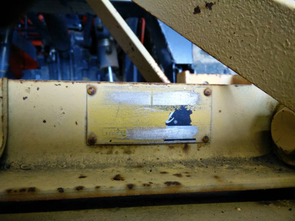

I'm getting ready to jump on a flail I've found online. It's a Ford 917. The website says it has a 88" cut which seems common however, Flailmaster says there are only 5, 6, and 7 foot models. I assume that should be considered a 7 foot?
The unit is missing some knives so I figured I will replace them all, but I can't order the correct parts without know what is what
I assume you measured outside? Flails are typically measured for working width. You loose or gain 6-8" for the pulleys & what not. If you look at the name plate, there is a different model in addition to 97 listed that relates to width & knife type. Mine was painted over on the frame. I think Flailmaster has a reference for some or most of those other model numbers.

22-185? Is that the rest of the code?
Online it says 88" cutting width. Maybe that just the width between the guide rails?

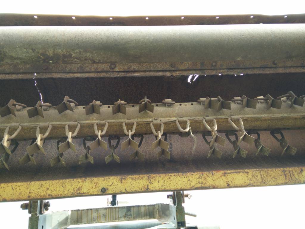

I believe that when I looked at a picture of your flail someone had put too many blades on it. IIRC you had a blade in ever other hole when it should have been every 3rd hole. That is likely why you came up short.

Entirely possible. But it mowed well until I retired it to my backup mower after several years, so a bit moot at this point. I was 10 stations short if I recall, which was about 1' worth. I suppose thats around 1/3 short as well. I was somewhat matching what had been on previously. Probably not the smartest idea given they removed some bands of knives because they were hitting the dented & warped hood rather than fix things properly. If so hopefully somebody else learns from my mistakes.
Think that photo was when I replaced the rotor bearings after a few years.20161025_152850.jpg

This is the picture I was thinking of. I see blades in every other hole. They should be in every 3rd hole. As you said, moot point. It probably cut better this way because of the increased overlap.

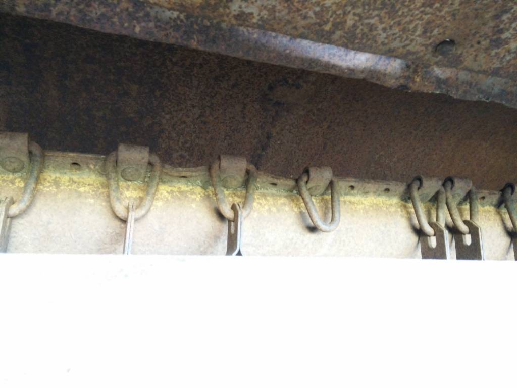

You can see some of the D rings there missing knives. Those were from when I got it & the missing knives were hitting the hood. Had to cut out & patch a section.
7' of flail, apparently with extra knives ran ok behind a 32hp L3200 for several years. Vibrated a bit, but you can see how straight the mounting tabs are. The hood was cracked all the way along one of the braces too. It worked well enough & would have been a pain to weld up that rusty mess. If I was motivated enough I might try to remove knives & reshuffle things to try it & see if it balanced/vibrated or cut any better or worse. But I'm not, way to many other projects & it's mostly retired. No plans to sell it or scrap it though. Keep it around as a backup if the new Peruzzo goes down on me.

My 917 has the airplane wing knives and wonder if I could set it up with a knife in every other hole like in that picture?

You could, but you might push the balance a bit. If you have the time to invest in it you could try and see how much it vibrates that way. You may have to adjust the balance weights on the rotor. It's just a few small pieces of steel bolted on.

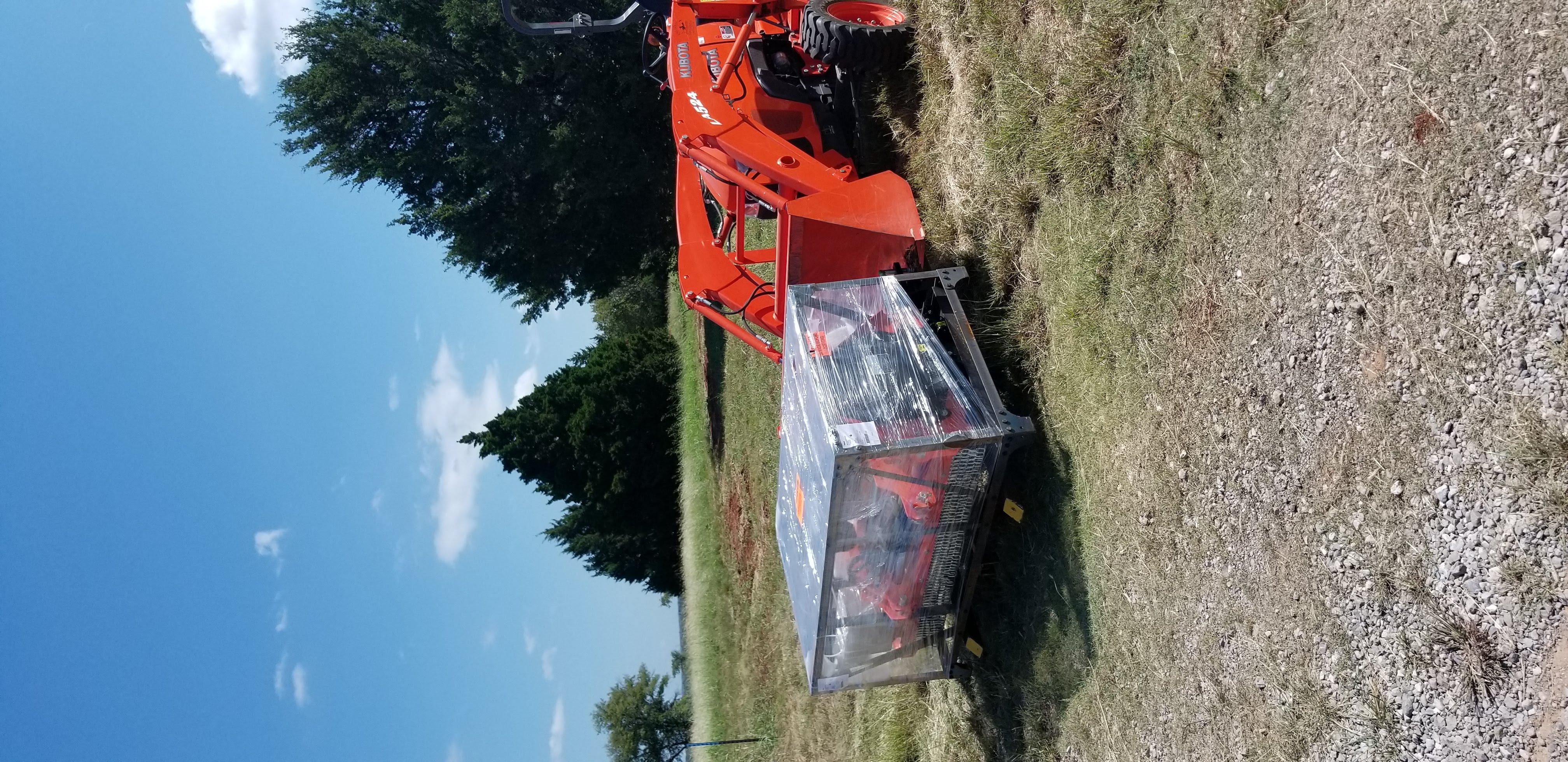

thanks Bruce good idea on the rear flap. I had WoodMaxx send me the gear oil so I am good there. Picked up the fitting for the hydraulics also. It looks like my transmission and hydraulic share the same oil.
My Kubota L3200 barely got it off the truck. I have forks attached to my bucket and flat it would not lift the mower. Driver said it was 900 lbs the manifest says 848 lbs. I was able to tilt it up and then it cleared the truck bed. Slowly backed away the lowered the bucket. Once about a foot off the ground with more tilt I was able to lift a little. Hope to have it ready to try out this weekend.

My B2910 had no problem unloading my WoodMaxx from the truck. That’s the difference with dedicated pallet forks. I used bottom crate to make dolly for the mower.
/ Let's talk flail mowers #6,359
I'm sure dedicated pallet forks would make a big difference. With bolt ons, you are WAY far from the "pin".
Also, Kubotas aren't known for stellar lift capacity.
For yours:
Lift to full height (at pin): 1,131 lbs
Lift to full height (at 500mm/20 in): 855 lbs.
20" with bolt on forks isn't even to the edge of the bucket and you have all the weight past that. I'm surprised you managed to get it off the truck.
Pallet forks aren't real expensive, I'd invest in one if I were you (I did because I AM me ;) ) I have used them to get attachments off trucks, I cut logs to 8' in the woods and bring them back to the house on the forks, I stack my split wood in racks (1/3 cord) I custom made where the wood dries and I can move them up to the porch landing where I can pull the wood as needed from inside the porch (2 door onto the enclosed porch) and I've dug out rocks in my field and moved them to the rock piles started most likely 150+ years ago by others. You will find plenty of uses for forks if you get them.

without a doubt I will eventually want to get pallet forks, but without a quick connect FEL was trying to get by until I am ready to make the change to a Quick Connect. I may look at pallet forks that pin on.
