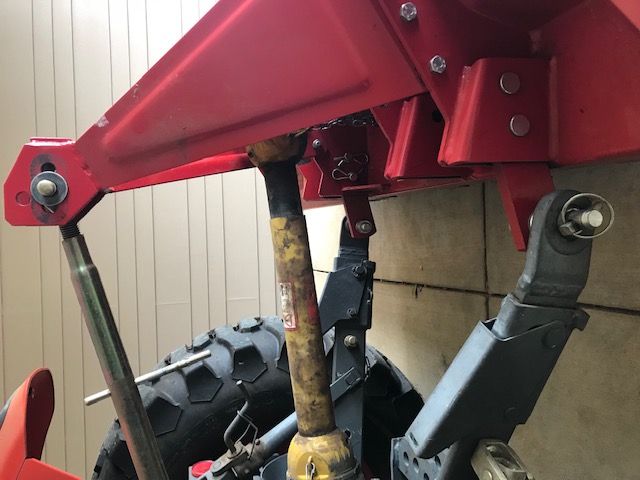

You use the top link to control the height, extend it a little. Then raise your skids a hole or two. Will still hit the skids before the roller. It's not an either /or, both can be kept in good shape.
I will try to adjust it as you suggested when I receive my new skids. As it is set now, when the mower is resting on flat ground the roller is 1/2 inch higher.
Now I am not sure what you mean by adjusting the height of the mower with the top link. My understanding of the top link function is for adjusting the longitudinal level of your implement, in this case the flail mower.
On my rig I adjusted the top link, so the pin is located in the center of the slot of the mower hitch frame, when the mower is resting on a flat ground (see picture).
The only way I know for adjusting ground clearance of an implement is with the hydraulic 3-point hitch. The position control lever lowest limit can be set with a lock bolt on the quadrant. I wish my tractor was equipped with a draft control, but it is not.

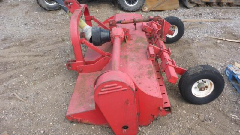

How come I can't find any prices on flail parts from Flailmaster, Montage, etc? I used to have a lnk to a flailmaster catalog that listed prices, but now that link is dead. It sure would save time on the phone to know what knives are going to cost, instead of me asking "how much are the standard duty blades? Well, how much are the heavy duty? How about the extreme duty?" wasting my and the phone rep's time.
Also, I just got done cleaning up my Alamo SH88. Sanded, painted. I want to put the decals back on there. Called Alamo and they quoted me a "Decal Kit" for $180!!! Sounds a bit stiff, to me. After all, I'm basically advertising their product by putting their name back on it.
Ok, now I understand. My Dandl does not have a slot. I lower my lift arms all the way down so they float. The top link holds the top of the mower back, and the lift arms hold the bottom forward. The mower rides on the rear roller and follows the terrain in the exact relationship at all times. By extending the top link, the mower pivots up, raising the rotor higher. When I go through a divot, the arms just raise up in float. My lift arms have slots to allow the mower to follow the ground when one end needs to be higher than the other.
I know none of this helps you. I would like someone else with a caroni to chime in to see what they do. How do you maintain the same cut height with the slot? Seems like the mower would change the angle of attack over every bump. Reach out to Island tractor as he seems to have been using a 1900 caroni for years.

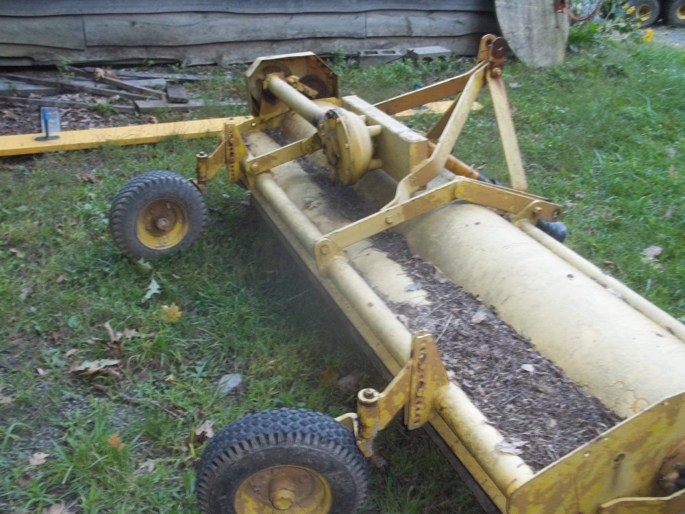

Repairing a seppi sml 200 put 3 sets of blades/shackles on each end of rotor. not missing any other flails but I have used a couple generic blades but tried to place them equally around the rotor to keep balanced. I'm still getting rotor vibration. Do I take a magnet mounted dial micrometer on the rotor to determine if the bearings are bad?
/ Let's talk flail mowers #5,868
Hello 10backacres,
If the knife mounting stations are not within each others orbit that will be a huge problem as it will not spin up as a balanced flail mower rotor.
The safest way is to use a mechanics stethoscope to check for bearing noise with the mower operating at 540 rpm. I would remove the knives and shackles and then run it up to 540 RPM to check for vibration. If the rotor is still vibrating still I would double check each housing using a mechanics stethoscope for noise and once you found the bad bearing plan on changing both of them as the opposing bearing will fail some time in the future.
I am not even sure if they mail a catalog out anymore. The cost of decals is something that they-Alamo will always make a lot of money on and it costs very little to have the printer make them.
If the ID tag is still riveted to the mower and in good condition I would not worry too much about it.

Hello Leonz I'll probably remove all of the flails on the 200 that's 52 bolts! All in locations too tight for access with air tools so it's a hand wrench job. My son thought a dial indicator on the end of the shaft would work. Do you think I should intersperse the new flails along the whole rotor rather than at each end since they all have individual orbits,and use only 1 new flail with an older flail per shackle? I've always lightly touch sharpened each blade in the past, would that have changed the balance?
I worried about that on my old 917 when I was short some flails. I was surprised at how smooth it ran when I lost a couple knives due to some rocks. It wasnt that smooth, but it was suprising it didnt sound at all like it was trying to tear itself apart. I tend to think you'll be fine doing any reasonable job replacing knives as long as you stick with the same type. Interspersing them evenly would be the best option.
So lets get back to the way these things are adjusted to mow. I have the Caroni also so I have a hole or a slot to hook the top link to. I've tried both and not sure how much difference it makes.. AND apparently having the skids at the same height/level as the roller is not correct either and I have the grooves all over the place to prove it.
So how bout a tutorial/discussion on how AND why everyone adjusts and hooks up their flail..
thanks...
Lengthening the toplink forces the flail to rotate backwards which pushes the rear roller down and increases the cutting edge to ground distance.
