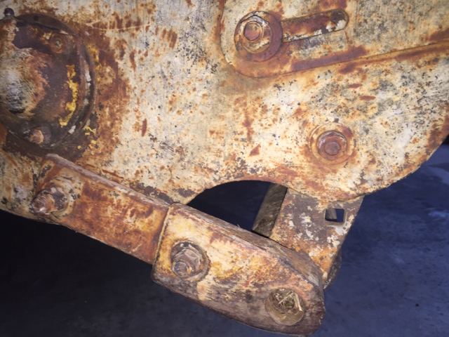

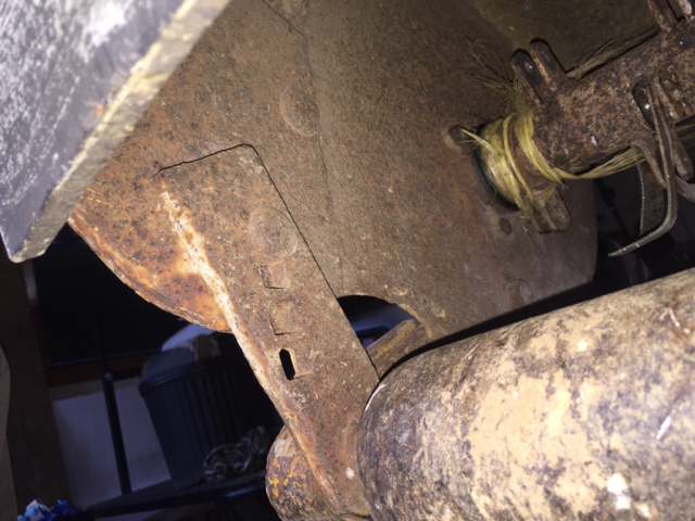

Lengthening the toplink forces the flail to rotate backwards which pushes the rear roller down and increases the cutting edge to ground distance.
Aaron Z
Yep, I understand that part, use the slot or just the hole?

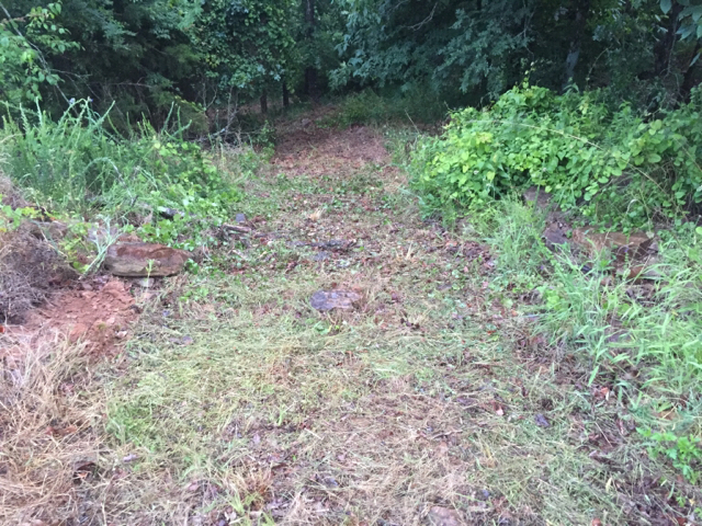

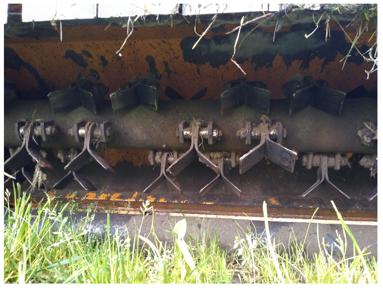

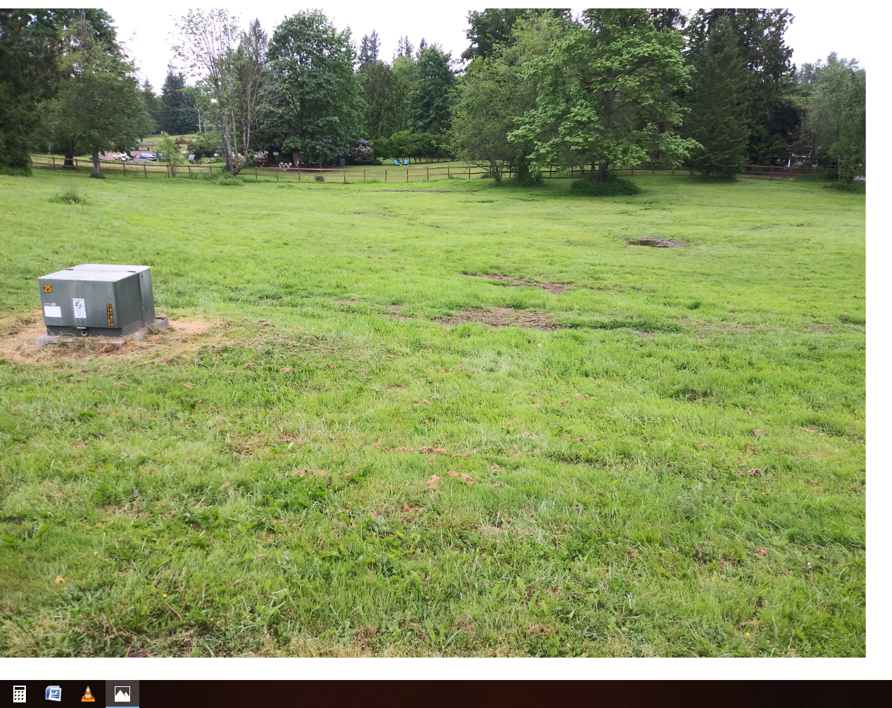

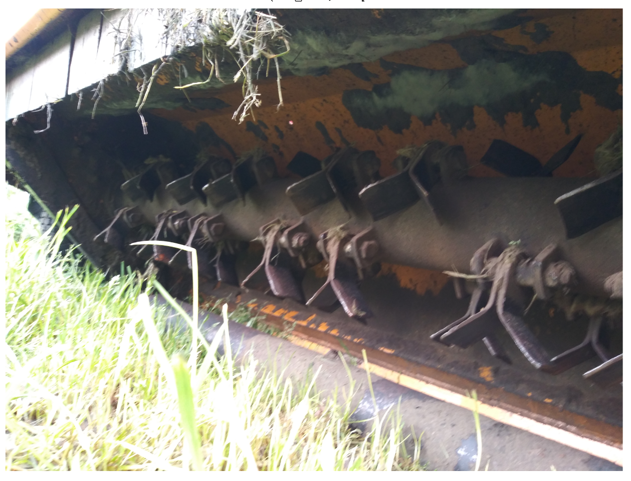

Anyhow. I have 4 rows 8 blade stations each. Not spiral arrangement obviously. Checker board.
yes, waffle effect is quite observable. Give it about 5 -6 days, and it clearly shows itself.

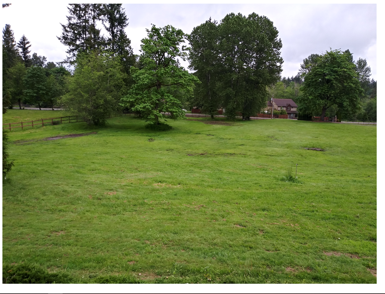

Also, pics of part of the property that is hills and valleys and wetland, for better understanding of what I mow. Needs dozer and nuking it into flat surface, except that wetland is not permitted to be changed. Plant on it, mow, sure. Nothing else.
So I am all for horizontal cut blades, just not sure which ones.

to maintain better control and cutting height for your flail mower you need to use the single mounting hole on the three point hitch.
Thanks..
So then whats the purpose of the slot?

Anyhow. I have 4 rows 8 blade stations each. Not spiral arrangement obviously. --------------------
Mine is a single spiral. The hangers are evenly spaced in the row:
Yours is a double spiral arrangement. Two hangers closer in the row, in a double spiral around the drum:
I would think for more level terrain, like a large flat yard. But even then I would just use the hole. Good question. Maybe leonz would like to offer an explanation...
