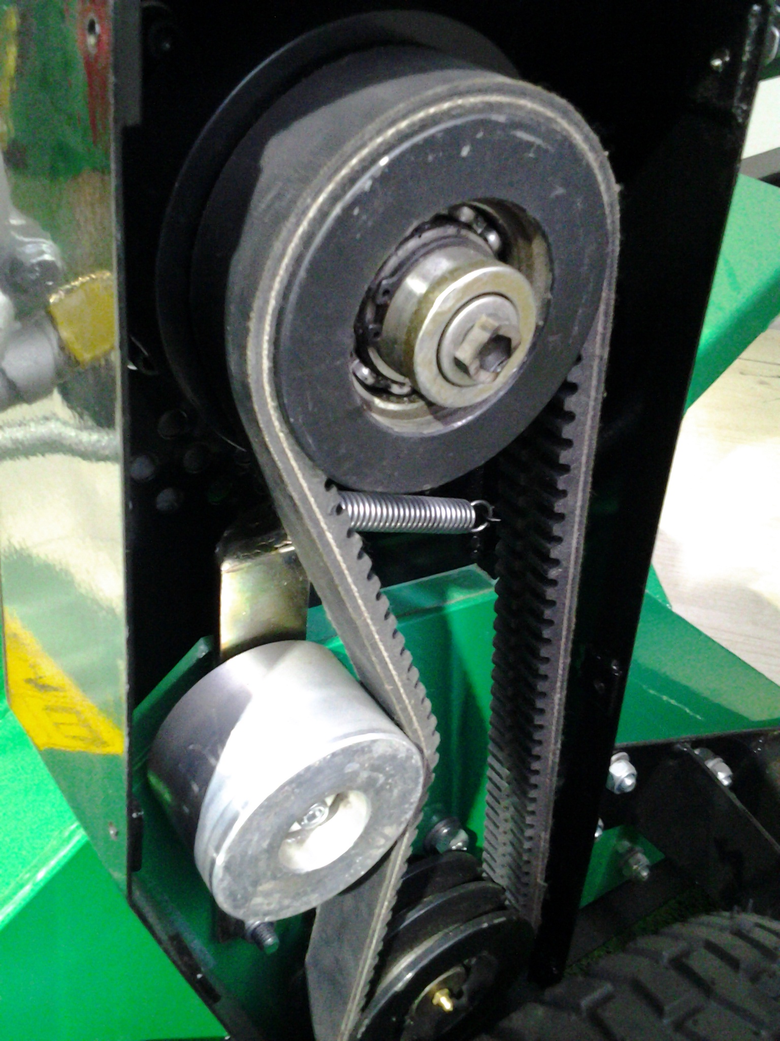

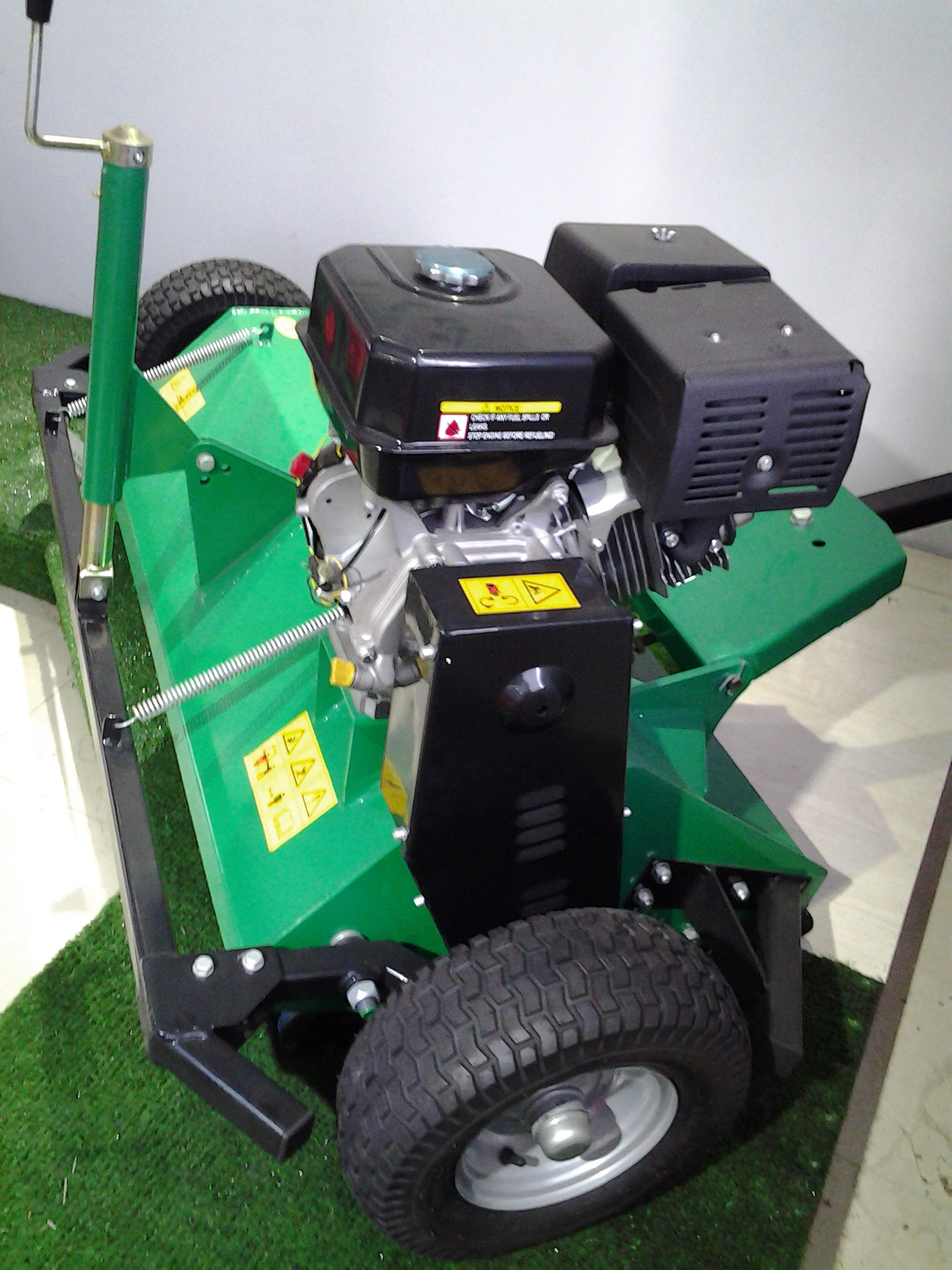

Hi ukrkoz, is its belt tension tightened by one single spring which is nearly half inch diameter? Like this one? 20140402_081619.jpg20140402_082316.jpg
According to the photos on their site, it looks like same belt tension system like this. This type belt tension system was proved not solid for years work. I think even Betstco didn't realize it, they started ATV flail mower sale not so long time. My suggestion is that you can buy some of that spring, clutch, belts in your stock.
I just want to know if that factory improved on this point. Thank you.

Here's mower I have:
PK-AT Gas Flail Mower |
scroll down you'll see pics from any angle. Hammers are regular Y shaped ones.
Engine is:
15 hp 420cc JiangDong electric start
But allegedly it is exactly same engine that is made in Honda engine factory in China and sold as Honda, just with another sticker. I can vouch to that as I have noticed "Made in Japan" components on it.
I finally got under the deck Sunday and cleaned it. Boy oh boy, was it dirty after mowing over wetland puddles!
I also took my angle grinder to hammers and sharpened them on the rotor, to best I could. took me maybe 30 min laying on the ground, no big deal.
I ALREADY know how much faster it mows for one simple reason. I took my 60'' Hustler ZTR for a quick spin on the grass, just to compare - and that's exactly when I realized, how SLOWLY it actually mows. Flail goes oh so much faster! And I was so proud of my ZTR.
I now need to figure, to plot, best mowing route, so that I do not get stuck in tight corners and forced to do 3 point turns. THAT is not quite easy with side by side and 81 inch wide mower combination.
I am also still experimenting with cutting height. My property lower tier is VERY uneven, bumpy, I have to be mindful of how I traverse bumps without flail grinding into the dirt.
Oh, and believe it or not. Ever since I started using flail, moles disappeared from the property. Before, I had hundreds of mounds killing mower blades. Now - I have maybe a few, and all on the outskirts. Now sure if they simply don't like the noise and vibration, but they are GONE. Hallelujah!

Hi ukrkoz, is its belt tension tightened by one single spring which is nearly half inch diameter? Like this one? View attachment 603370View attachment 603371
Mine has THREE belts but tension system is same, indeed. Roller is much wider to work with three belts.
It looks simple enough to be reliable but what I do NOT like is how much racket is produced when clutch engages. That does not sound reliable. I had many calls placed with BETSTCP teck, Jason, he saus it's normal. I might actually get a spare clutch for that exactly reason.
