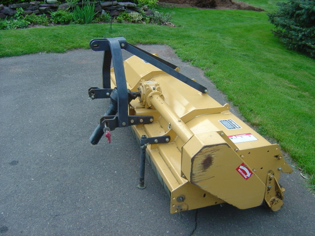

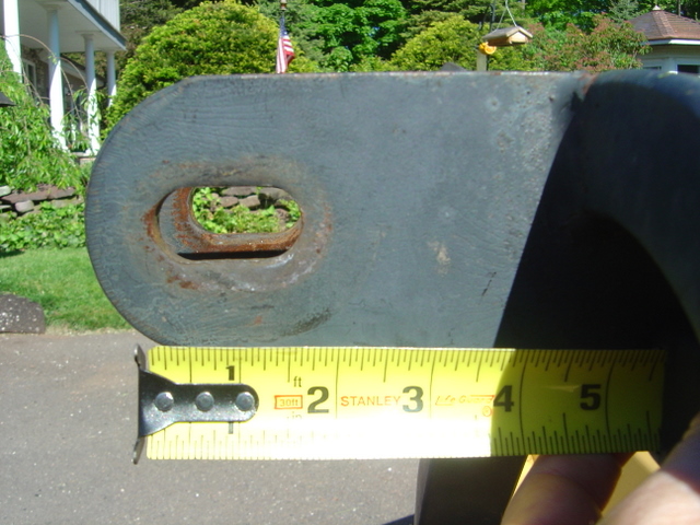

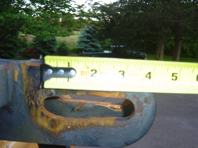

/ Let's talk flail mowers #515
This is a followup to my earlier postings where I was having trouble with going over hills and into dips. IronHorse provided some great replies and the bottom line is that the slot where I attach the toplink needed to be expanded. Thick metal! Well, I got the job done and figured I post a followup in case it may help someone else in the future. The slot was only 1.5 inches and its been expanded to about 3.5 inches. This did the trick. Anyway, here are the pics.
The far right pic is obviously the flail where the middle pic is prior to expanding the slot. The left pic is the post expansion. I just need to clean the area up and apply some paint!

scuvnut.// Thanks for telling us how you went , i'm glad slotting the hole has helped .
