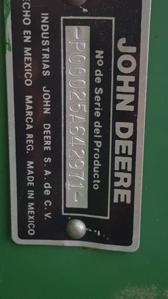

Hello Jthibideau89,
I see that your flail mower is one of the units made in Mexico. My fathers 25A was made in Moline, Illinois.
The image with the V belt pulley that walked out you were so kind to provide is very detailed. It appears to me that there is a grease fitting that may be broken at the top of the bearing flange.
I would talk to the flail master folks and or the JD Deere dealer and ask them about this as you must find out if it has a sealed bearing set or not.
I would also check to see how much it would cost for replacement bearing mounting flanges with grease fittings installed in the machined part as you have a 7 foot wide cut flail mower that if purchased new it would cost $8,000.00+- plus freight and sales tax if purchased new.

S/N tag is preseng and legible. I already picked up the operator manual. The drve shaft bearing is a cam lock type with a single set screw on the collar. The set screw is tight to the shaft. The collar came loose from the cam on the bearing. Perhaps I secured the cam in the wrong direction. Will resecure so that the forward rotation tightens it. I didnt think that the bearing drag would be enough to loosen the cam. May just need a new bearing.
Will pick up new hangers today from Flailmaster. I work a few miles from thier shop.View attachment 557098

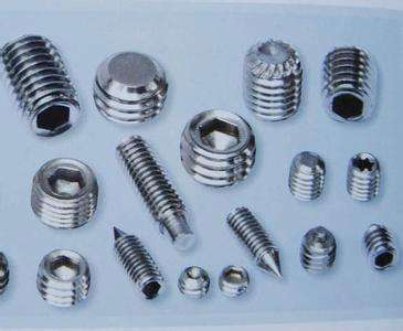

I think the space between shaft and bearing is too big, you can feel if it is too easy to install the bearing onto the shaft, it is a question related to production processing accuracy. Mostly this Mexico factory ignore something details when they produce it.
To avoid it slip, I suggest you to drill a small hole(no need too deep) on the shaft end, then the set screw of the bearing could go a little into this hole on the shaft.
And there are some different type of set screw, I don't know what type your set screw is, you can check some other type. timg.jpg
/ Let's talk flail mowers #5,135
Thanks for the suggestion, but the setscrew and collar is not coming loose from the shaft. The eccentric end of the beariing is uncoupling from the collar.
