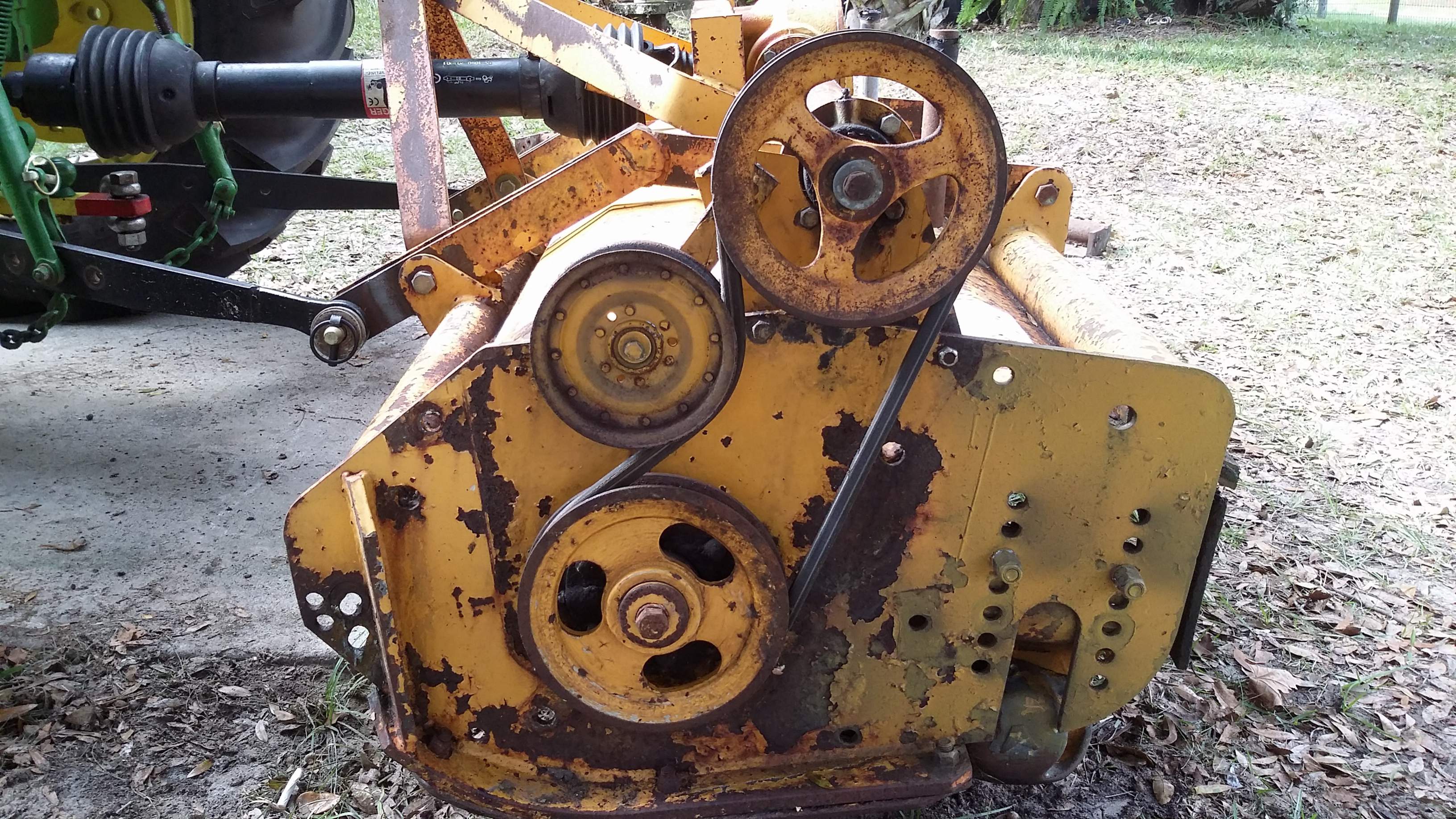

I've got a mower that will suit your needs. Be excellent for ditches, a bit short for much of a field. But you can't bog them down. listed on CL right now. EnoRossi 5' sickle mower with hydraulic lift. Can mow in straight up 90 deg and down to 75 deg. Model 150 CM. $1800 in excellent condition.
/ Let's talk flail mowers #5,165
Can he purchase spare tiger teeth or a complete bar locally from a Hesston dealer?
Is it a hydraulic drive sickle mower with a #60 or #80 roller chain drive?

It appears to be a belt drive, it is probably actually a model BF150H. You can see the implement end PTO stub shaft on the second picture and that there is only 1 hydraulic line (to lift the cutter bar).
Messick's has an ad for a new one for almost $4k and they list it as being belt drive: Enorossi BF15

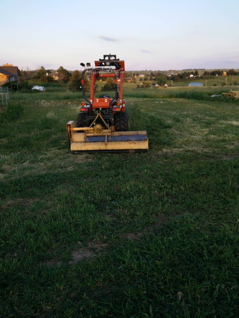

I picked up my Woodmaxx 78 today. I ordered it on 18 May. So a little less than 30 days. Some assembly and I did have to cut the PTO shaft a little but not anything that was a big deal. I lubed it up and set the height to max, I pulled the grease zerks prior and then re-installed after height adjustment. It is much easier to adjust the height once you have it mounted to the tractor and then just lift it up. You need to remove the gear box shield to mount the clutch pin. Comes in a very solid aluminum shipping frame.
I used t for an hour and all I can really say is I should have purchased one year ago......huge difference from bushhog cutter. I was cutting 5ft high prairie grass.

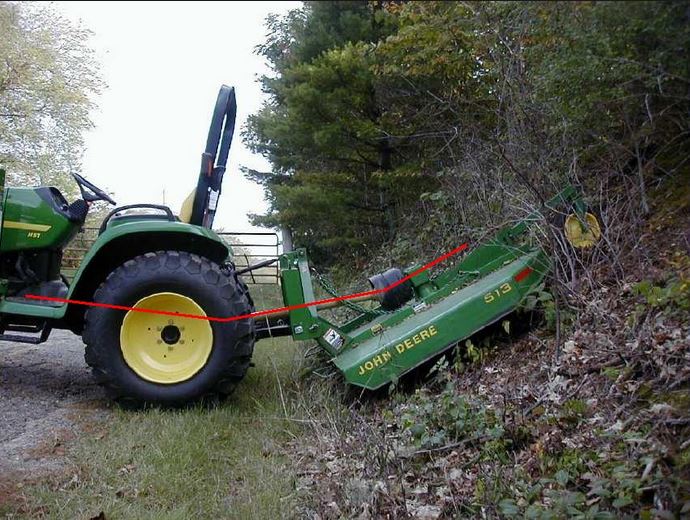

Sometimes, when the tractor is going through a depression and the back wheels are going into the depression, the mower rear wheel or roller induces a twisting force because of it's leverage advantage . The 3pl gets bound up and the result, if you dont have chains on the headstock, or a slotted top link hole, is bent components .
That is why chains are usually fitted to the headstock of most Bush Hog's etc. so the mower can pivot on the lower hinge of the headstock . If the mower is fitted with solid steel straps, instead of chains, the top link on the Tractor must be flexible enough to absorb the change in angle .
It is hard to explain in text . I will add a photo from TBN to try and visualize it . This Bush Hog is fitted with chains on the headstock and you can imagine what would happen if it didn't have them . chains.JPG

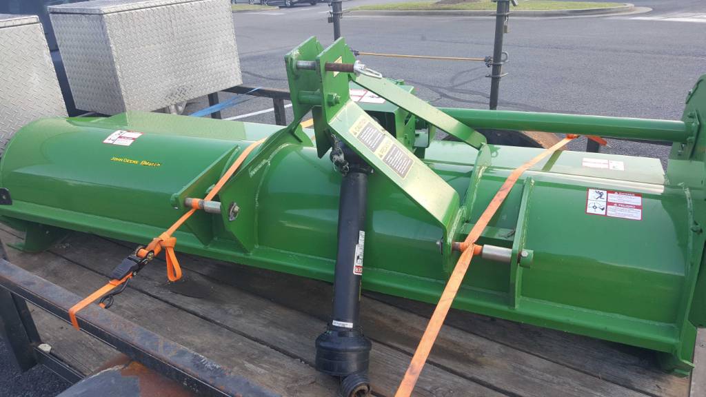

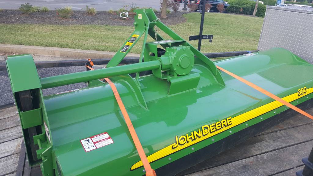

Just picked up muy second flail mower in 3 weeks. This one is for our 55hp 4wd AGCO ALLIS for the bulk of the hill fields. JD 390 8' wide. 2016 model with about 10 hrs on it. Still shiny and has all the stickers. This one also does not have lube fittings on the rotor. 1529191270386.jpeg1529191301573.jpeg

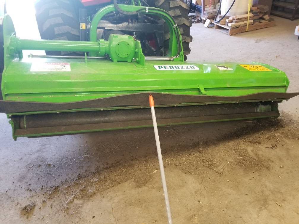

Anybody have any opinions on the value of a scraper on the roller? The one on my new Peruzzo has been a bit problematic.
At the start material was getting wedged between the angle iron scraper & the roller. The photo I took was after digging plant matter out from under the scraper. Then a few days later i found the scraper an inch or so from the roller instead of almost touching. Thought an adjustment something had loosened, but as I started looking, some stops on either end of the scraper had cracked. Recently I'm getting a ton of material packing pretty hard in on top of the roller under the rubber flap. I'm assuming the scraper is stopping material from flowing over the roller. Need to get a photo of that, but it was late & dark out tonight.
My old Ford 917 flail never had a scraper, at least as long as I owned it. The only issues I ever had was was when it was really muddy & I had no business mowing (think I was testing something).
Any reason I shouldn't just remove the scraper?

The scraper on my Caroni rode on top of the roller. It beat and banged with every bump it crossed making a racket which was driving me insane. I took it off and have had no problems at all although cow manure does stick to the roller but quickly wears off.

We never had scrapers on out mathews mowers and any build up fell off. The scraper is there primarily to clear fine clippings which can be as bad as super glue, no worries just set it aside and when you dedicate it to only fine sod mowing you will have it to use.
