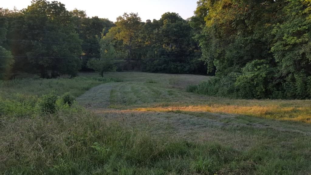

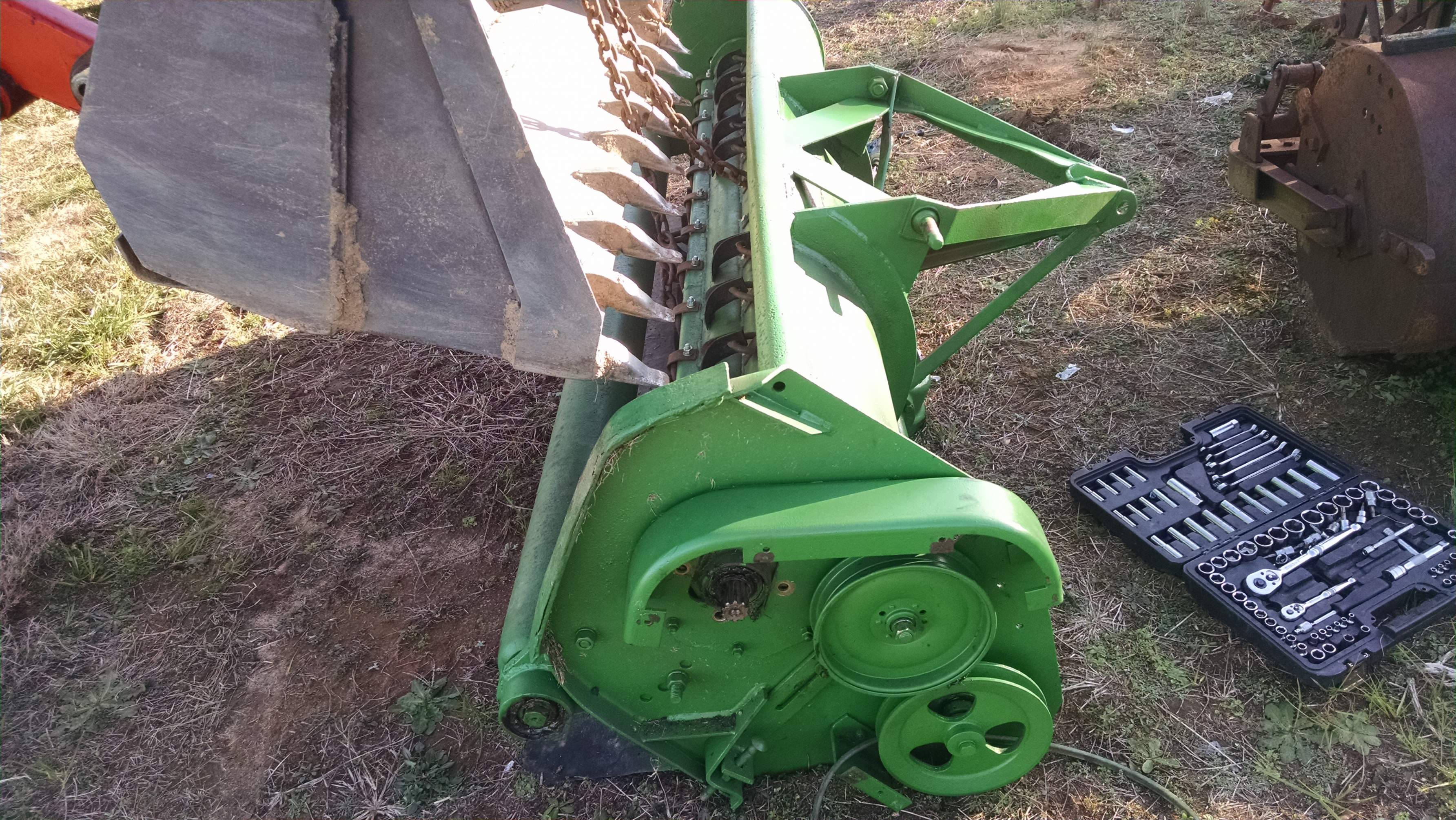

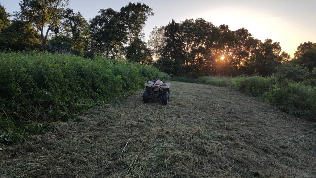

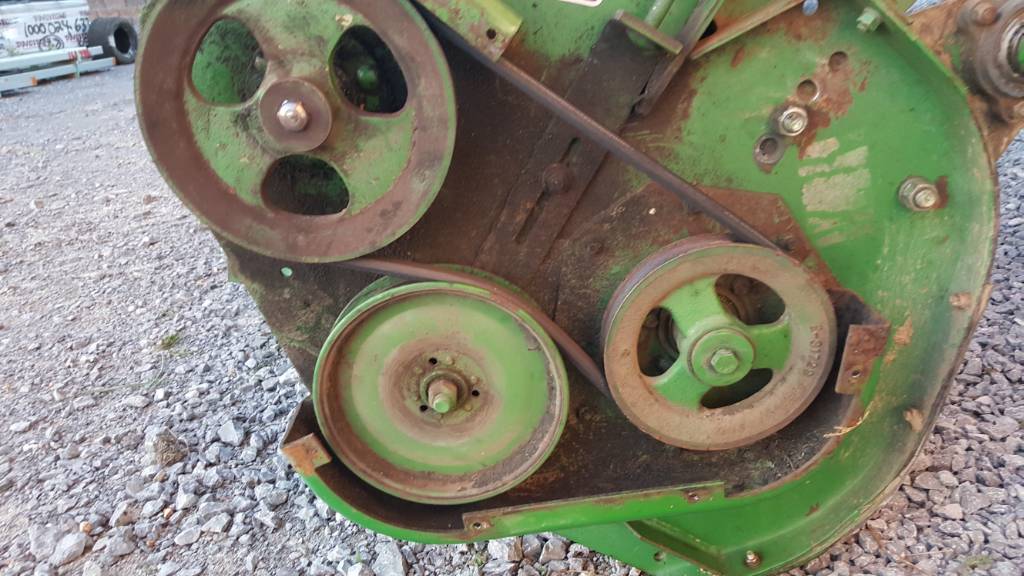

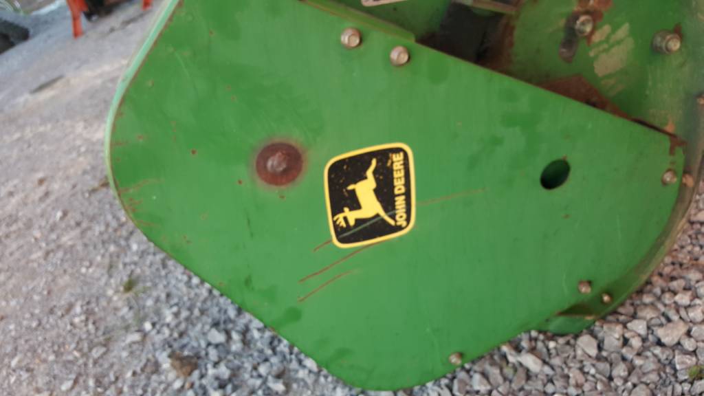

I picked up a used JD 25a flail to mow some over grown pastures on our TN hill farm. Farm was an estate sale and pastures were let go for a few years. Over grown with briars and scrub brush. Just finished going over the mower replacing scoop blades with a full set of side slicers from Flailmaster. My question is how to grease the rotor shaft bearings. I found the zerts for the roller and belt drive shaft, but can't find a way to grease the rotor shaft bearings. I pulled the guards from both ends of the rotor shaft and don't find any zerts or ports. Any suggestions how to grease the rotor bearings on a JD 25A?

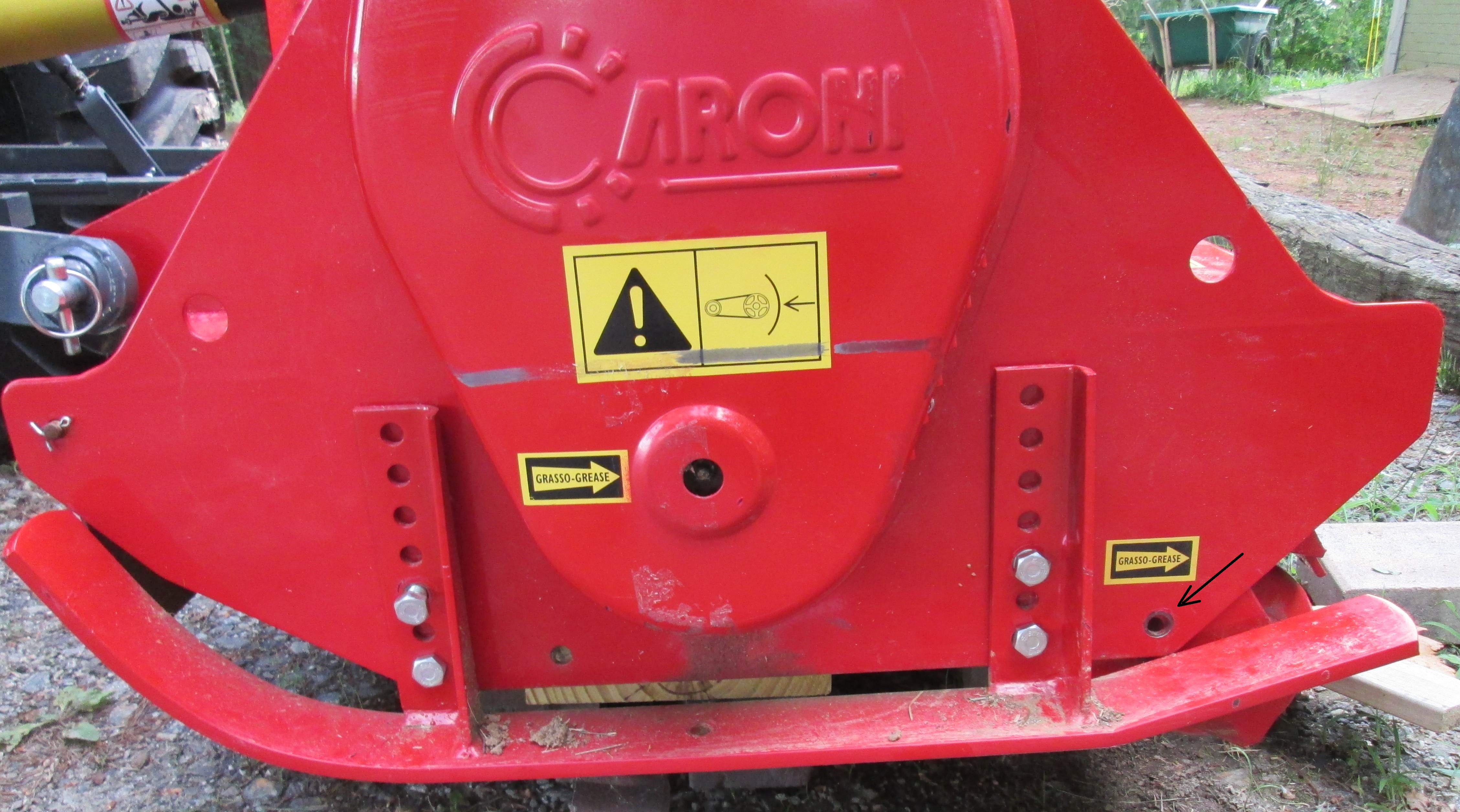

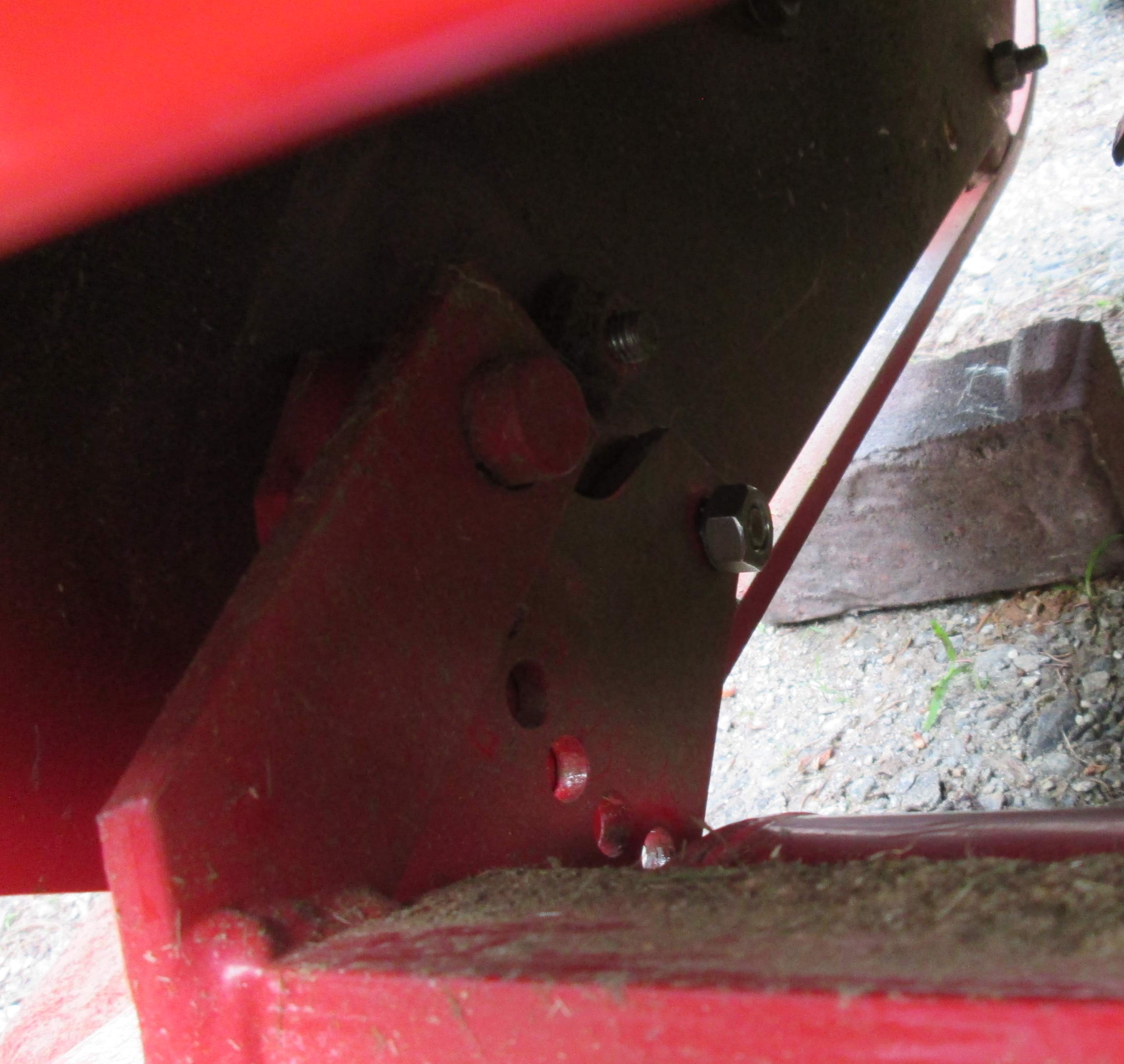

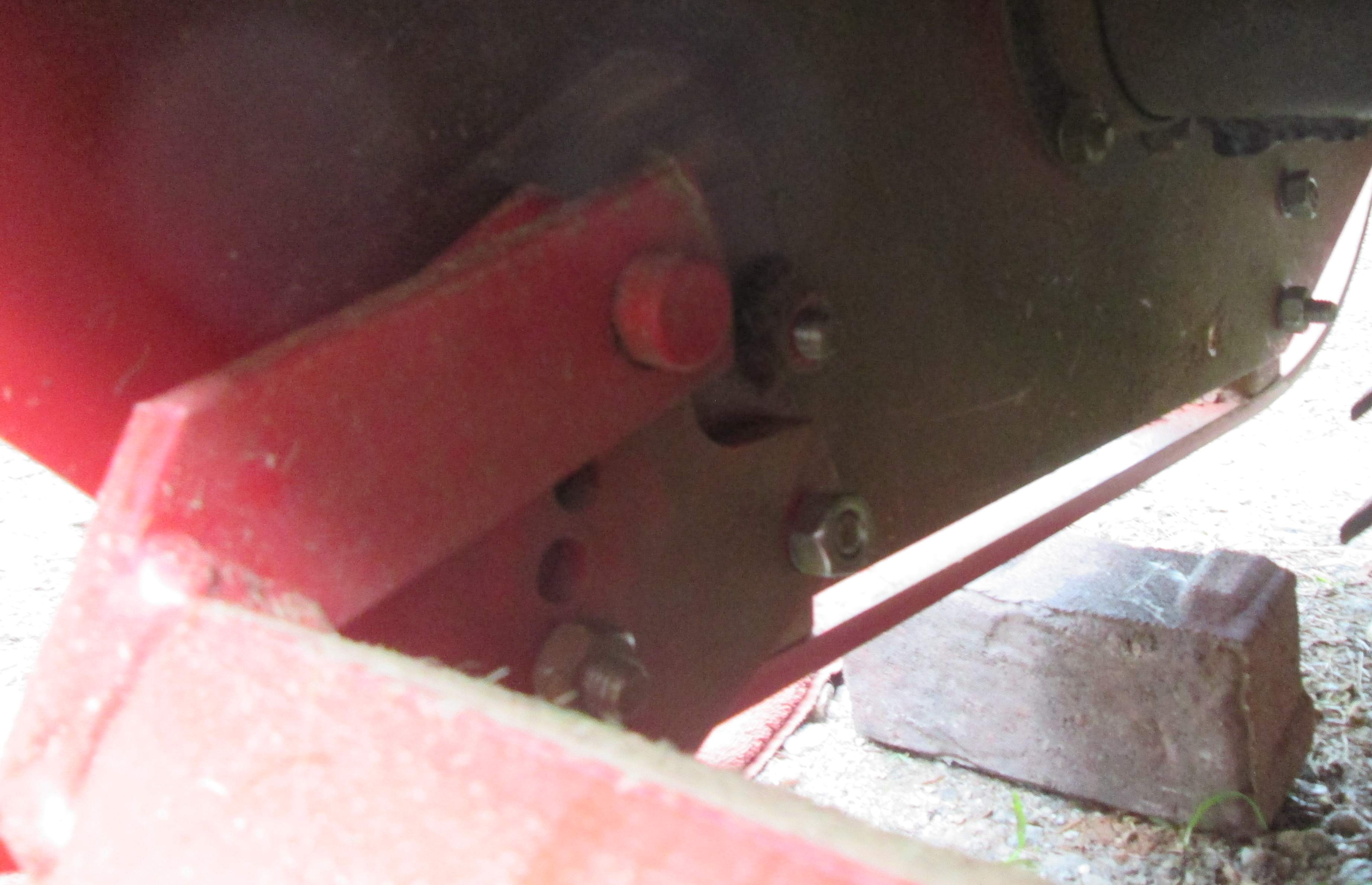

My current issue is setting the cutting height. What I've read here is to generally have the skids up high and put the roller where you want for cutting height. But the Caroni manual says to keep the skids and roller at the same height, and I can't see how to adjust the roller separate from the skids. There are two bolts on each side of the bracket for the guides and another bolt for the roller. If you remove one fo the two bolts to pivot the bracket down, then it doesn't look like you can get that bold back in. Can someone weigh in on this, please?
I believe I have figured out how to adjust cutting height on the Caroni TL1500, and hopefully this will benefit future users. My original thought (indicated in my previous post) was that I couldn’t adjust the roller separate from the skids. But it is possible. On the side of the mower are the skids, each attached via 4 bolts, as shown (I had already removed the bolt for the roller from the hole with the arrow).
Each support for the skid has 7 holes, where the two bolts are 2 holes apart. So there are 5 possible positions for the skid (#1 & #3, #2 & #4, etc.), and the mower comes with the skids attached at the highest point (bolts in the lowest holes). The bracket holding the roller uses the bottom skid bolt (roller side) as the pivot point on the roller bracket, which has a series of 5 holes in an arc to set the cutting height.
You can see the four bolts for the skid. So if you want to leave the skids in the highest position (as recommended by a number of people in this forum), then all you have to do is to loosen, but not remove, the pivot point bolt on the skid support. Then remove the roller bolt and reposition it to a higher hole. I put mine in the middle hole, which puts the roller about 3” below the skid.

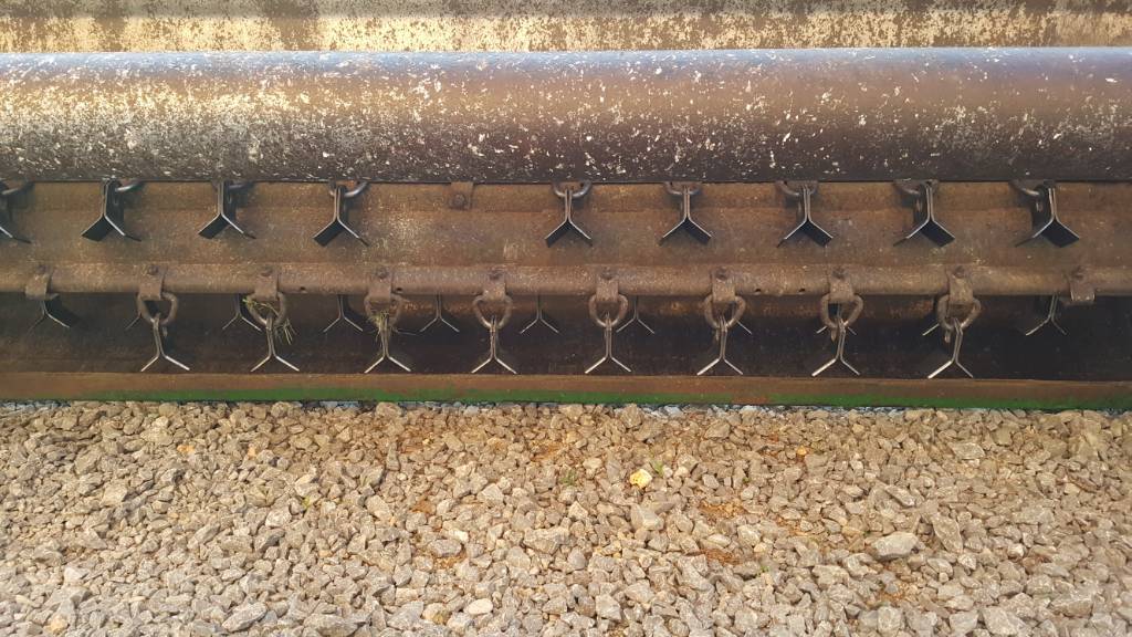

DID they sell you enough side slicer pairs to convert it to a finish flail mower? I do not remeber exactly but I think pops had 72 pairs of side slicers-24 on each of the three mounting plates that were also fixed air paddles.
Have you purchased enough side slicer pairs and the required number of knife hanging straps, nuts and bolts and D rings to correctly mount the side slicers? on each of the three mounting rows?
You will have unwanted grass strips if they did not sell you the required number of replacement knife sets, mounting straps, nuts and bolts and hangers.
You have the same flail mower my father owned. have you dug away all the grass and rubber dust from under the V belt guard housing?????????????????????????????????????????????????????????????????????????????????????????
The flail mower rotor bearings should have easily accessed grease fittings on on the exterior flange bearing housings on the exterior of the flail mowers side weldment's(side plates) , they are probably buried with grass dust and not easily visible on the bearing housings.
You will need to dig around the bearing flanges castings to find the grease fittings with a small jewelers screw driver or an O ring pick to find them.
I certainly hope that the previous owner did not install the bearing flanges with the grease fittings on the interior of the flail mower if the bearings were replaced previously.
I also hope that they did not purchase sealed bearings if they replaced them.
Please do not pump more than 4 pumps of grease in each flail mower rotor bearing before your first mowing and only 4 pumps of grease after the first mowing.

You can lower the skids to the roller height and have plenty of good mowing and prevent the mower from scalping and nose diving
if you want to mow higher.
The newest Caroni flail mower design lets you mow with the three point hitch in the float position with the mower skids on the ground as the new skids and rear roller mounting have been constructed to prevent them from digging into the ground.
You will have to mow with it to see if you are happy with the mowing job in that position to decide.

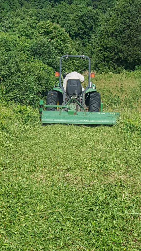

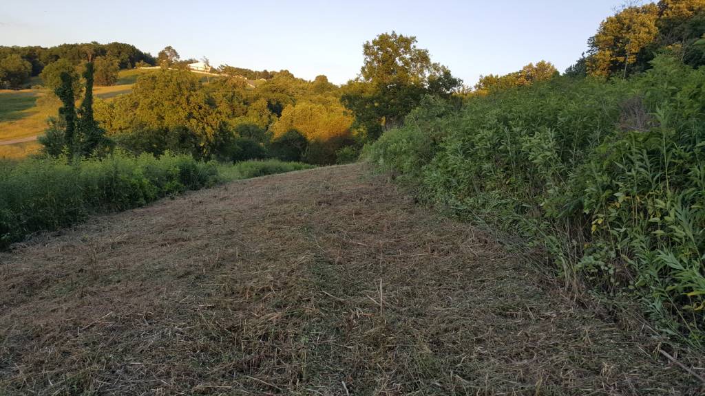

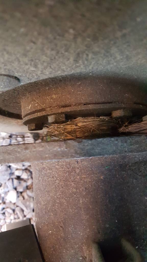

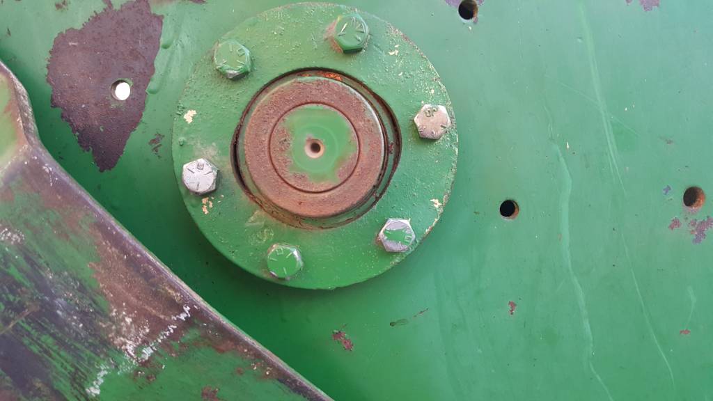

Thank you LEONZ. There are 36 hangers, 72 blades. I replaced all 36 scoop blades with 72 side slicers. I test ran it today. I love this thing!!!!. I cut an overgrown pasture beside where my wife cut yesterday with a 5' rotary cutter. There is no comparison. Clean cut with no wind rows! Ì then cut a few passes on the heavily overgrown side hill. This hillside is covered with 5' tall briars and scrub. Cut it clean on the 2" setting. I did have to occassionally slow the tractor when the RPMs started to drop in the really heavy stuff. Did I mention it is attached to a JD 4300HST with 12.4 R1 tires filled with Rimguard. I mow the fields with the 430 FEL attached.
Now for the down side. I didn't replace the hangers and D-rings for my trial. Wound up loosing 5 D-rings (10 blades). A full set of new D-rings and hangers already ordered. I definitely do not have any grease fittings on the bearing housings that i can find. I dont see how the housings could be installed backwards. Also, the drive shaft keeps walking out. It was contacting the safety cover when I bought it, and I reset it to the correct location and secured the lock ring. It walked back out with about 4 hours running. Photos of my mowing and mower below.20180603_193443.jpeg20180603_193225.jpeg20180603_194424.jpeg20180603_194147.jpeg20180603_193447.jpeg20180603_194437.jpeg20180603_193912.jpeg20180603_194258.jpeg20180603_194513.jpeg20180603_085800.jpeg
/ Let's talk flail mowers #5,119

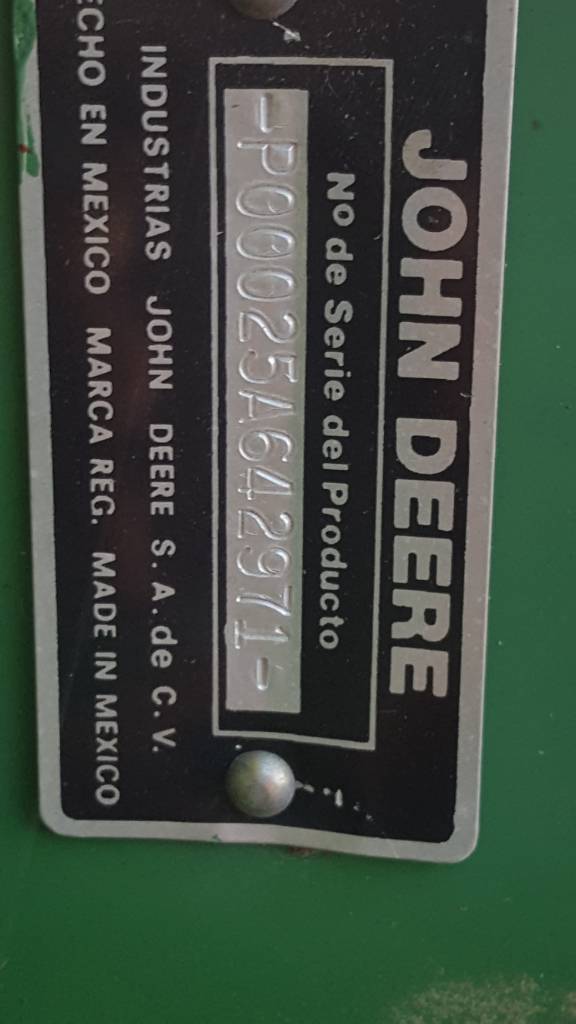

Hello Mr. Thibodeau89,
If at all possible and if the identification tag is still intact you need to visit a JD dealer and see about purchasing a replacement operators and owners manual as well as a parts list.

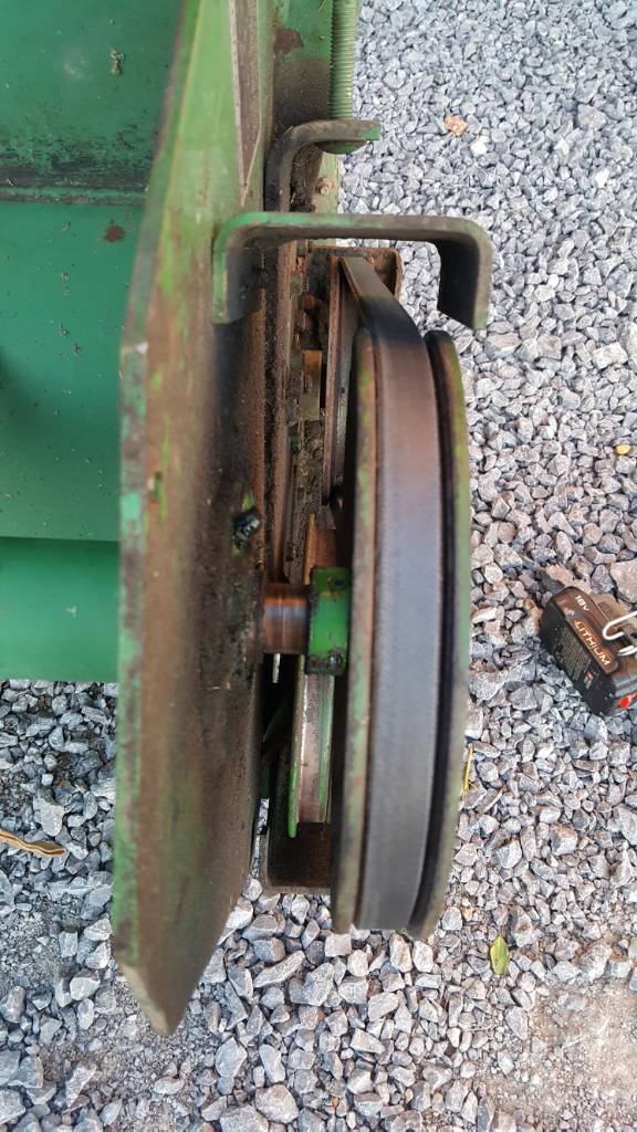

About the moving flail mower rotor shaft; both set screws are going to be removed and a small dimple drilled in the shafts to assure the shaft does not walk anymore.
I believe that JD did make a flail mower with sealed bearings at one time and that was a bad idea for many reasons.
Please keep us in the loop with your progress with it as you need a bit more work to do and you will have a forever mower.
Leon
Happy mowing
/ Let's talk flail mowers #5,120

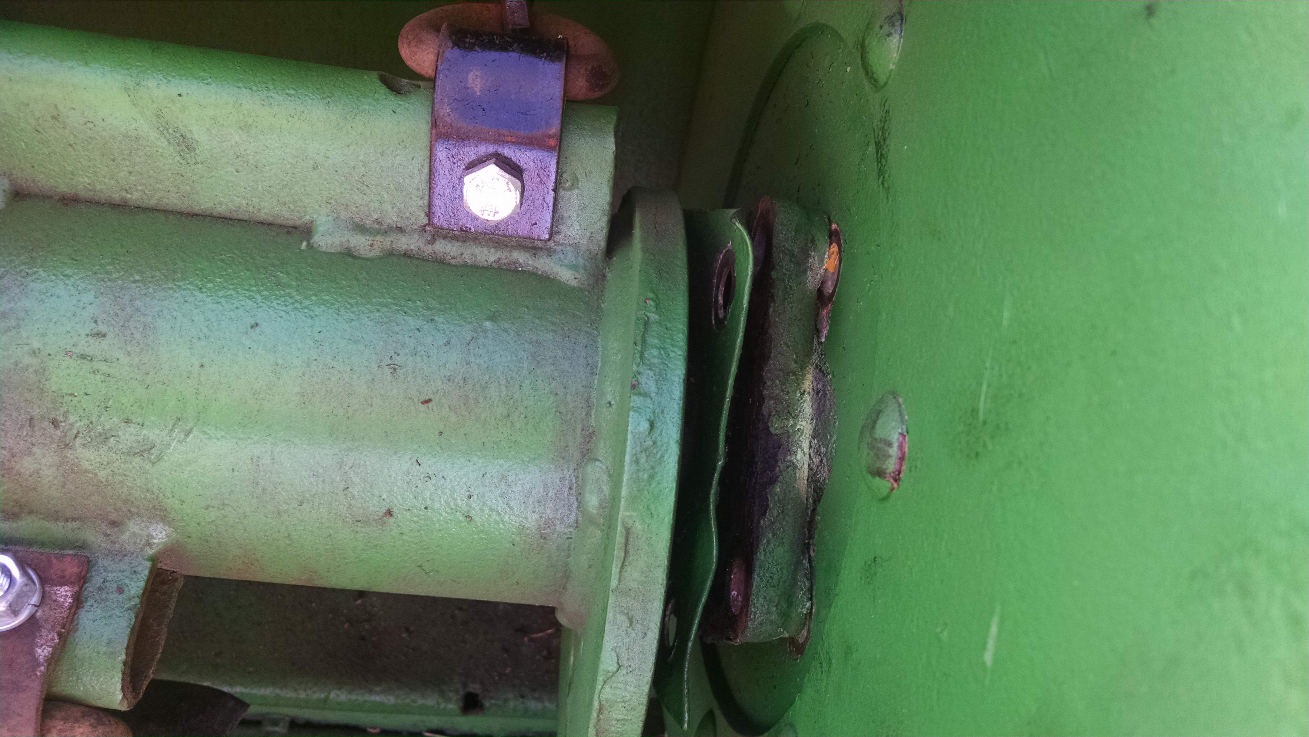

S/N tag is preseng and legible. I already picked up the operator manual. The drve shaft bearing is a cam lock type with a single set screw on the collar. The set screw is tight to the shaft. The collar came loose from the cam on the bearing. Perhaps I secured the cam in the wrong direction. Will resecure so that the forward rotation tightens it. I didnt think that the bearing drag would be enough to loosen the cam. May just need a new bearing.
Will pick up new hangers today from Flailmaster. I work a few miles from thier shop.20180603_194208.jpeg
