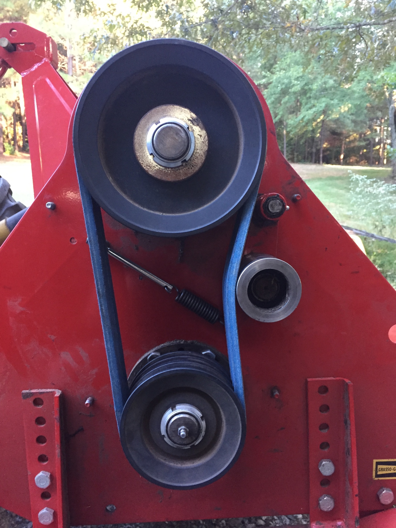

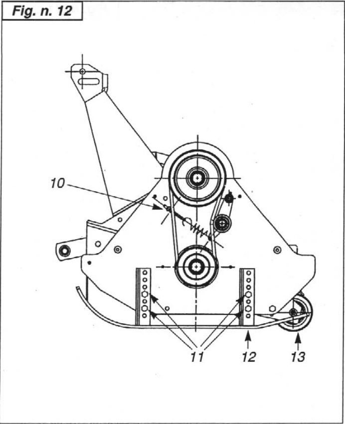

Yes, the original belts are 46" OD

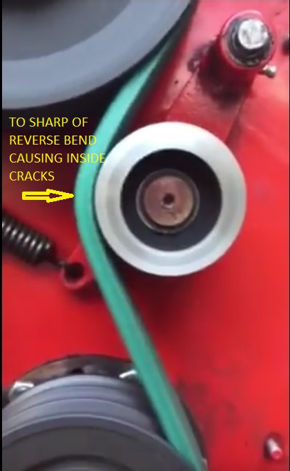

After seeing your mower this morning with the 45" belt decided to do some checking after work tonight. I thought it looked to me like the engineers originally intended to have the 45" or metric equivalent on it and not the 46". Went to Agri-supply website, found PDF of the manual to see if I could find a picture of the belt setup in the manual. I would say the 45" is the winner. :)

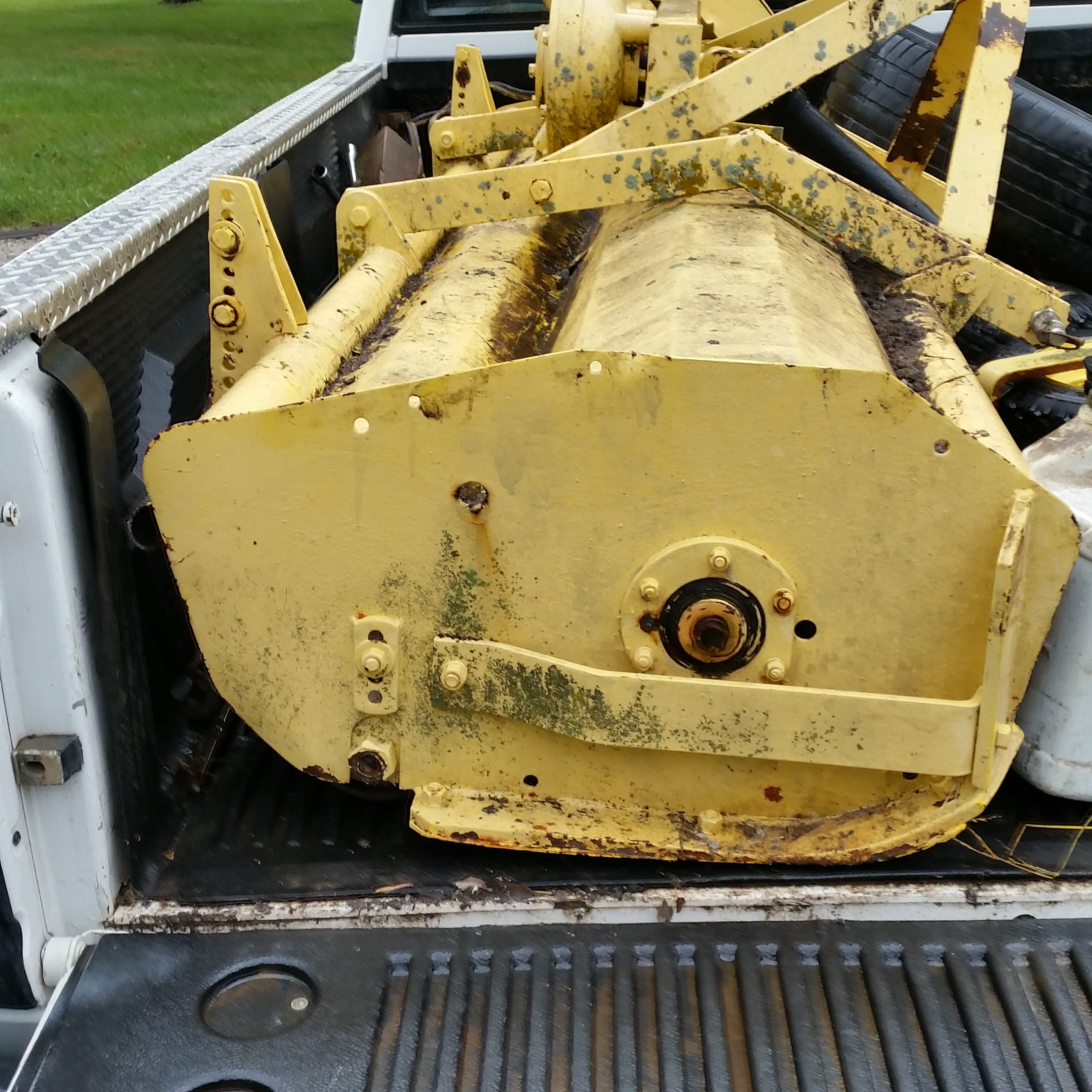

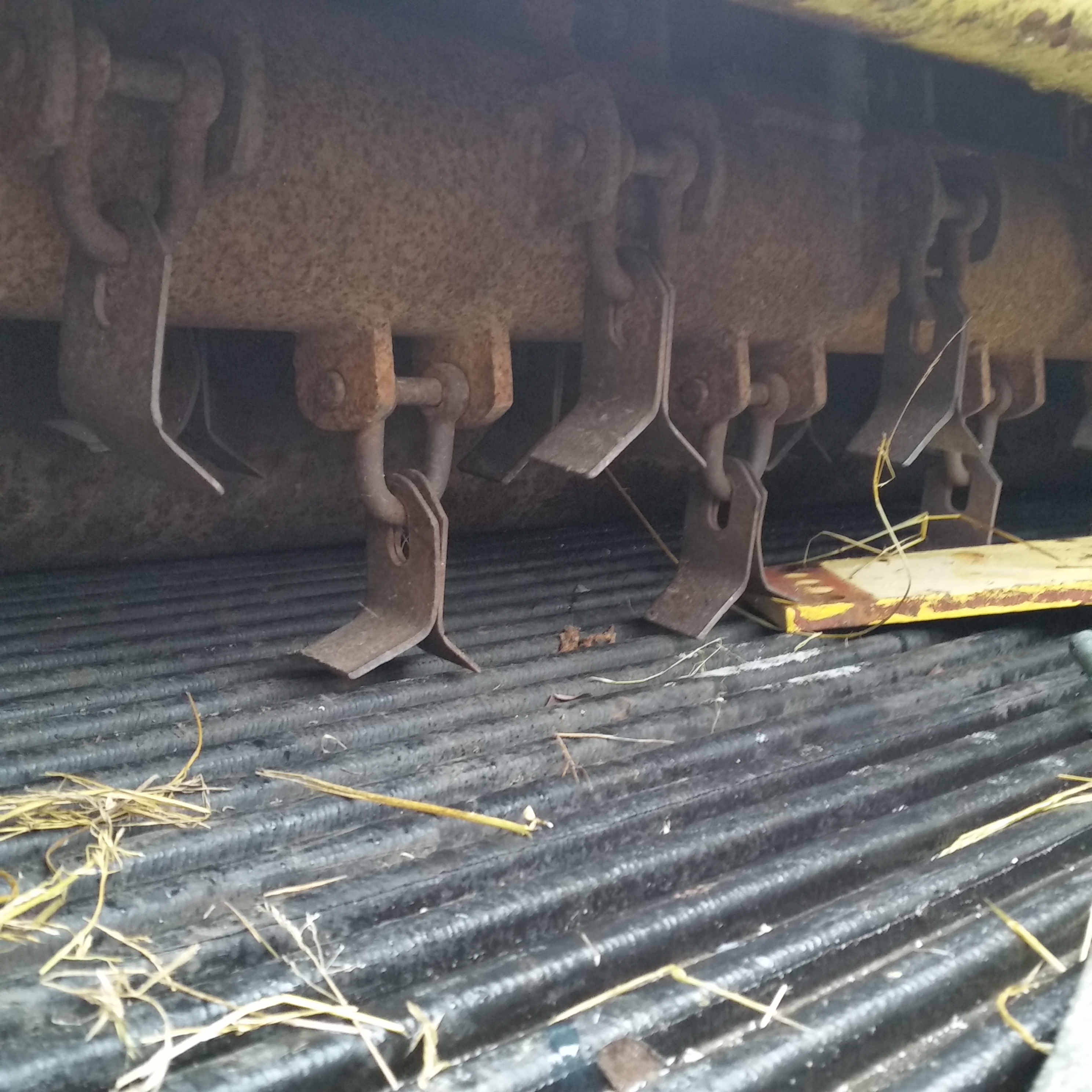

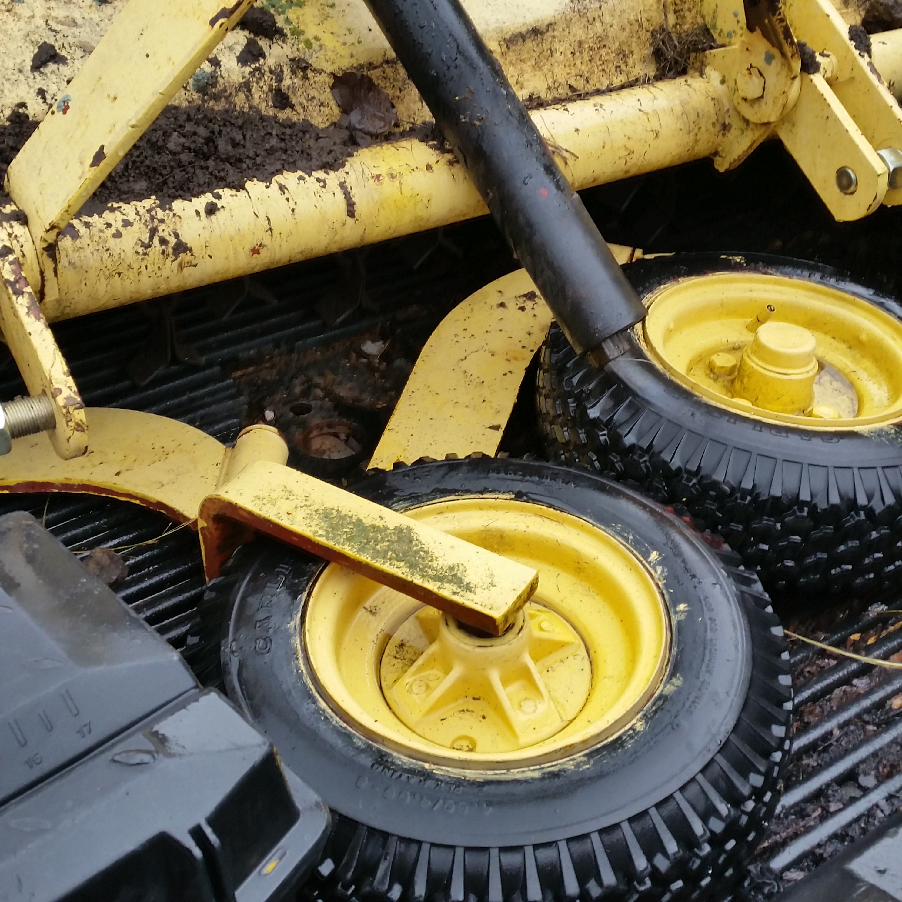

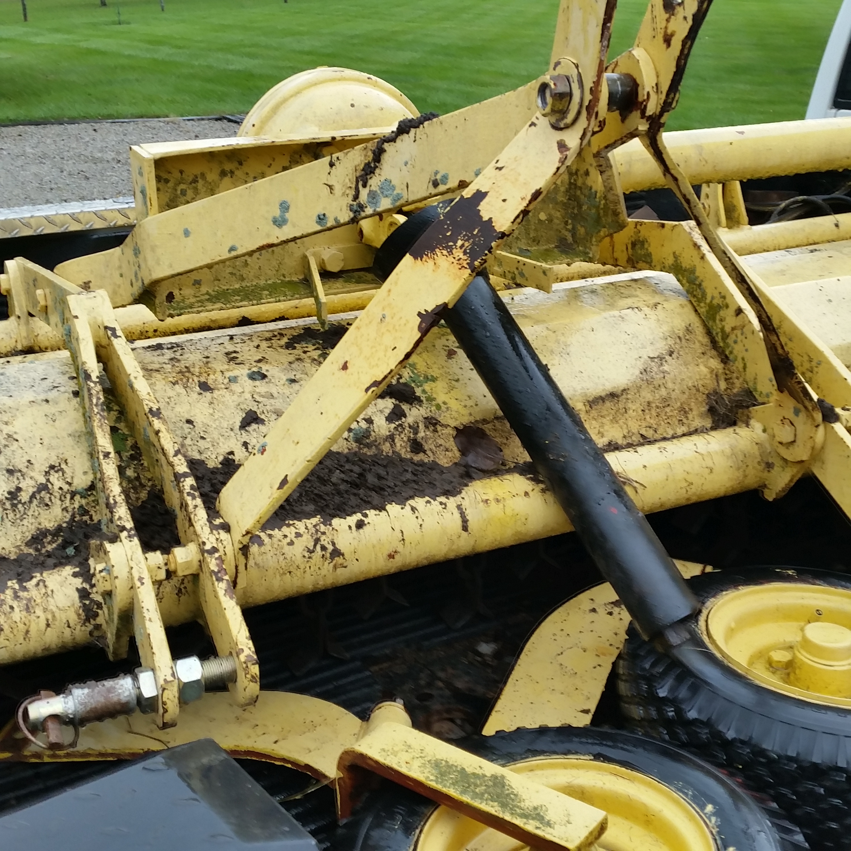

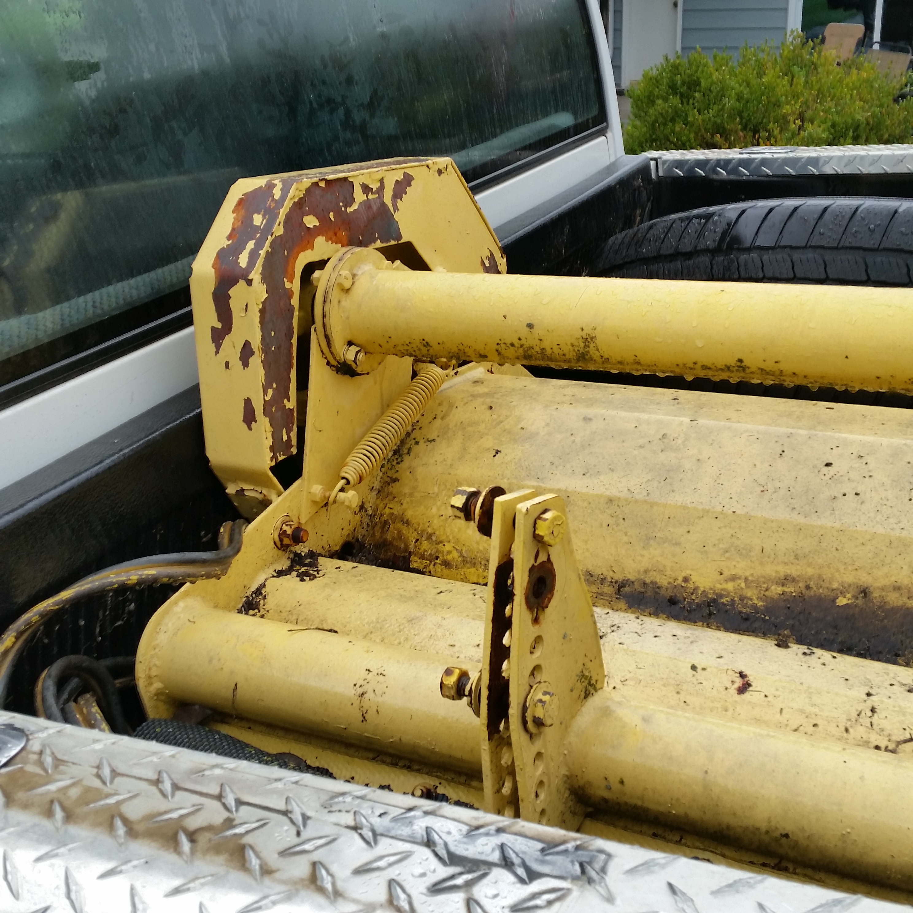

Have this flail mower with no identification. Does anyone recognize the manufacturer? Or tell me where to scrape to look for a tag. 7 12' flail 017.jpgIt just fits in the back of my truck, so it's 8' long. Was a Corp of Engr. piece of equipment at one time.
I changed out the gearbox oil, and greased the fittings I could get to. Was going to take it to the farm and put the trail wheels back on and give it a spin, but the rains came. Tomorrow, maybe.7 12' flail 018.jpg7 12' flail 021.jpg7 12' flail 019.jpg7 12' flail 020.jpg
View attachment 523753View attachment 523752View attachment 523751
Thanks for the info. The 45 belts sure do not have as much back flexing as the 46 belts. Too much flexing around the idler pulley might be what is causing the belts to crack and fail.
Hopefully I can put the 45 belts to the test and see how they will hold up compared to the 46.

I want to welcome you as the newest Member of the Flail Mower Nations from Kan.? Mo? please clarify this part.
You have an "original" Mott Interstater finish mower with side slicer knives and gauge wheels to prevent scalping. Put the caster wheels on, grease the stub shafts for caster wheels, Take the V belt cover off and clean off all the grease and rubber dust to expose any buried grease fittings.
If the V belts are the least bit frayed they need to be changed and the Kevlar V belts are the best for shock loading.
Parts are still available and generic as all V belts and bearings are metric and you can purchase them locally if desired or from Flail Master so no worries there, the side slicer knives and knife hangers are common parts and available.

That's an Alamo/Mott . It came in 74", 88', and 96". One of the better built flail's around.
