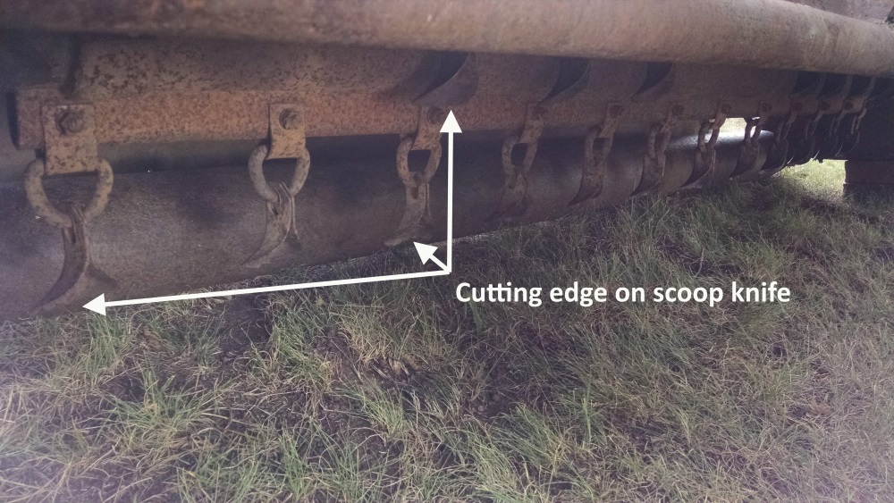

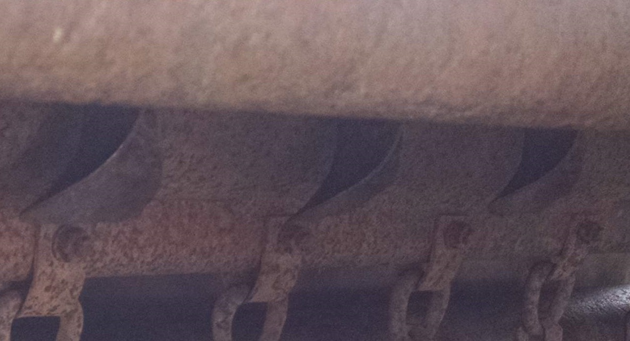

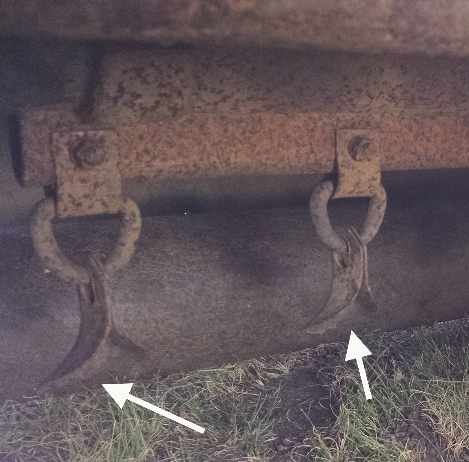

Thanks to everyone that helped with my adjustment of the flail mower. I am now very pleased with the cut.
Managed to do a number of acres of severely overgrown land and the alamo handled it like a champ.
