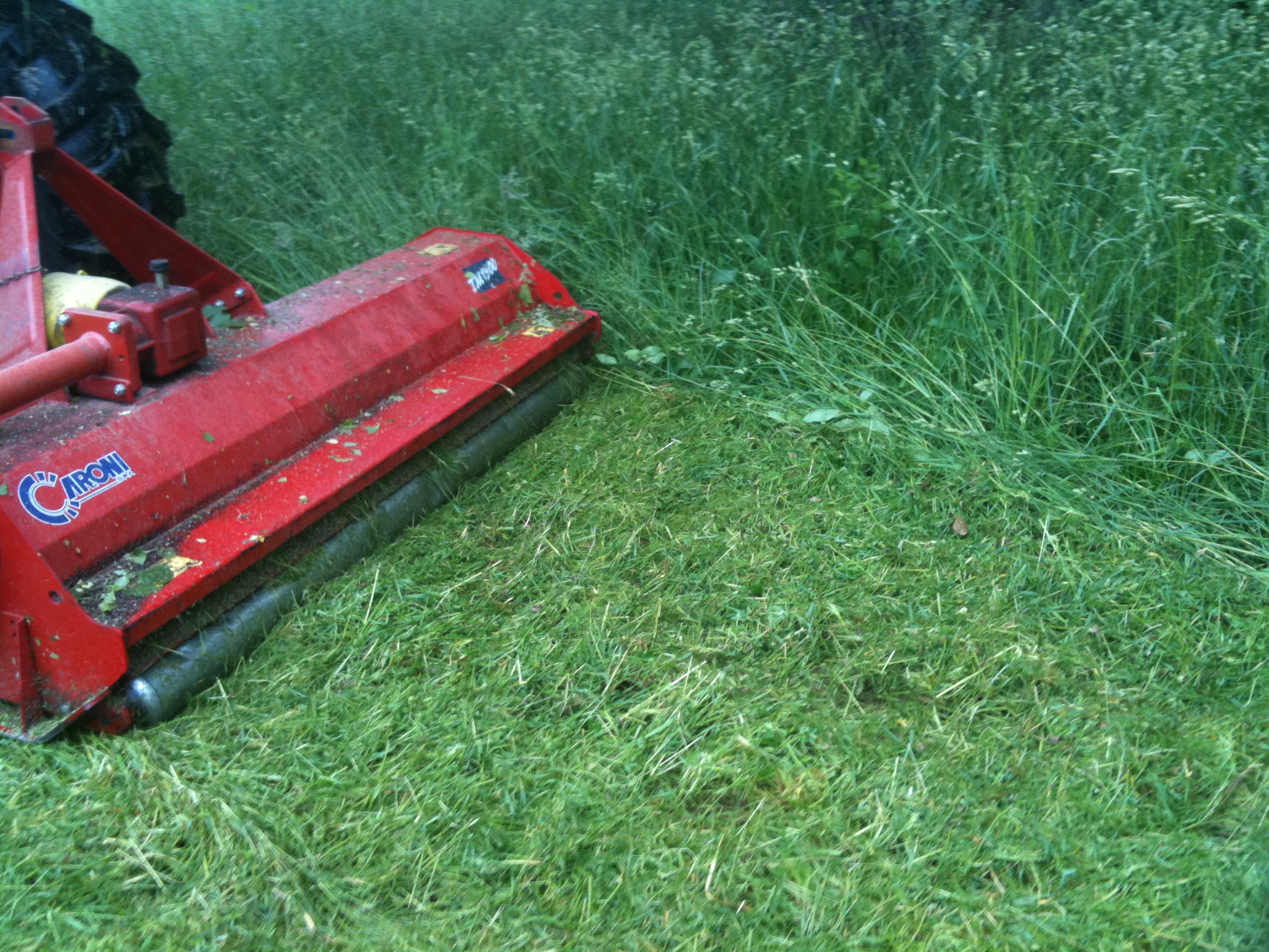

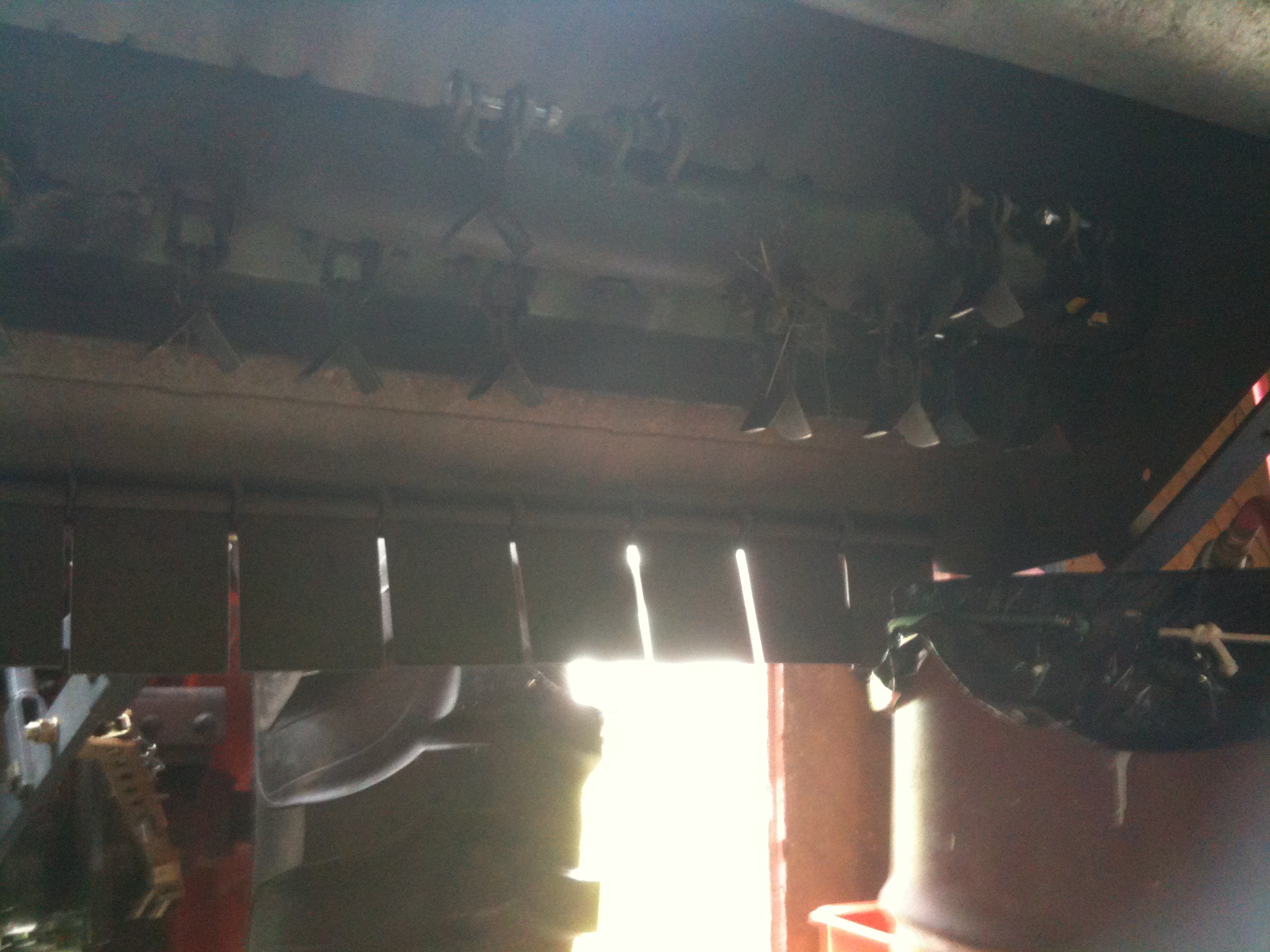

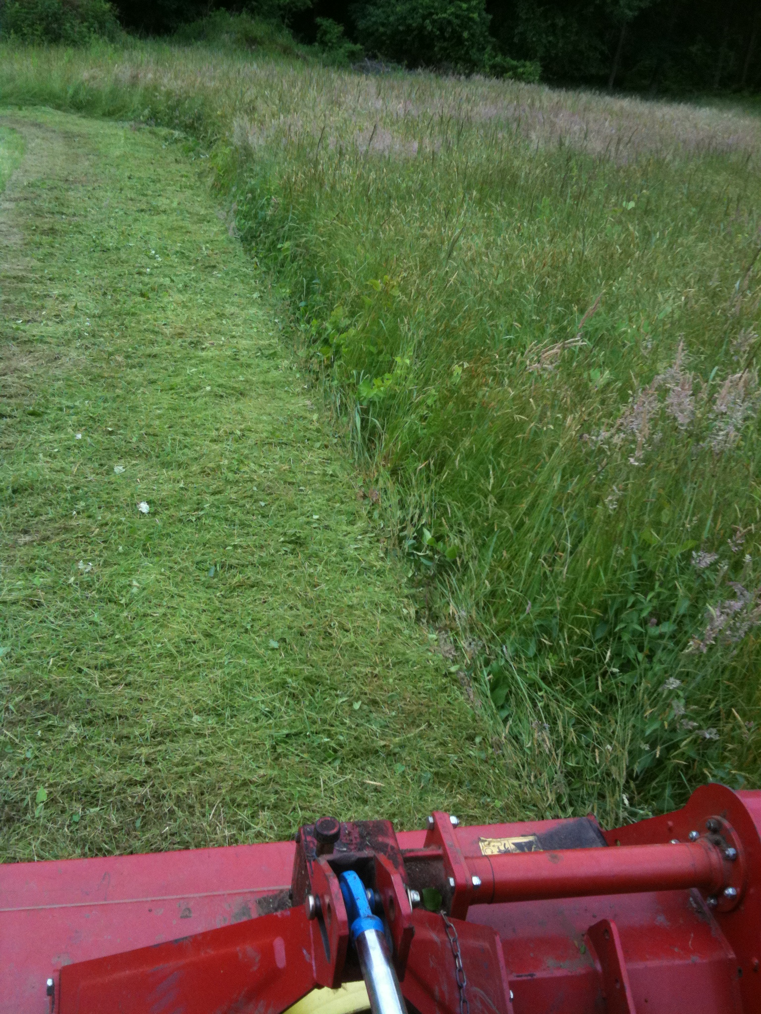

Slight correction to Leonz's description. I'm not with my mower now but have spent enough time replacing knives and clevises lost due to rocky conditions in New England to say that there are four, not two, rows of knives. I believe there are seven stations on each row and each station holds one clevis and two knives. Total of 28 stations and 56 knives. The adjacent rows are offset slightly to provide full width coverage. I think the rows at 1 and 180 are identical except for offset as are the 90 and 270 but I don't have access to the mower right now to check. I've attached a few (bad) photos so you can see the basic set up. And, yet, that is a piece of firewood jammed in the rotor on the second photo (no harm done). The mower works well in "hay" and also in light to medium brush up to and inch or inch and a half. It will cut more than that but requires slowing down.
