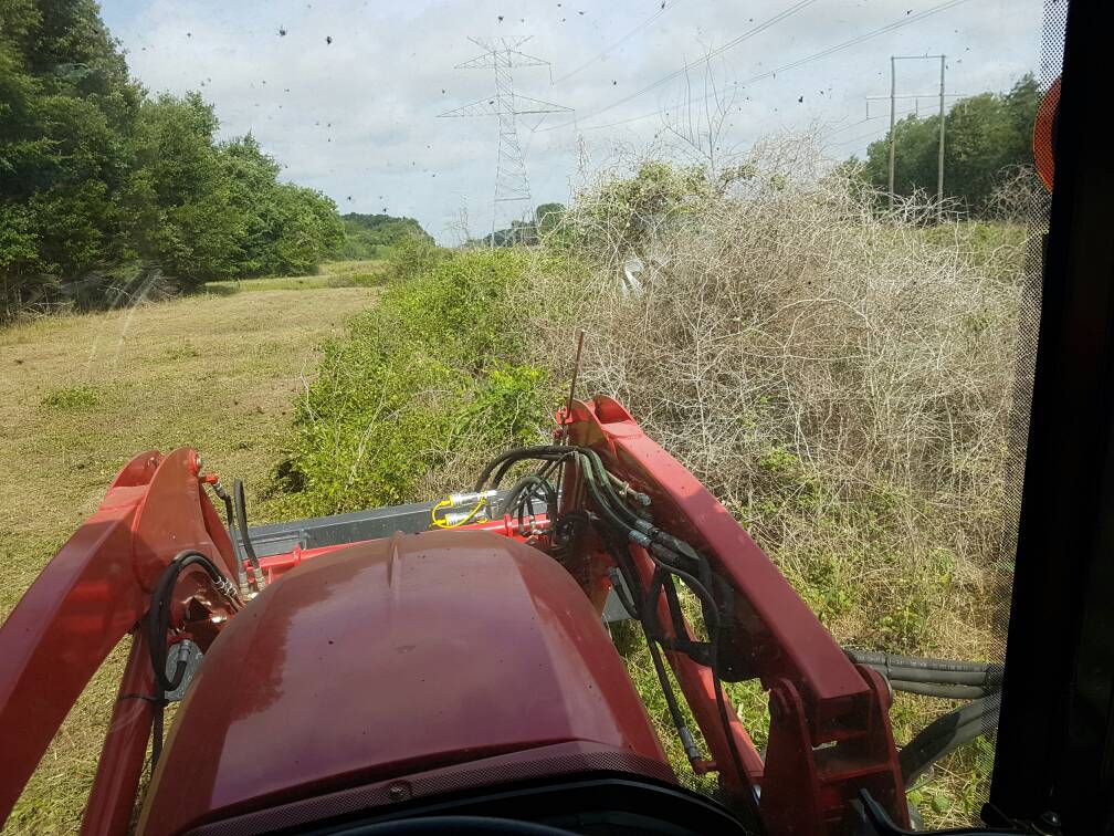

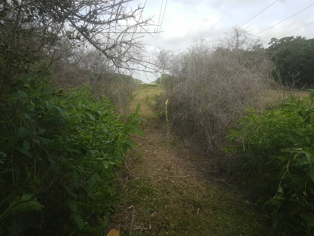

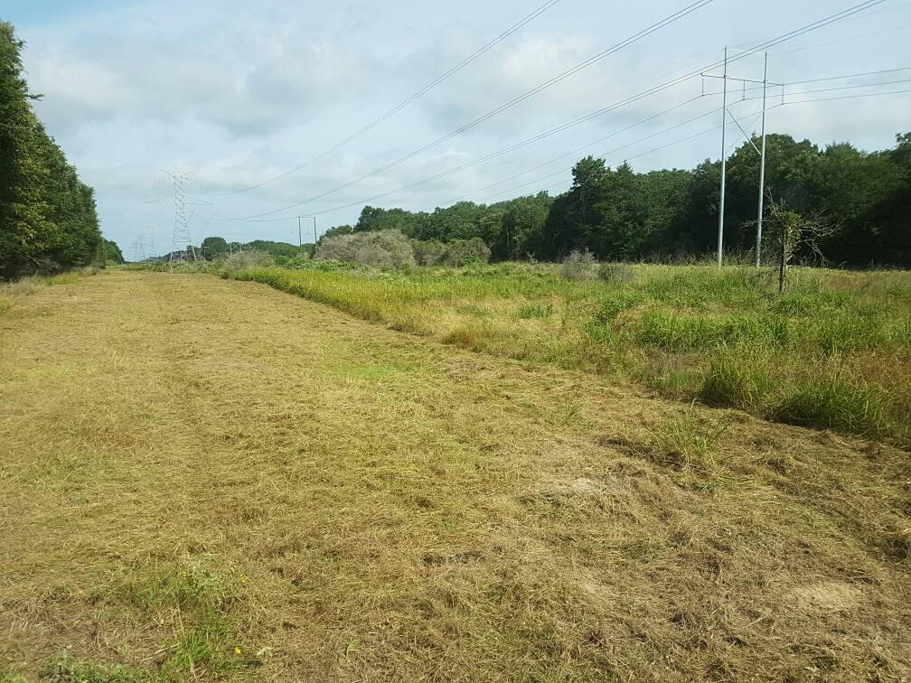

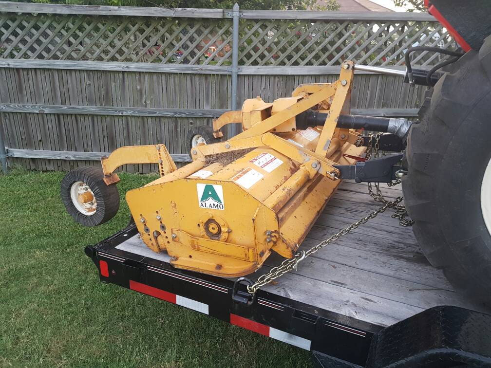

Thanks to everyone that helped with my adjustment of the flail mower. I am now very pleased with the cut.
Managed to do a number of acres of severely overgrown land and the alamo handled it like a champ.
Went over and through some things I probably shouldn't have and had no issues.
View attachment 512745View attachment 512746View attachment 512747View attachment 512748View attachment 512749

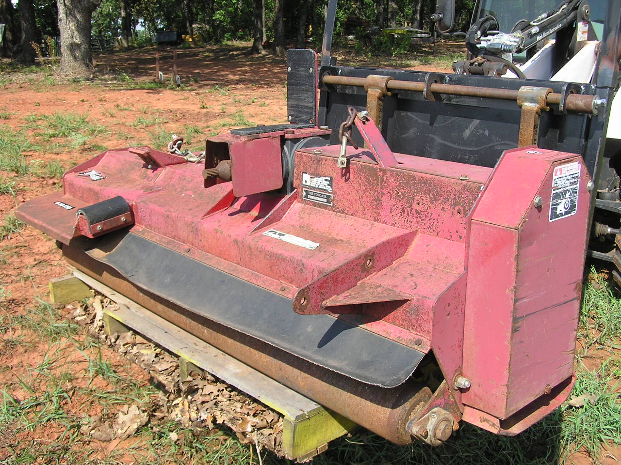

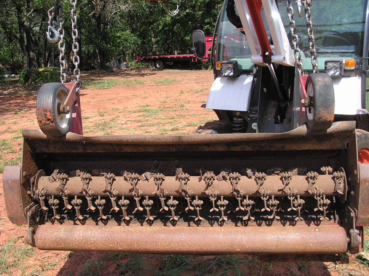

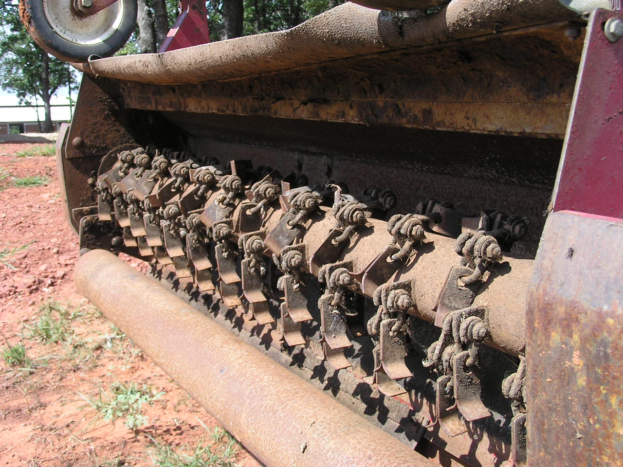

IT- What kind of knives are on your flail? Hammers?
No. Caroni type B blades. I think of them as side slicers and they are mounted in pairs on a clevis. Caroni calls them "rough cut" blades. Same basically as used on Alamo and other flail mowers.

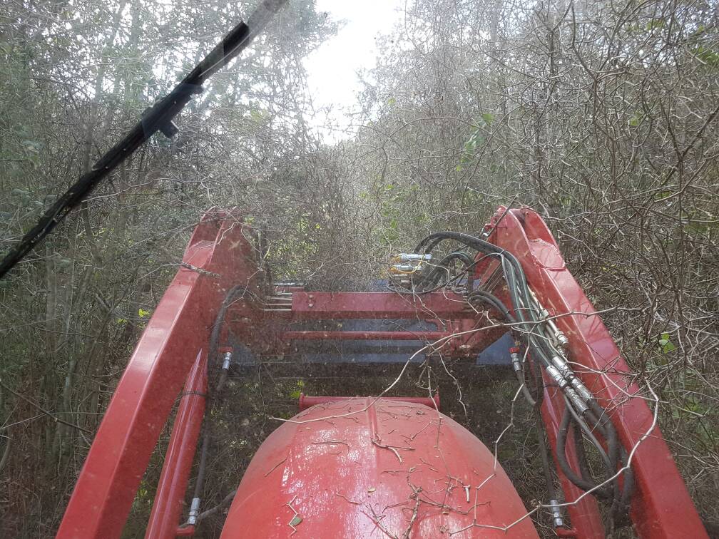

Most flails will do that. Here is a Caroni TM1900 pass through similar brush.
My 30 year old Ford 917 flail would struggle but probably pull that off as well. At least as long as that brush wasn't to tough. It has the knives instead of hammers as well. My next flail will have hammers instead of knives. Of course my next flail will cost a lot more than $100 too, so I can't complain to hard about my tired iron that keeps on mowing.
Gotcha, I just wanted to make sure it was an apples to apples comparison for Ribz, who has scoop knives. Close enough to call it a direct comparison in my opinion.
Ps- not sure if you noticed, but there's a rather large block of wood wedged into your flail rotor ;)
Haha, sorry, couldn't resist!
Block of wood?? You're kidding right? That might explain a few things....
Actually when looking for a photo that showed the knives that was the one that popped up first. I selected it based on a thumbnail and didn't see the block until I posted. Still, it is a good example of how a flail can tolerate hitting junk without damage. I was mowing in thick grass and "captured" a firewood log which promptly stalled the tractor. I took a photo and then removed it by twisting the rotor backwards with the persuader du jour (crowbar as I recall).

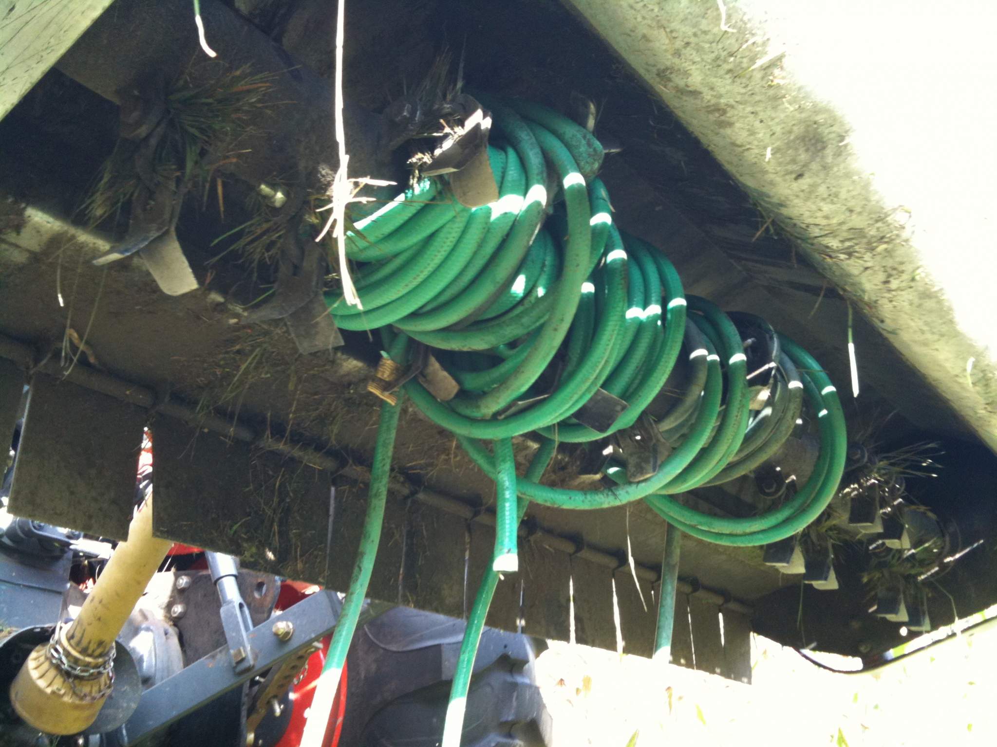

This next photo shows a situation that was a bigger pain to deal with and required ten minutes of snipping the hose apart with pliers to resolve in the field. I now carry better snippers in the tool box to deal with such intruders.

Glad I am not the only one who has hit stuff so bad I stalled the tractor. :laughing:
Worst episode was catching a string of barbed wire and wrapping it up! That took a while to cut off. Wish I had grabbed a pic!
/ Let's talk flail mowers #4,570
Thats OK PCRWI,
You should see all the scars I have from garden hose snakes biting back at me!!

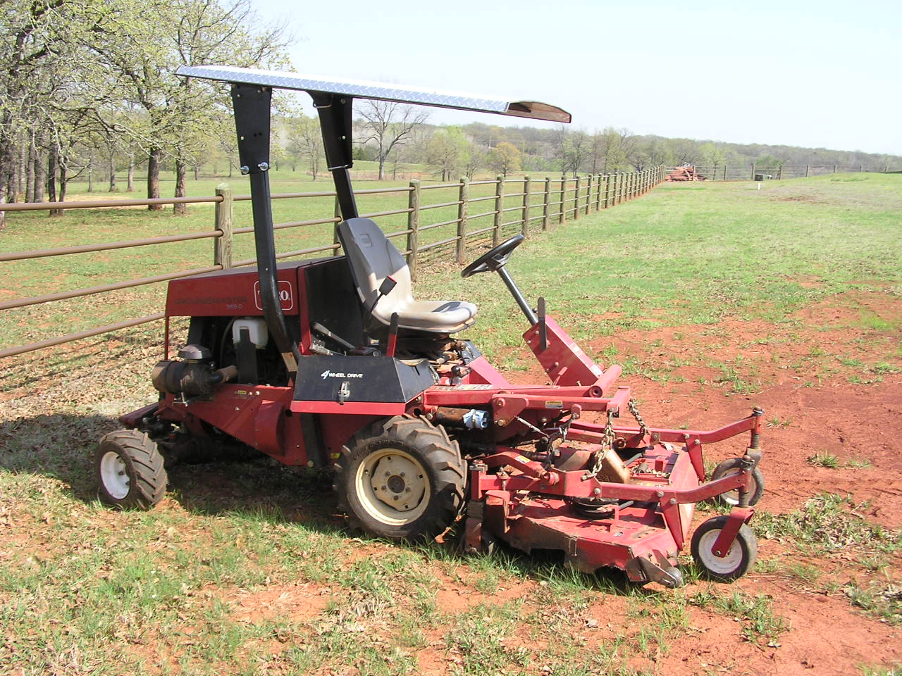

I've hit stuff worse than garden hose and firewood. I ran into an unmarked junk car dump at the end of a field and wrapped Lord knows what pieces of sheet metal around the rotor. No damage but I wasn't equipped to remove it in the field.

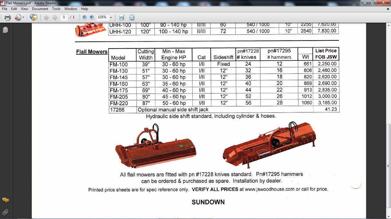

Welcome Shawn. I don't know the Sundown brand but they seem like beefy mowers. Not so sure you really need that heavy duty type though. If it were my choice I'd get a quote on the Caroni TL1500 (or better yet TM1500 if they carry it) from Agrisupply. I suspect it will save you quite a bit of cash even with shipping. I wouldn't hesitate to use the Caroni for the tasks you outlined. The equivalent Woodmaxx is probably cheaper too.
Whichever you choose, I agree with your assessment that a flail would be great for your uses.
/ Let's talk flail mowers #4,574
I think it's the same as this: https://www.shaktimanagro.com/flail-mower/
Its chinese. The prices you're being quoted are in line with the typical EFGC (see betstco for example).
The design is a little different. Looks like there's an actual tensioner for the belts instead of adjusting the top shaft. Some SFMs seem to have rear doors, not sure all have them.
The HP ratings are suspect as they're identical for models of different width.
It's too bad the side shift is only 11.8" in all sizes.

NOPE, NOPE, MOPE!!!!!!!!!!!!!!!!!!!!!!!!!!!!!!!!!!!!!!!!!!!!!!!!!!!!!!!!!!!!!!!!!!!!!!!!!!!!!!!!
Your mule is too light even with the loaded rears for anything more than a 4 foot wide flail mower
your safer with either a four foot Caroni or Vrisimo orchard and vineyard flail mower and no wider !!!!!!.
You can purchase a Caroni 4 foot flail mower from Agrisupply and if you want I can contact Rodney
Barbour who is the manager of their imported equipment lines to call you with a price for one as
well as spare parts-knives, hangers, etc. IF you call Agrisupply ask for Mr. Barbour and tell Rodney
I sent you to him for a 4 foot flail mower.
Or you can purchase a 4 foot cut Vrisimo orchard and vineyard flail mower and have it shipped directly to you from California where they make them. You could also purchase a Maschio Flail Mower from Iowa Farm Equipment.
The second smallest Maschio flail mower model being the Birba 115 with the 45 inch cut would be more than adequate for your mule and its horsepower and they also ship the mower to you.
If your dealer cannot provide you with any more information on this chinese flail mower walk away
you do not want it, do not buy it!!!!!!!!!!!!!!!!!
The Maschios group has been making farm machinery in Italy just like the Caronis family but they build
flail mowers for orchard and vineyards in their product line with hammer knives which will handle your
mowing with zero issues.
