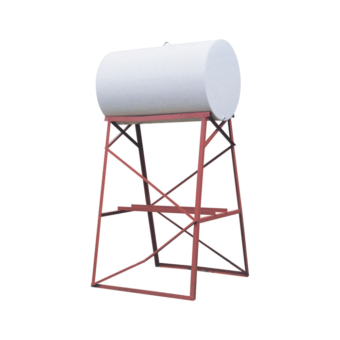

I think a lot of you are over-worrying about storing gasoline and water. While it is a real problem, it can be virtually eliminated by rotating your stock and using a filter/water separator.
Anyone remember these?
