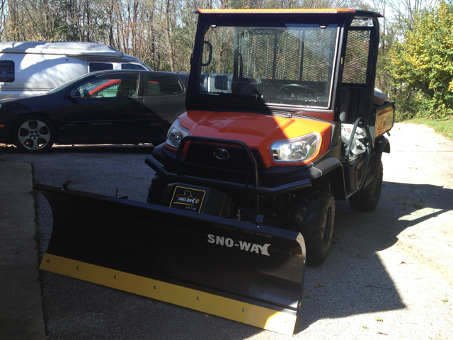

So after several years of digging out 1/4 mile of driveway with a 30" blade on my little old Cub Cadet 1864, we finally decided this year to step up to something more substantial.
I figure that this will either mean it won't snow at all this year (you're welcome) or it'll be a lot more fun when it does...

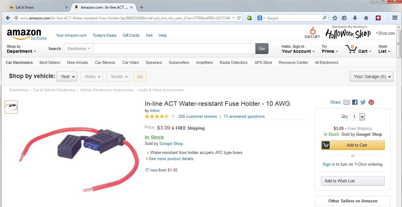

So I did the install myself. Overall, it went pretty well, though I think there were a couple of instructions missing from the supplied docs. One thing that I'm a little curious about is possibly fusing the power leads to the plow. The supplied lead is nicely done, but there's no fuse or breaker in it, so I now have two relatively heavy gauge wires tied directly to the battery. A short would get exciting, real quickly.
Is there a reasonable fuse for the hydraulic pumps on a plow like this? I know that their current draw will depend on temperature and such, but I have to think that anything is better than nothing, as long as it doesn't result in nuisance trips.
/ Let it Snow #6
Are you sure there isn't a fuse built in? I can't imagine anyone building a plow system that doesn't have a fuse and a contactor relay

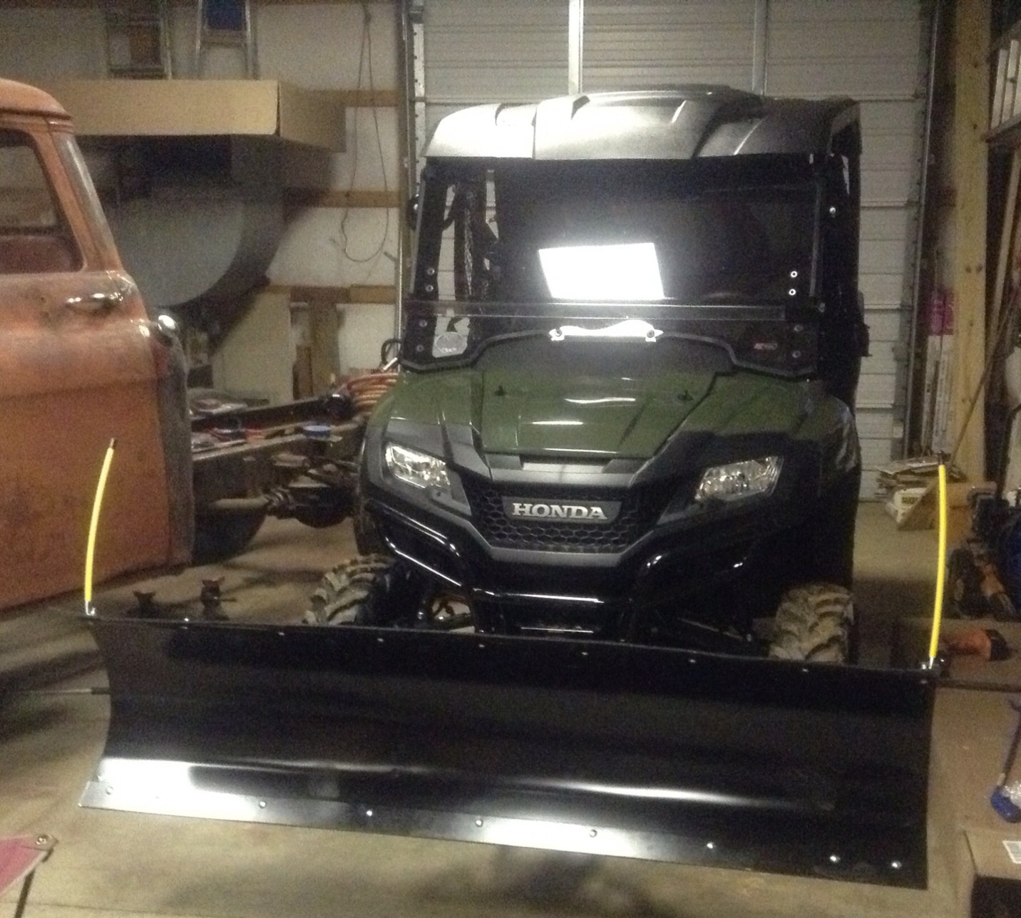

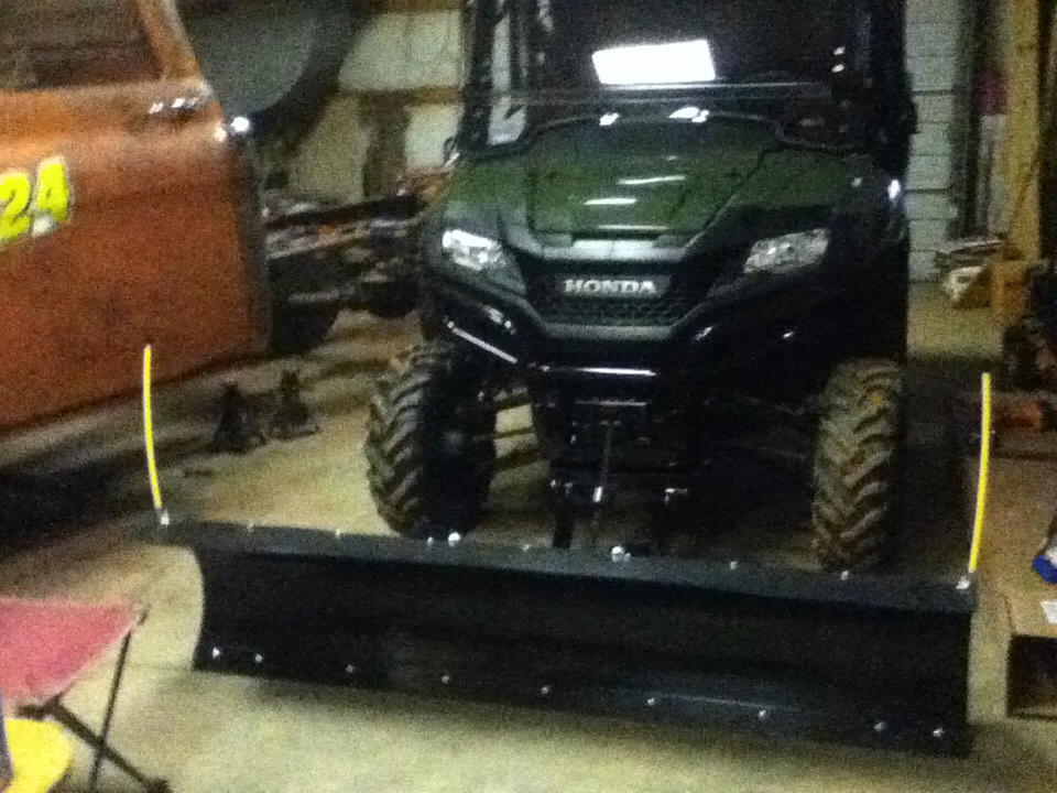

This was my mantra last year. I hope you enjoy your sxs as much as I do mine. We have become inseparable. Mine has save me walking 350 miles around the farm since last Nov.. So Let it Snow

There may be a fuse on the plow end of the hookup, but that doesn't protect the feed off of the battery. If there is one, it does give me some info to go off of as far as how much fuse is needed to run the hydraulics though.
/ Let it Snow #9
I agree Travis and have used this type. Start with a 20 amp and you should be okay.

/ Let it Snow
Thanks SpudHauler. Not sure what I'm going to do yet. Ideally I'd like something that I can mount inline, and not disturb the integrity of the supplied harness, but a good sealed crimp would work as well.

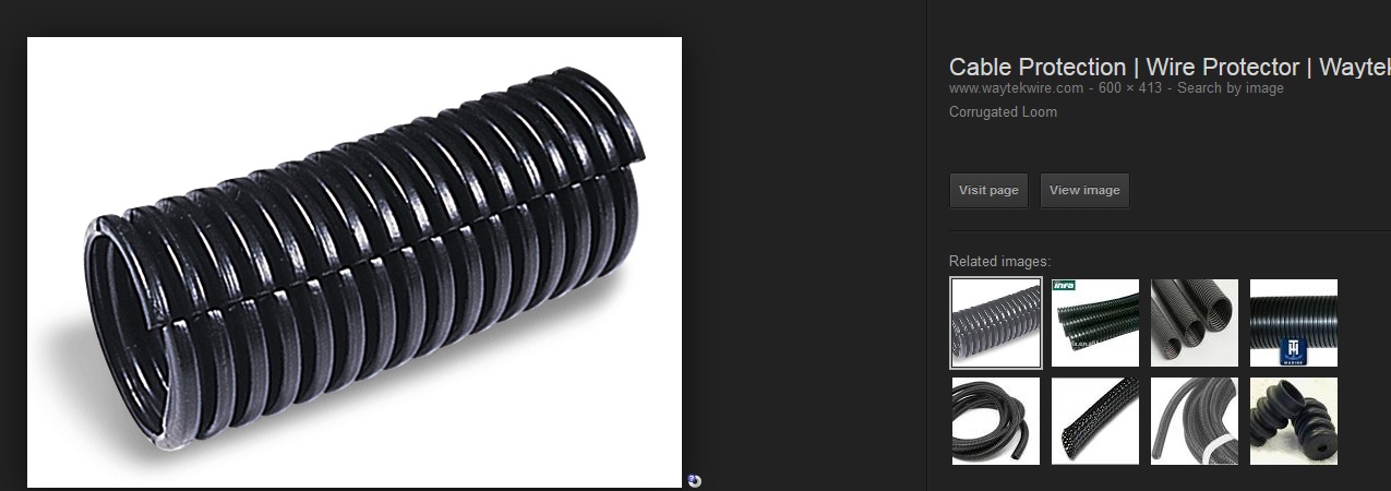

Are we talking 6 gauge wire or something more like 14 gauge. The 6 gauge wire is the larger diameter that usually is used for starter wiring and such.
Anyway, I usually use wire wrap for extra protection on these types of wire and just use lots of wire ties to make sure it's not rubbing and flopping around. Being especially careful around anything sharp edged.
On my RTV1100 I ran 6 gauge wires from the battery to the front winch with just a few areas protected with some large diameter wire wrap, worked fine.
This stuff is cheap and works well.
