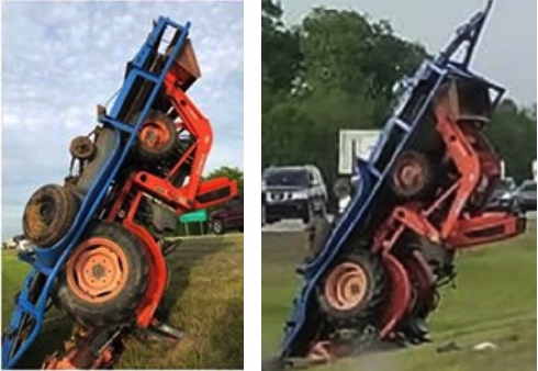

Looks like he had an implement on the back which would have moved the center of gravity rearward. It also looks like a lightweight trailer.

I've seen bearings seized up on a trailer to cause it to whip. There is more than enough weight on that trailer to keep it from whipping. That youtube video of the weight distribution is misleading. It transfers weight from the front to the back, but it ignores all the weight over the axles. Having weight on the axles does not cause that violent whipping.
Good job on tying it down
Bad job on keeping the bearings greased.
I would agree with TimberHole, front to rear COG on that tractor with a tiller on the back would be somewhere between the back of the loader upright and the front of the rear fender. Either way, it would be behind the centerline of the two trailer axles.
The load COG should be no further back than the centerline between the two axles.
IMO, the tiller should have been on the deck at the front of the trailer with the bucket sitting on top at full dump, or the tractor should have been backed on.

The picture in the first post occurred a couple weeks ago on 840 outside of Nashville, TN. I had a buddy drivy by the accident who sent me a pic of the wreck. He couldn't figure out how the tractor/trailer ended up in the position where it stopped.
