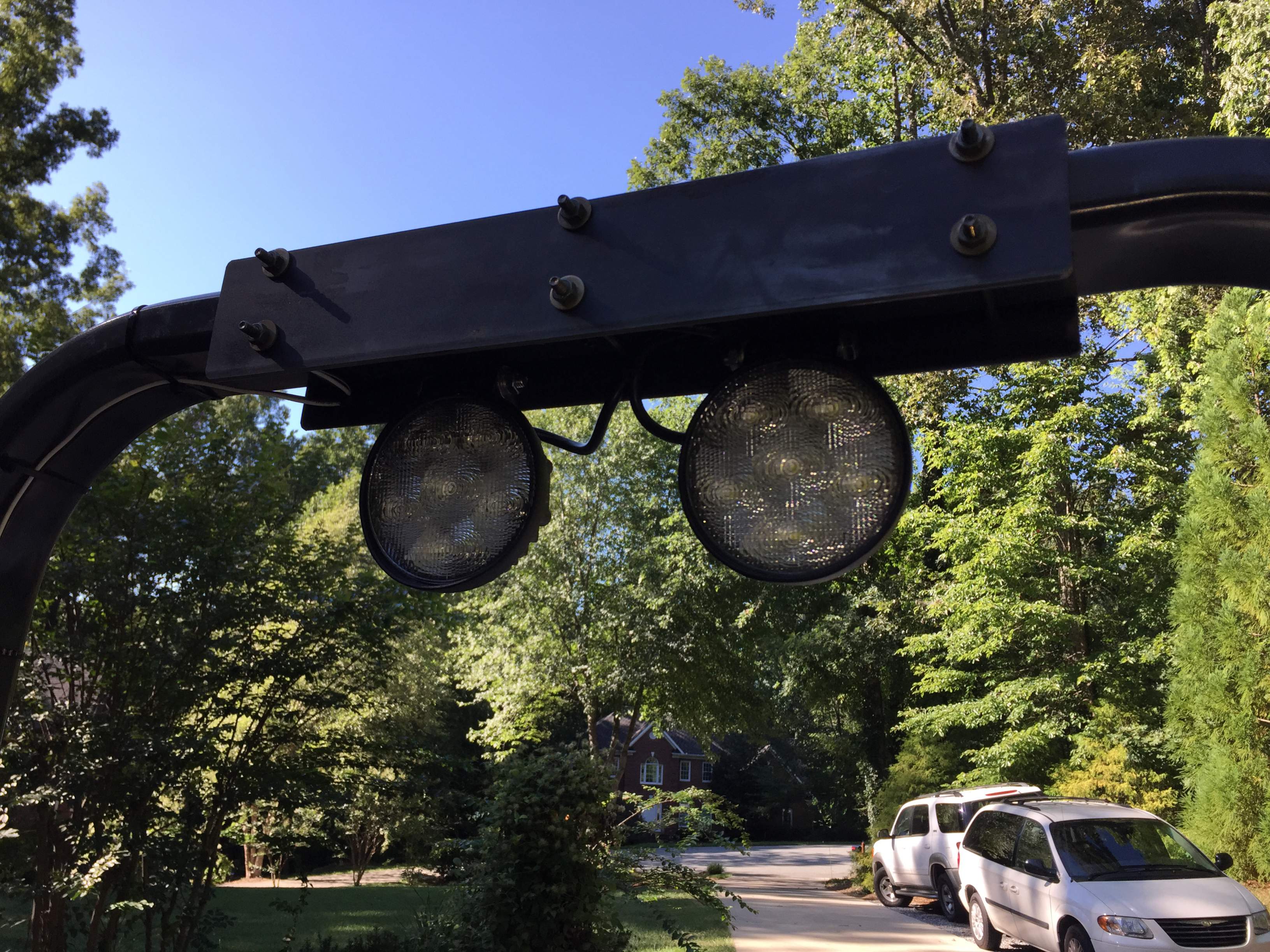

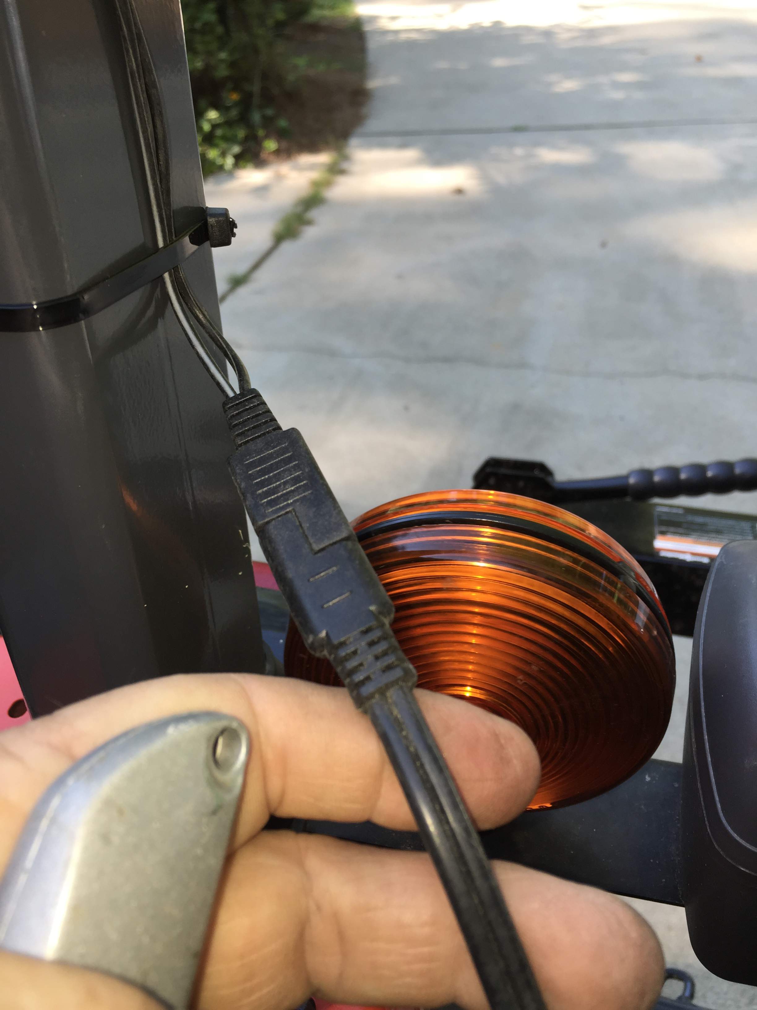

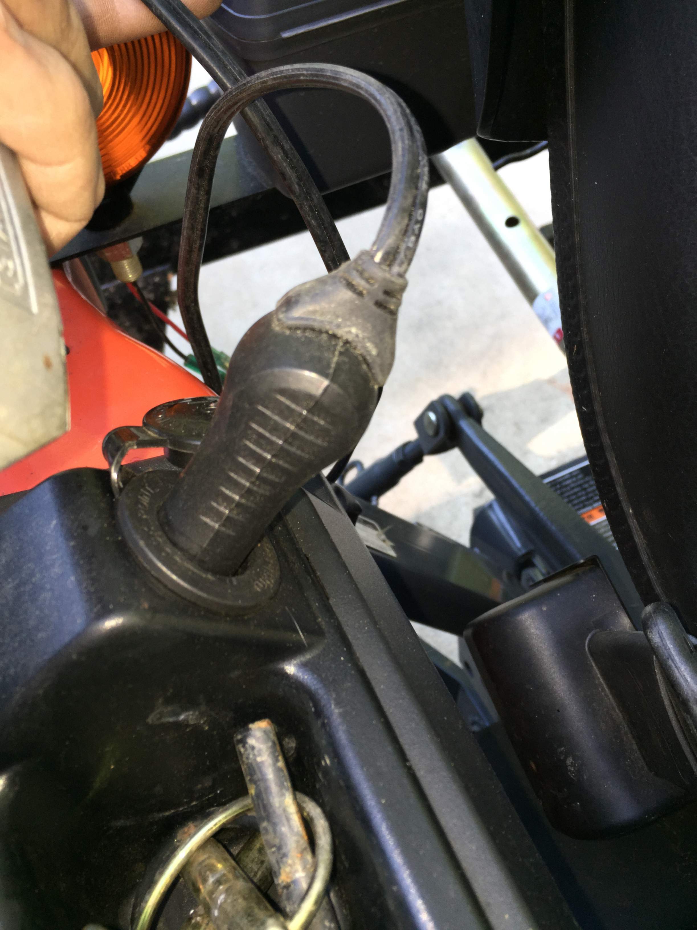

Added a couple TS LED work lights Navigator 4 in. Round Heavy-Duty LED Utility Light | TractorSupply to the ROPS on my B2650. I fabricated a steel bracket / clamp for the lights so no drilling into the ROPS was required. The spacing between the center of the bolt holes was exactly 1.75 inches. When you use a 1/4 screw, that aligns the inside difference to 1.5 inches which is the thickness of that side of the rops. I clamped it together with six 1/4-20 four inch screws. I then routed the wire down the rops to the cigarette lighter near the arm rest. I'll probably either put the wires inside the ROPS square tubing or run it through conduit when I'm done. Here's a short Youtube video of the mods I made. Check it out...

The work pretty good. Here's my trek I made at dusk tonight.

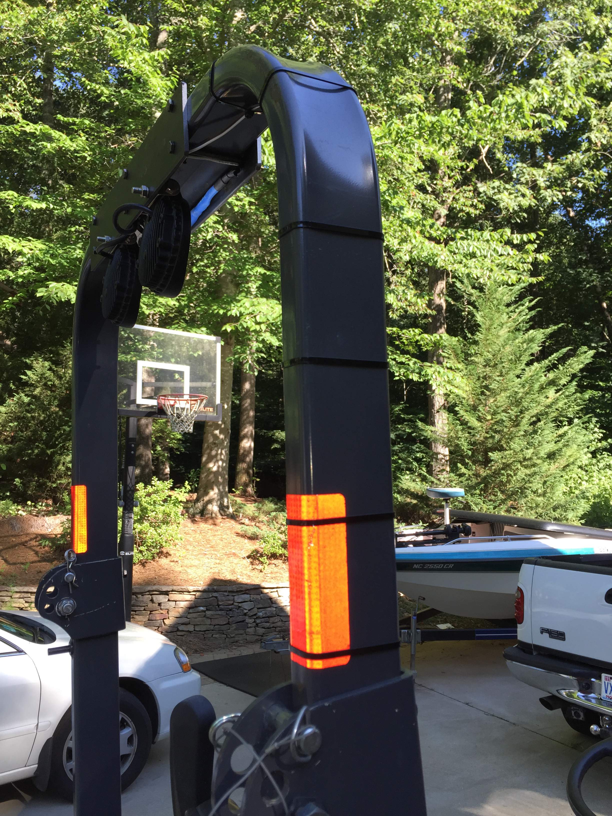

Hi Porchfan,
Those lights look nice & toss a nice light in the woods!
You mentioned you're thinking of maybe using some external conduit for the wires. Would the conduit interfere with folding the ROPS down?
If you run the wiring inside the ROPS via drilling holes in your ROPS and run the wires inside the square tubing.... I suspect that would involve at least one or two 3/8" hole at the top and another at the bottom of the upright ......are you at all concerned about weakening the ROPS protection capabilities?

My ROPS is 2x3x.250 tubing. I put one .250" and one .375" hole in the inside of the 3" dimension for wiring, and two .250 threaded holes in the center of the 2" dimension for mounting the light bar. I'm not concerned at all about weakening the structure. There's two .375" holes on the top back of the 2" dimension from the factory at a similar distance from the radius to where my additional holes are.
You can poke a lot of holes in tubing and not diminish it's strength to any degree. It's more about how much material you remove and how close to the corners you remove it. Lots of paranoia around here about the ROPS that's unfounded.

There is one hole already at the top of the rops. I think I might be able to squeeze the wires through that. At the end of the square tubing down near the transmission, the tubing is open so the wires can easily be run out there and then into a FLEXABLE wire conduit. If I cannot get the wires through that single hole at the top, I don't think another 1/4" hole will hurt the integrity of the Rops.
