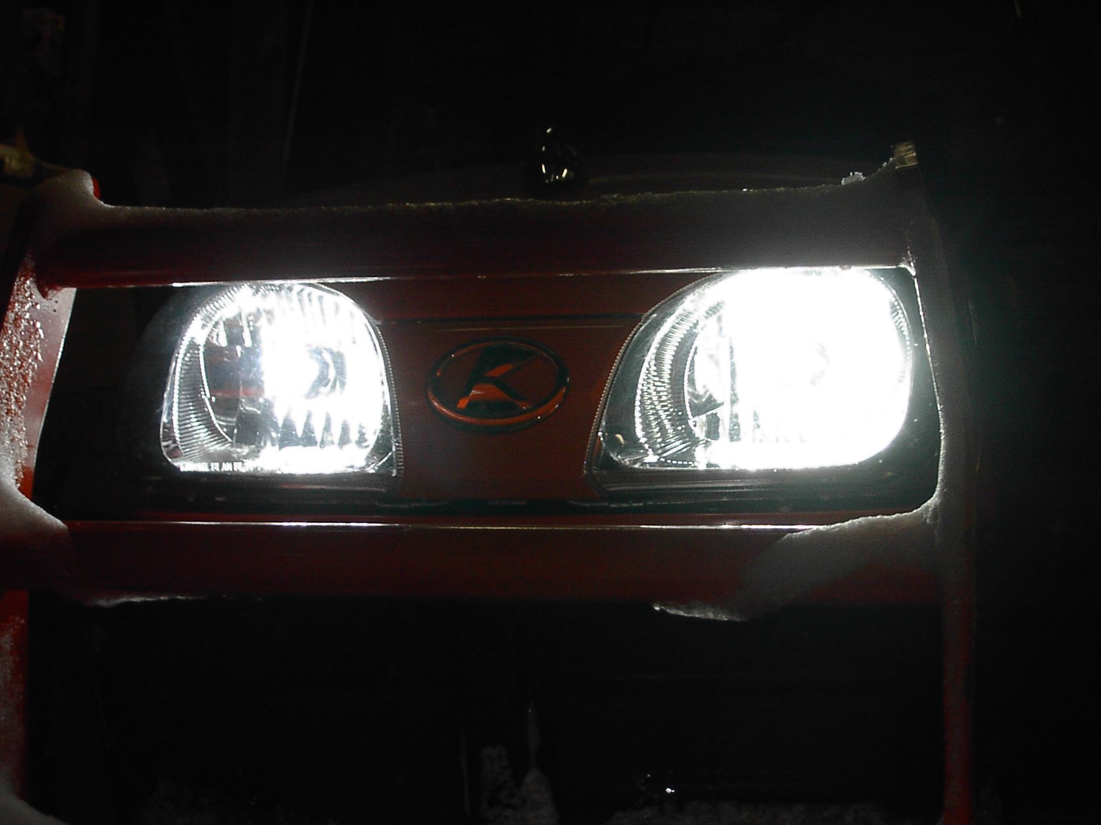

That is exactly why on my 1510 D that when I changed from the 70 watt headlight bulbs to the LED 24 watt draw, I am able to open up other possibilities for adding lights that otherwise would have been impossible.

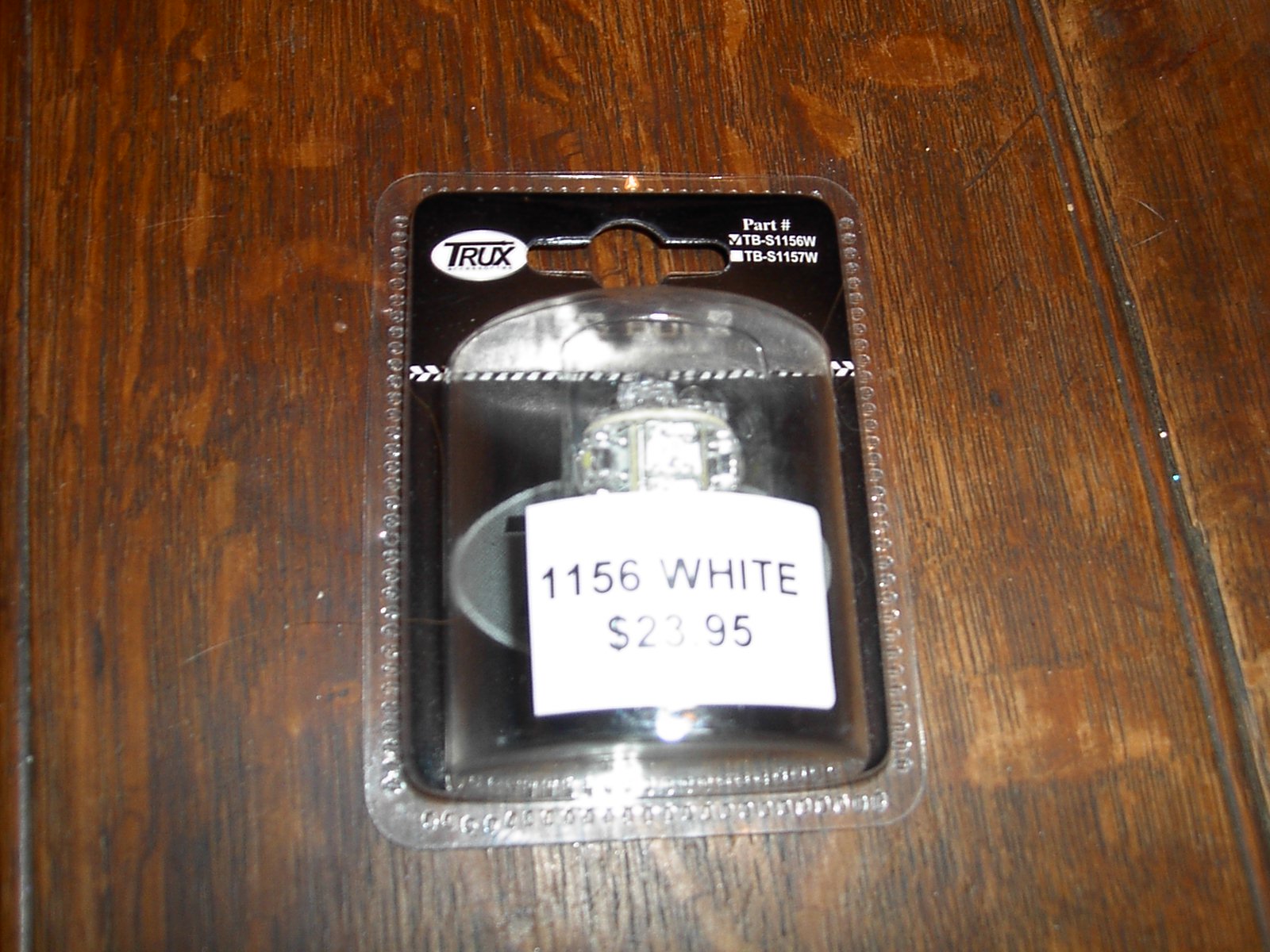

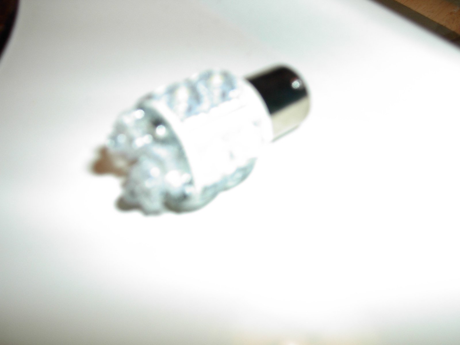

does any body have a link to order??im not haveing any luck
There were several sites mentioned previously. Posts #2, 13, 25, 33 all mention specific places that you can order the LED light assemblies. If you are just looking for the bulbs just google "1156 LED" and you will get lots of places that carry that.
