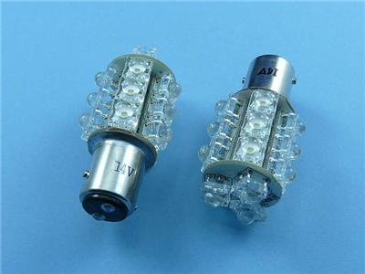

MJP, there is a shop about twenty five miles from me that stocks that style of LED bulb. What do you suppose postage to Poland costs??
That is what is so exciting is that the picture that I posted is from a POLISH electronics supplier. They have an internet shop and I can just order online and have it delivered to my house. Super easy--and less expensive than sending something to me. Although mailing something like a bulb or 2 would not be all that much. Thanks so much for your great kindness.

1. Be careful when you do retrofits changing from incandescent lamps to LEDs as many lamps have parabolic reflectors where the filaments are at the focal point , when you add an aftermarket "LED bulb" you may in fact make the light dimmer thus wasting your time and money.
2. If your tractor is equiped with a flasher for the given application, a retrofit "LED bulb" in a warning lamp may cause the flasher to not work. Many flashers are "fixed load" flashers and when you install the LED, its current draw is so much lower that it increases the duty cycle (flash rate) of the flasher.

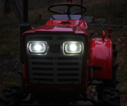

I picked up some 1156 style LED bulbs today for the headlights in my B3030. They are TRUX brand lights @ $24 each. A bit pricey, but all white LEDs are more than colored, since they aren't made in as great of a volume. I should note that amber or red were half as much, at $12 ea. I couple months ago, i replaced my tail light bulbs with LEDs. My goal is to free up available wattage for more worklights and/or any other electrics, and improve visability. The bulbs are very similar to the ones MJPetersen posted...... the diodes wrap around the light, with three facing forward.

I took a pic with one LED, one incandescent...... the incandescent looks more yellow colored. Unfortunately, the right headlight shines right at the blower chute, so it was impossible to tell which bulb shone brighter on the inside of my overhead door.
