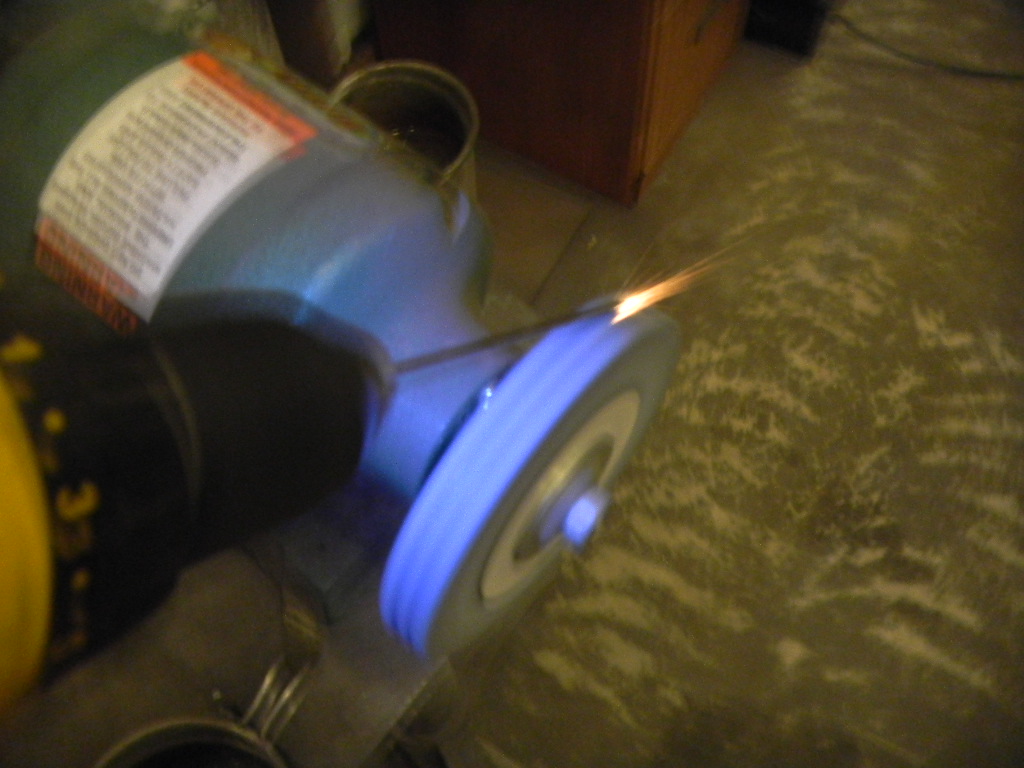

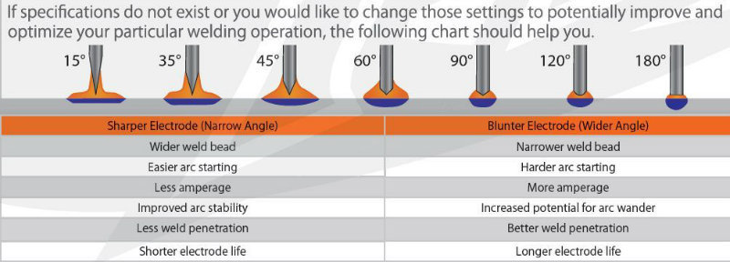

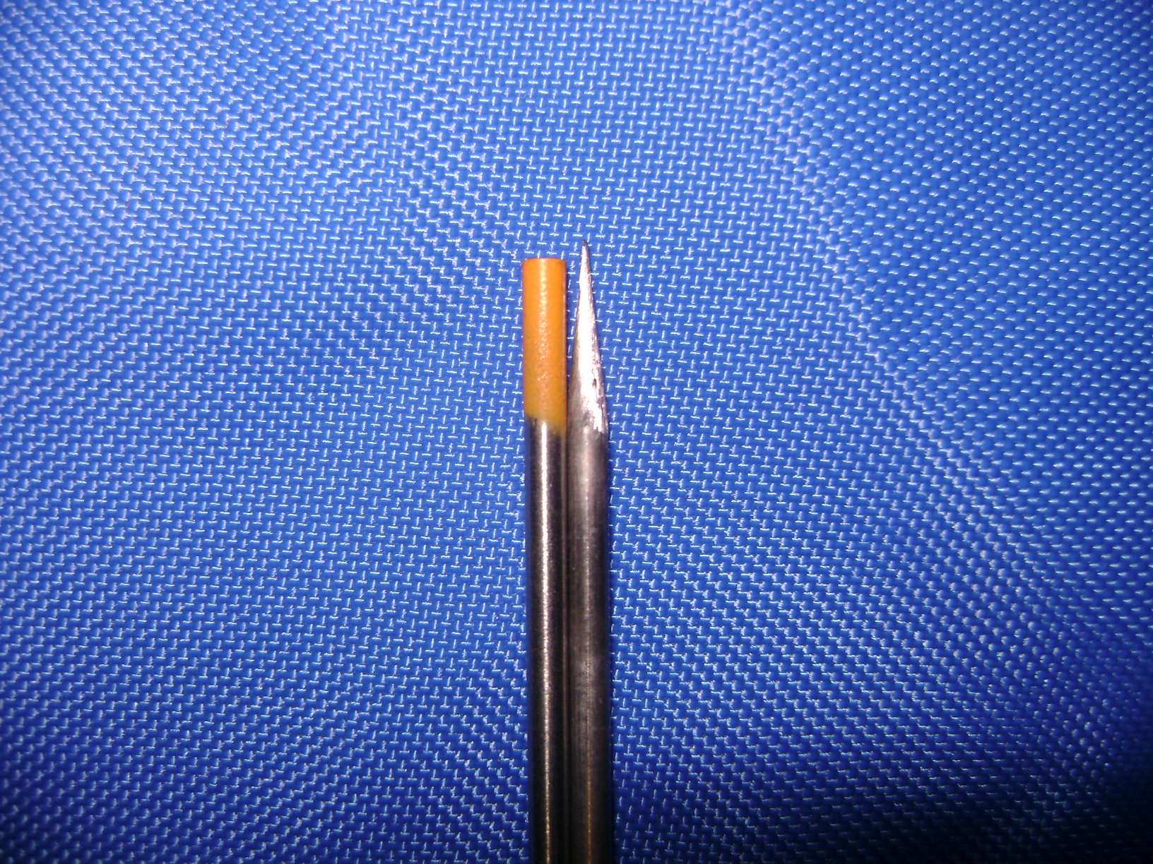

With TIG it's the little things like tungsten prep that drive me nuts. Found out yesterday that I was grinding my tips completely wrong and using them that way would make even the most accomplished pro look like a newbie.
One of the moderators over on Welding Web posted a picture a few years ago of how he sharpens his tungsten. Use a drill motor to hold / rotate your tungsten on a bench grinder. It's best to stand behind the bench grinder if you can. Less chance of the tungsten getting jammed in the grinding wheel that way. You can raise or lower the drill motor to get the angle you want on the tungsten.
That's the way I was doing it, but I had the drill on high speed so it was making spiral striations on the tip. Kenny uses a belt sander and the drill revolves slowly to keep the striations parallel to the shaft. I'm going to try it that way this evening.

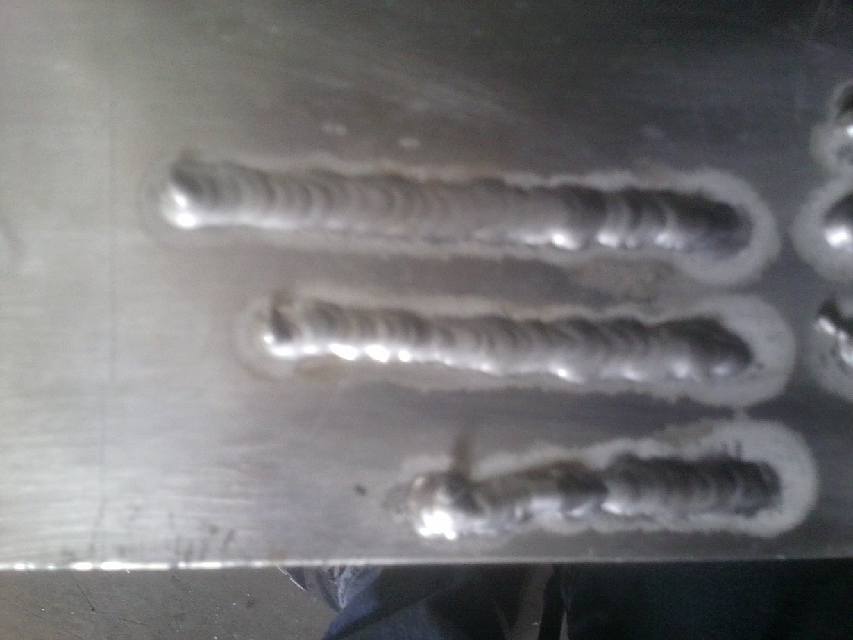

Forgot to mention the guys on this forum have a bunch of helpful input as well. Ran a few beads after re-doing my tungsten:
1/8" Al plate, 80A, -25% balance, 20CFM, Freq 90hz
