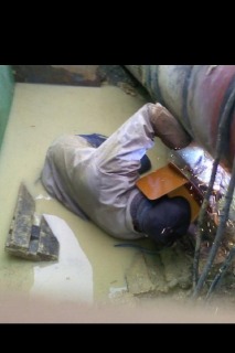

Some people don't worry about it! :laughing:
