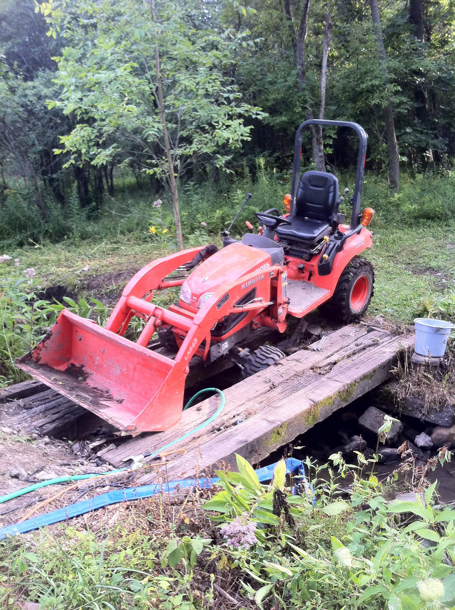

Just glad your ok! I dont even put my loader on unless I have a massive counter weight. My loader saved my butt this past friday....
