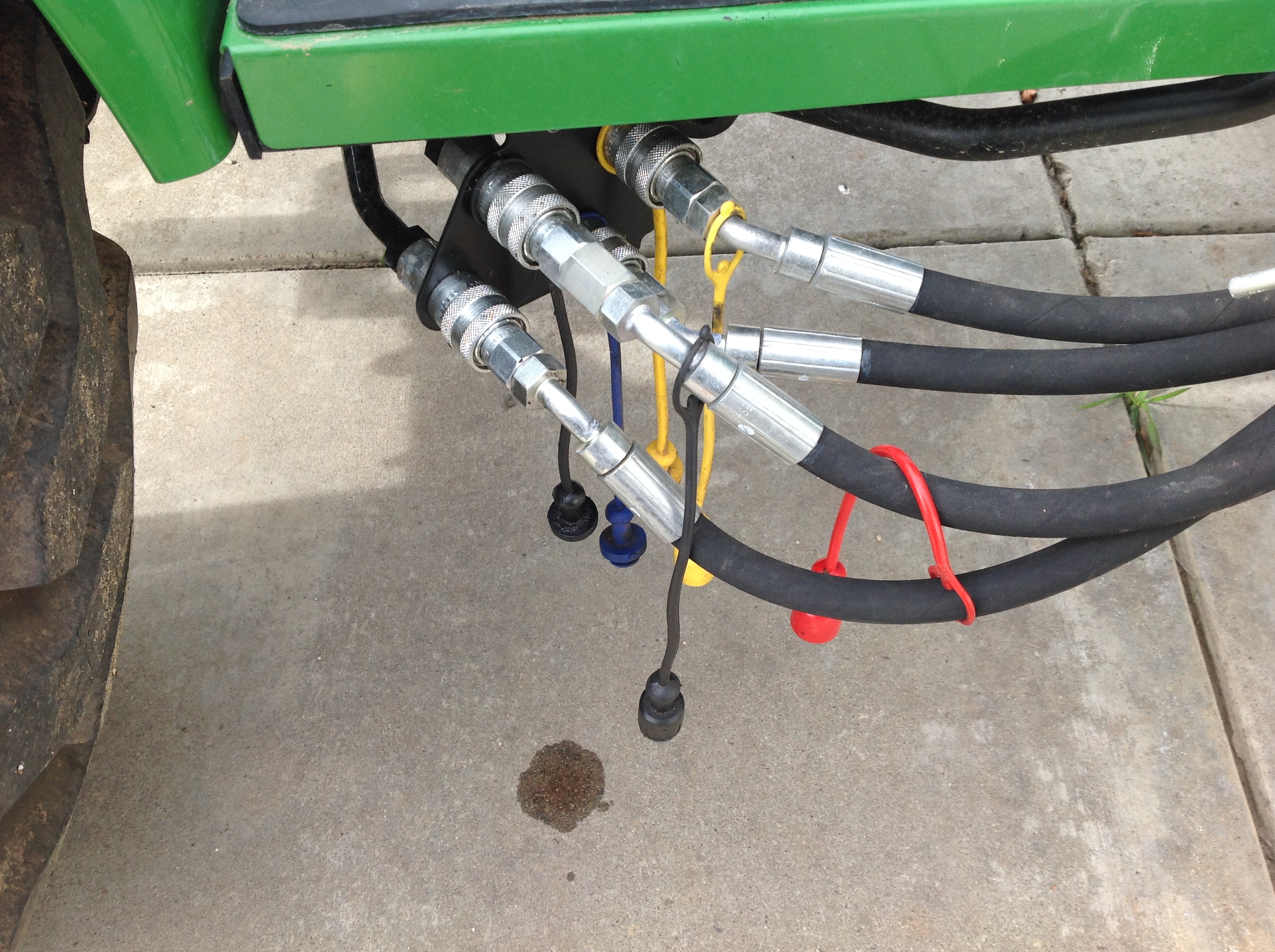

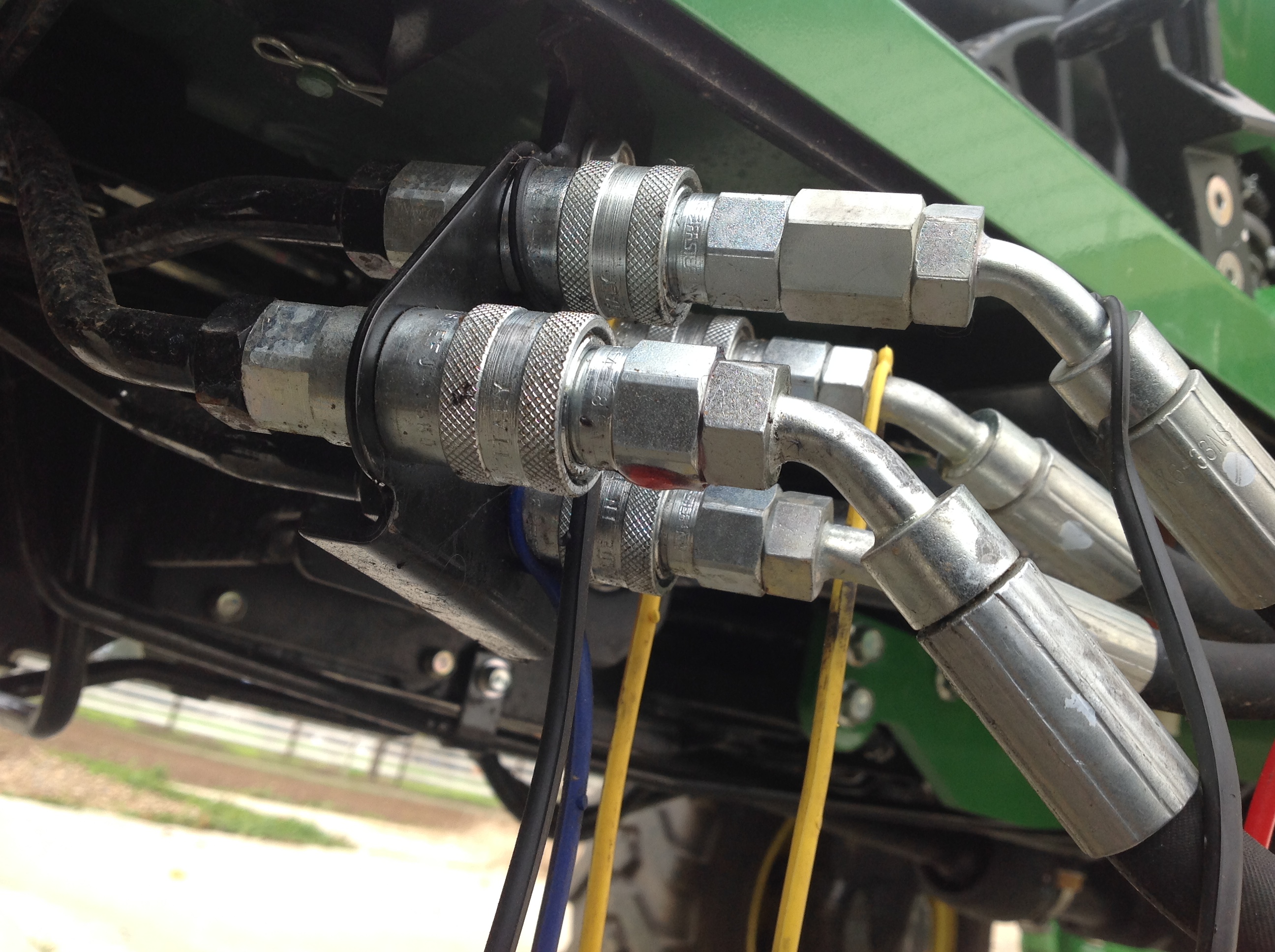

I have a hydraulic leak and it appears to be wet at the connection or to the right of the connection, any tips to fixing it, I know if it's a threaded connection you take it apart and put more Teflon tape on, but what if it's the fitting. The lines above are dry both directions.
/ Leaking hydraulic fitting #2
BE VERY CAREFUL WITH TEFLON TAPE!
Leave something like the last 3 threads on the end uncovered so you don't get "bits" into the hydraulics. Better yet there are some forms of loctite etc. designed for hydraulics. Hopefully someone else will chime in.
Check the torque.

You might also look to see if some trash has made it's way inside the coupling.

Update: John Deere came out to my property because the tractor is still under warranty and when he unscrewed the fitting there was a piece of the o-ring missing, someone must of not put oil on the o-ring before they tightened it. A big thanks to everyone who posted on this thread :thumbsup:
