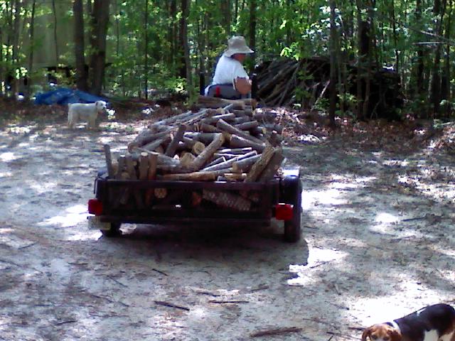

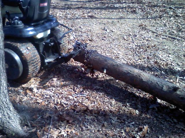

We had the same delimma a few years ago. Iwatched the Sears Outlet store until I found one that wasn't hydro static. This one was recommended fro ground engaging equipment. Paid $1,600. a few years ago for it. GT5000.

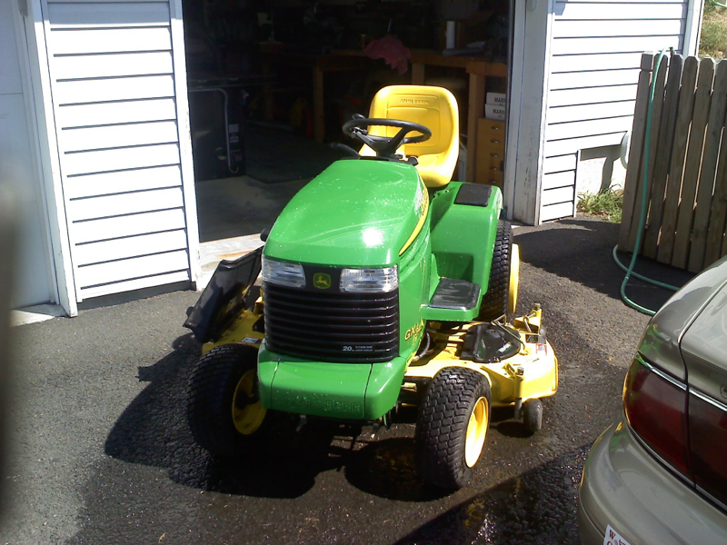

I don't know exactly how much you want to spend, but I can tell you this, for about $3000 to $3500 you can buy a 2003 to 2005 John Deere GX345 with around 300 hours. These tractors can't be beat for the money. You can pull a 17P trailer loaded with dirt and stone up a 30 degree incline all day long. I know because I just did it. It has a liquid cooled 20hp Kawasaki engine, power steering, hydraulic lift and you can also get a limited slip rear dif. (mine doesn't have it, but wish it did) Trust me, these machines are as solid as they get and will last a lifetime. Do a search on eBay. It was a very popular model, you can easily find one. Good luck and let us know what you decide.
