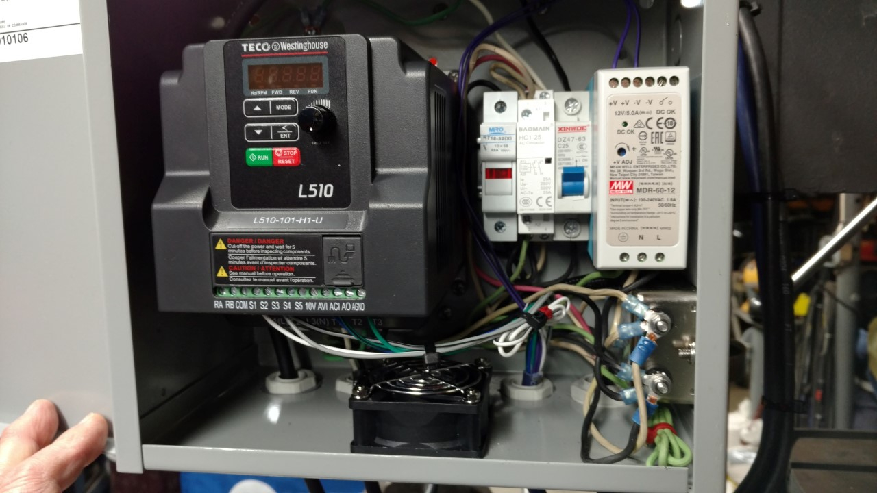

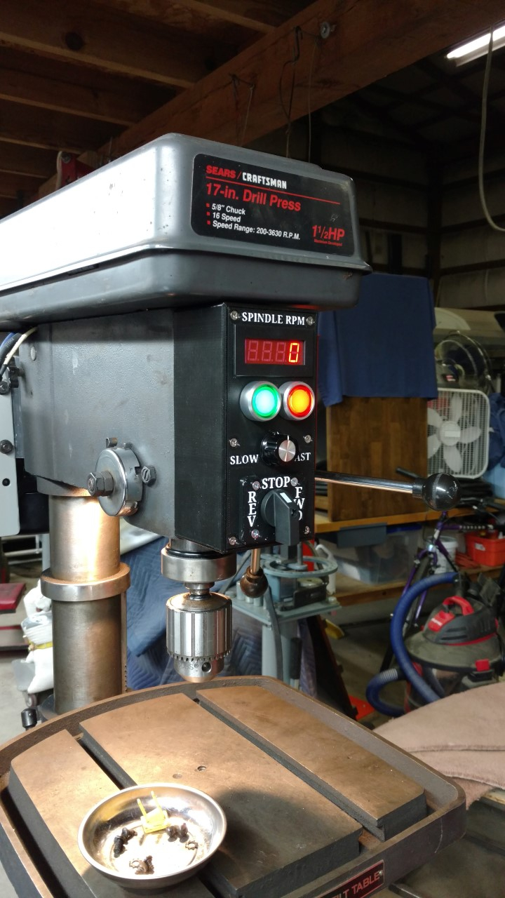

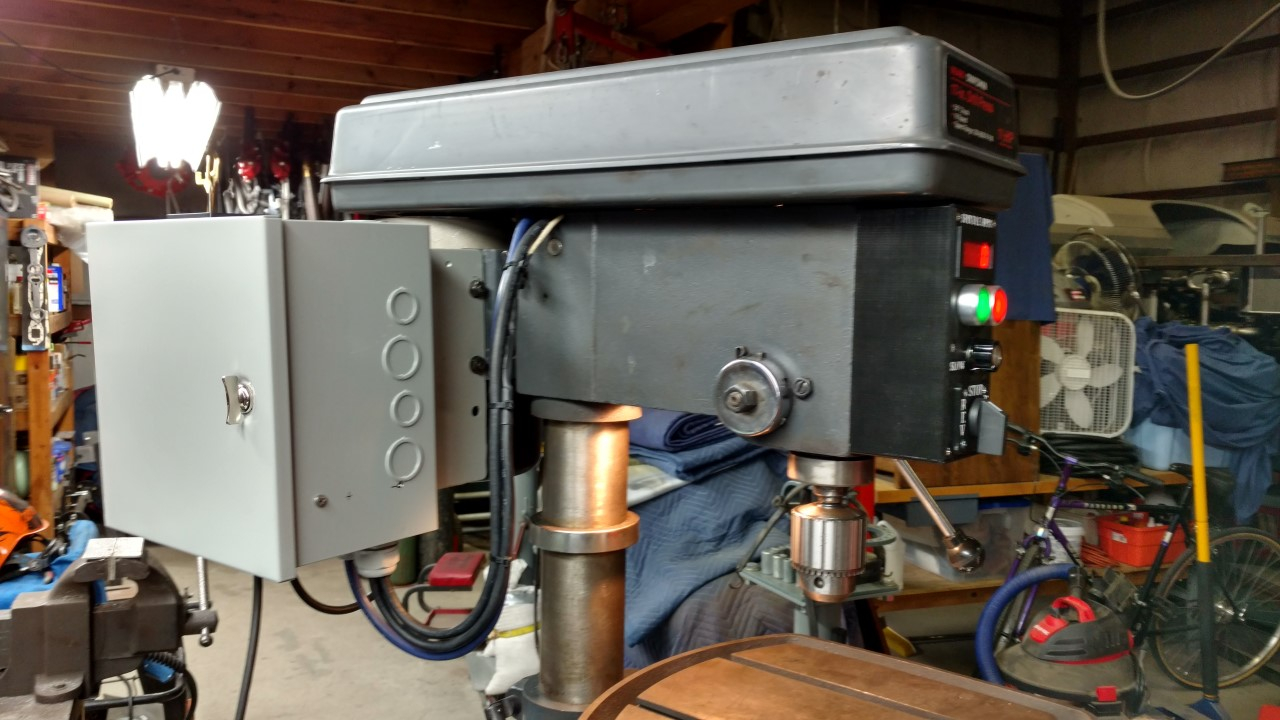

I converted my Craftsman drill press to a 3 phase motor and VFD a couple of years ago, and love it. No more moving belts around, just dial in the speed I want and drill holes. I used a Teco 510 VFD and a Connex 1 HP 3 phase motor I picked up at a local motor repair shop, made a new control panel and added a tach display to it.
I'm looking at doing the same to my Jet B920N lathView attachment 780201e.
View attachment 780198View attachment 780200
I did the same as you with my 2hp milling and drill press and also my 2hp lathe. on the lathe I enjoy the soft start especially when cutting metric threads as I have to reverse leaving the split nut engaged When taking multiple cuts.
