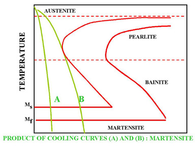

This Metallurgy for Dummies page also provides more background. This TTT graph (Time, Temperature, and Transformation) came from that page (the bottom axis is time). THere are other graphs at the link which provide more detail.
the cooling rates A and B indicate two rapid cooling processes. In this case curve A will cause a higher distortion and a higher internal stresses than the cooling rate B. The end product of both cooling rates will be martensite. Cooling rate B is also known as the Critical Cooling Rate, which is represented by a cooling curve that is tangent to the nose of the TTT diagram. Critical Cooling Rate is defined as the lowest cooling rate which produces 100% Martensite while minimizing the internal stresses and distortions.
If you cool slower than "B" so the green curve crosses to the right into the "nose" of the red curve, you will no longer get pure Martensite. The resulting mixed structure will not be the most durable or predictable in terms of hardness, ductility, impact resistance, stress, etc.
The distance between the nose of that left-most red curve and the vertical axis is a matter of a couple seconds. The position and shape of that curve varies with the alloy of steel in question. The lower the Carbon (among other elements) the closer that nose of the curve is shifted toward Zero seconds, making achieving Martensitic structure impossible. Higher carbon gives you more time, and allows the option of a more "gentle" quench.
