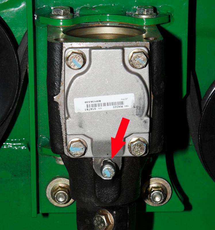

I just received and installed my axle kit from Larry's axle Co., and while the product is great and works just as well as advertised, I came home tonight to find the relief valve on the top of the gearbox (now on the bottom with the deck perpendicular) dripping all of the fluid into a nice puddle on the garage floor. Anyone else had this problem? I figure I can just remember to remove the relief valve and install a plug every fall(and reverse the process in the spring), but I just wanted to see if everyone else's relief valves were acting similarly or if maybe mine has a problem.

The Deere parts catalog for the 62D does show a pressure relief fitting on the top of the gearbox right over the input shaft. I suspect that your fitting is loose or defective.

Attached is a picture. The manufacturer name is "Alemite", and when I look them up the part looks like their vent http://www.alemite.com/catalog/details.aspx?identifier=fittings_airventvalves but I can't tell what pressure. If it is a felt vent (0 psi), then what I am experiencing would be normal, but if it is a rated vent, then I don't think I should be getting the drainage. The leak is not coming from the threaded portion like it isn't tight, it is running out from beneath the cap. The cap on mine is completely loose and can be easily moved about with a slight touch. Can someone else with a newer style like mine see if that is normal? Thanks for checking.

My deck DOES NOT have the same top plate..
My unit is pretty much closed unit - no removable part at all - but it sorta/kinda looks like it has a pressed in plug on it - that may be removable, but just not easily..
I wish mine had the bolt on top like yours, it would make oil changes easier..
Brian
/ Larry's axle kit with 62D question #12
2malamutes,
I believe the vent/cap on my 62d is like yours. It is loose and spins freely and honestly, seems rather flimsy. I'll have to take a closer look later today.
/ Larry's axle kit with 62D question #13
My 62D, purchased last spring, has no vent.

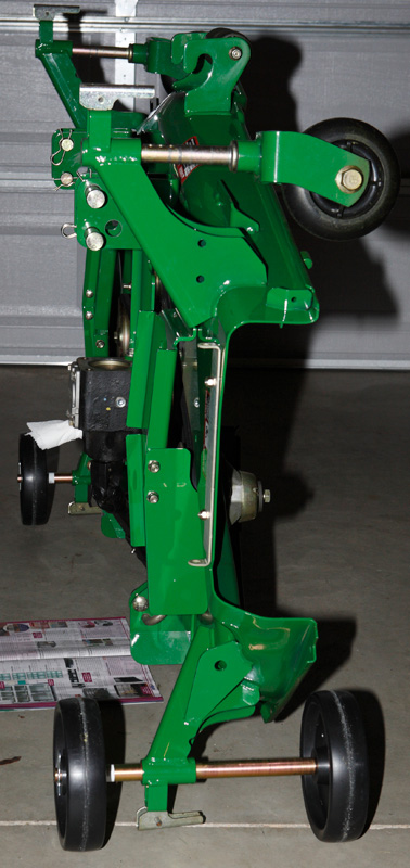

After looking at the "Larry's" axle stands, I can't figure out how the wheels are big enough. They don't look like they're even 8 inches and I figure that with 8" wheels, the gauge wheel adjusters will have only about 1/2" clearance to the ground.

If I get time this afternoon I'll take a pic of the deck and stand. Clearance didn;t seem to be an issue, even on the gravel driveway.
While the attached pic doesn't illustrate the clearance well, there is plenty of clearance with the "Larry's" wheels. Since the adjusters are parallel to the axles, you would have to have a _/\_ shaped profile between the two wheels for the clearance to be an issue. I think you are more likely to get high centered going over something front to back than have issues with clearance between the axles.

I used 8" wheels and the wheel height adjusters hit the floor at times.. I am thinking about getting some 10" wheels for it..
