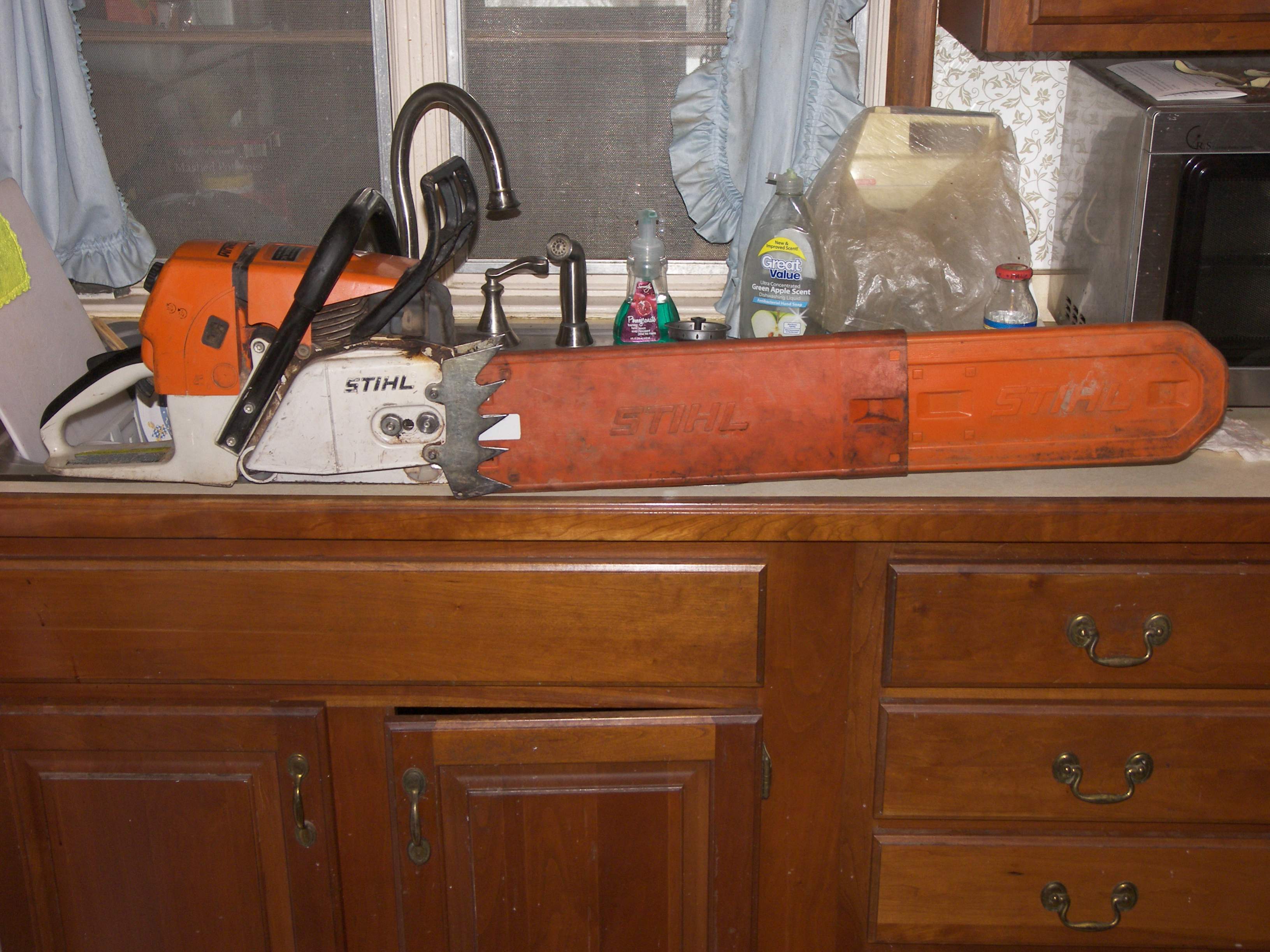

Yeah, here's an example of the junk I bought off Craigslist for $450.
STIHL 088 (~1998) + 36" bar + Alaskan Sawmill - $450 (Oakton, Va)
Date: 2012-09-08, 4:56PM EDT
Reply to this post 6x6qr-3259136490@sale.craigslist.org [Errors when replying to ads?]
This is a STIHL 088 chainsaw (8.9 HP!, cost $1200 new), runs great. I used it for milling logs into boards (not professional load, but heavy usage when used) using an Alaskan Sawmill (an attachment that clamps on the bar, ~$200 new.)
Engine just serviced - runs great. Comes with chains and custom boxes (2) I built to hold engine and sawmill attachment and accessories. 36" bar and sawmill attachment allows 29" wide cut through logs. Otherwise if you don't want sawmill attachment, engine is not modified so it works as purchased.
Price is FIRM minimum. If multiple offers, buyers allowed to "bid" higher. STIHL 088 (~1998) + 36" bar + Alaskan Sawmill - $450 (Oakton, Va)
Of course besides the boxes and bar it also included the Alaskan sawmill which I wanted, and they go for $200 plus new. The guy lived in suburbia and had milled a few trees around his house, filled his one car garage with cut lumber and never got around to building anything.
Your ol buddy who fell five foot trees with a twenty inch bar must'a been quite a beaver. PRODUCTION timber cutting is a lot different from bucking up stuff fifty feet from your pickup truck. Very few "woodcutters " NEED a big falling saw and three foot bar. There is no sense in buying a five cube saw and big bar if you aren't gonna bury the bar all the time.
I'm into chainsaw milling, and am looking for an inexpensive 5 or 6 foot bar so I can mill the occasional big tree.
/ Larger Saw Purchase #75
<img src="http://www.tractorbynet.com/forums/files/chainsaws/384350-larger-saw-purchase-088_just-bought-jpg"/>
I wish I could find "junk" like that. Seriously, did you have a mask on when you bought it? A "Stihl" if I ever "saw" one. Very nice.
Does it burn your hands when you use it?
That is definately a piece of junk, I'll give you fair scrap metal price for it, don't want your garage so cluttered with junk. :shocked:
I've gotten some pretty good deals along the way, but that one's something to write home about :thumbsup:
