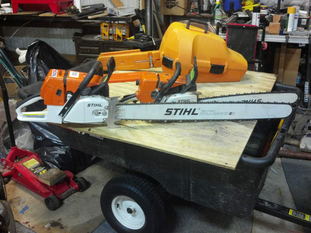

Welcome to the forum my first question is how are you built and do you have good upper body strength and a good back? I have a 50" chest and can bench 2 sets of 15-20 reps at 250lbs
No the 660 is not to much saw for that kind of wood but it would make cutting fun. Is the saw to much for you the better question. I bought a m361 because my dad has a 026 predecessor to the ms260/261 it just didn't have the power to satisfy me when cutting anything close to 18"
The Ms361 cuts 20" wood descently fast, and alll was fine until all the ash died. My buddy and I had countless 24" plus ash trees the 361 is rated for 24" bar but I found it was painfully slow in the ash.
Maybe I should have tried skip tooth chain to get more power per tooth.
After taking 8 or more of these 80foot trees I said screw it I need more power. Thought about the 460 but it really was not much more saw than the 361 4.4 hp v 6. Didn't seem like a big enough jump. So I bought the ms660 this saw kicks but. I run a 25" bar 70% of the time with full chisel RSC chain and a 36" with RSF or RMF skip tooth the rest of the time.
The saw is perfectly ballanced with the 25" bar while the 361 is noise heavy.
The 660 is a beast and it is heavy. With 7 hp it flat out cuts and makes every one whom ive let run it giddy and giggle like a school girl My buddy runs a husky 372xp 5.3 hp and a very nice saw worth looking at. He agrees the 660 in the big wood is pure happy significantly faster than his. Pretty much now if I'm cutting 12-14" or larger I go for the 660 its just faster. I use the 361 for limbing and sometimes felling smaller trees up 16" - 18" if I have a bunch to drop.
With that said my nextor neighbor has a 290 farmboss it's been a goodsaw but he wanted more. I recommend him to go for the 460 which he bought and loves ive run his saw is significantly lighter but still cuts 20 plus wood pretty darn fast. I would say look at the 461 if you only have a few of these trees youd probably be happy with either.
If I had envisioned owning a 660 or 460 I would have definitely bought a ms260 or 261 instead of the 361. As its usued pretty much only for limbing.
In my book if your looking to pay someone or buy a new tool to get the job done id say go for it. But then again every time we have a project my wife claims I come up with excuses to buy new tools. I say fine pay more for someone else to do it.

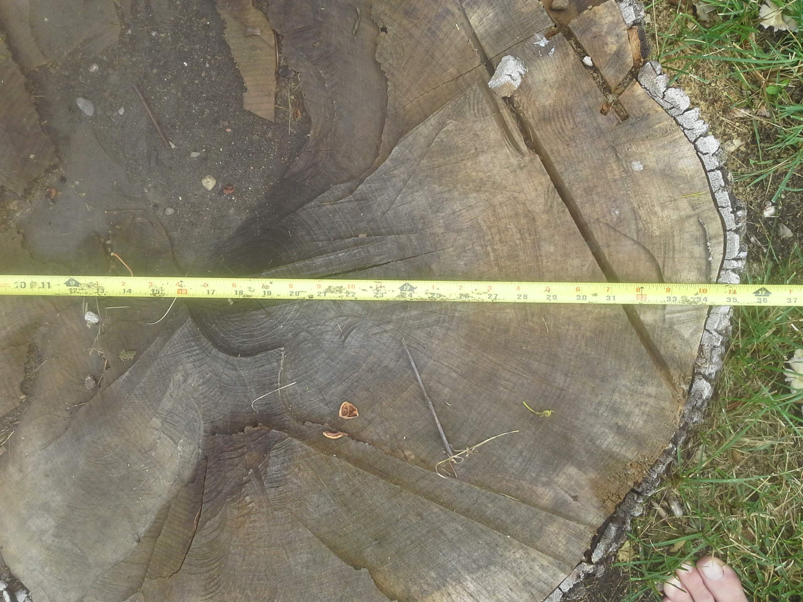

Are they are mostly 20" trees with an odd 1 or 2 at 28"? You can take down 20" trees all day long with a 16~18" bar. You can also take down 28" trees with a 16~18" bar, it's just more work ;)
I think minimum power would be in the 50 cc range for your task. As others have said, a bigger saw takes better conditioning to run for any period of time to do the same work to a point.
The tree below was probably about the biggest I would tackle with with my Husqvarna 445 (46 cc & 16" bar) but it didn't just fall over when I walked up to it. It was work.
