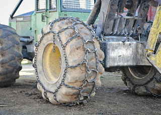

I guess the problem was I was looking for a decision between 2 link v bar ladders, v-bar duo grip with cross chains, or the aquiline talons. I
Given those choices, I'd think the v-bar duo grips would do best bang for the buck, particularly for lateral grip (sidehills).

I've got chains similar to the Talon ice chains. They are fine on ice but not so much in dirt. They quickly did holes in the dirt. Not sure how it is where you are but it's not uncommon for the snow cover to keep the ground from freezing. You'll pay twice as much but I think I would go with the ring (bear paw) skidder chains and live with the rough ride. It would really suck to spend Talon chain money and find out that they didn't work out.
That is exactly why i'm going back and forth on these chains. (I took a heck of a ride last winter on some partially frozen ground.) Its not like any of the options are around $100where I could buy it and try it. I will def be reporting back on which ever option I choose though. The talons looked to be the best compromise for ice/snow and mud. My thinking is that the R-1 tires should handle the mud like normal/the studs should get pushed in to something firmer maybe and regardless they would be wonderful on ice/packed snow.
I don't think I want to put the time into fixing up some hard used skidder chains that might last a couple years. If the township road wasn't paved I could really put some more thought into them. I already bent the snot out of the tirechains.com "HD" chain pliers trying to spruce up a set of v-bar duo's for the front tires.

Backstory: So i think a little update is in order. I ended up buying a set of the aquiline talons from tcr.com . The sticker shock was the main reason in why I drug my feet for so long. tirechains.com is where i purchased my previous v-bar duo's and I was less than impressed with them. I ended up buying extra duo patterns and modified them to tighten up the patterns and I still was not happy. I took another members advice for this year and loosened them up and it made a pretty big improvement but I knew I still needed to get rear tire chains.
ok enough backstory, I received my talons from tcr.com and holy man are they heavy. I picked up the box and carried it across the parking lot to lay out the chains and I had wished I wouldn't have when i finally set it down. (248lbs plus the crate) I couldn't resist putting them on that day even though we didn't have any snow or ice at that time. I was a little bit confused about the extra fasteners but I quickly realized they were just spare parts. My chains just fit onto my tires with very little slack in the 4 chain loops. I took it for a little test drive while I was putting round bales out for the horses and it looked like I was driving a tracked machine around with the constant chain imprint in the mud. I kept it out of 4wd and never even noticed I was in 2wd on the steep muddy hills. I don't want to say it replaces 4wd, but it sure gets around much, much better!
If anyone is looking for a good set of chains for an R-1 tire, I would certainly recommend getting the talons. I think the duo's worked a lot better loose on the fronts, but there is no comparison between the two of them. (I can't say how much the tighter pattern helped either since I didn't have anything to compare it to.) WE are slated to get 5-9 inches of snow with some sleet mixed in over the next 36 hours so it should be a pretty good test of the talons. We also have a L3400 with r-4's and v-bar ladders work very well on that tire type since the treads aren't deep enough to hide the chain.
