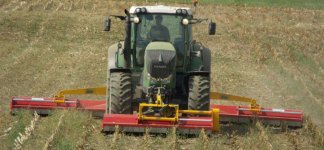

If anyone would like to see flailmowers at workpPlease visit www.inbrezice.com and enjoy the videos of their 21 foot folding gang flailmowers bringing sunflowers and 10 foot goldenrod down to the sod in one pass.

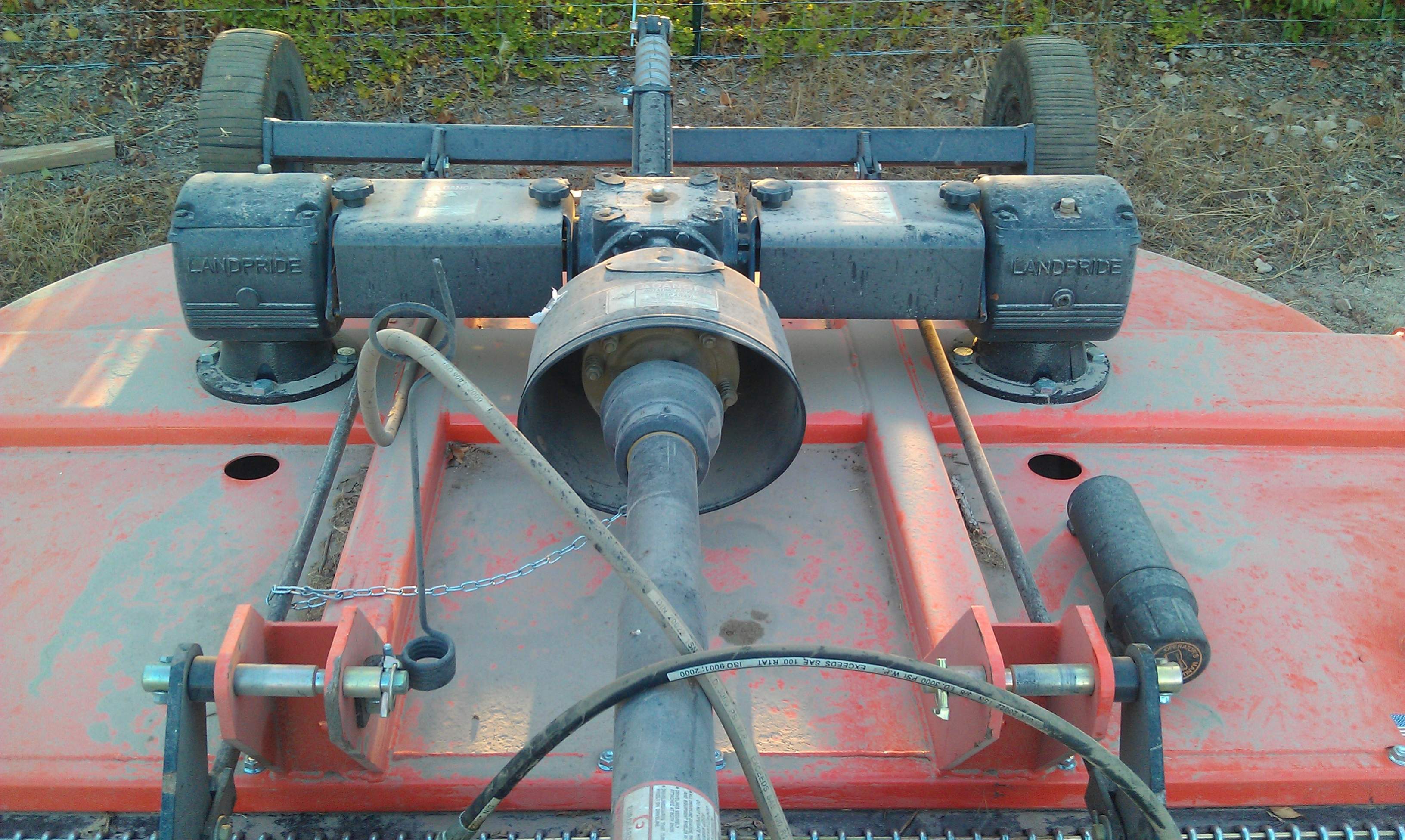

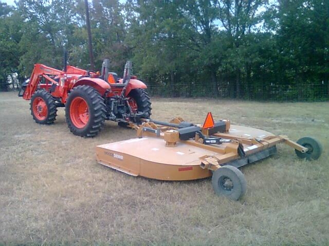

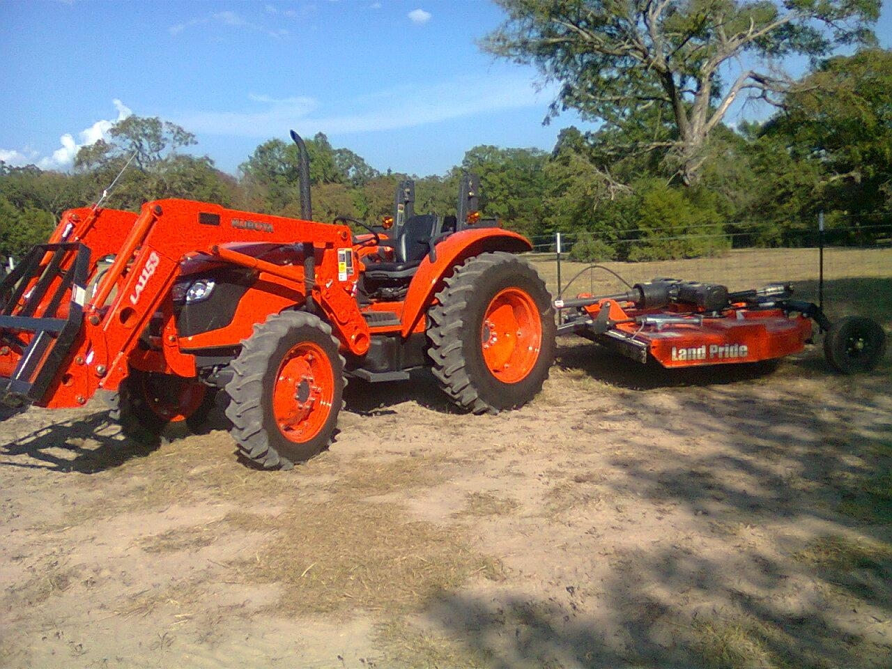

I use my Kubota 5040(45pto)to pull 8ft LPtractor3.JPGLP3596.jpg,cut our bottum 4' tall weeds and have mowed my yard with it leaves a really good cut.I will say the wider you go,gonna have to really watch for the mower deck digging in. I do use our 12ft sometimes5040 and ds1440.JPG for shorter stuff around 1' but it will dig in when trying to mow low on un-level ground,found out on my yard first time. I just got a 15ft batwingbatwing2.jpg and have also been using it for light clean up,really can make up some ground. I am going to sell my LP 8ft and looking at adding 2 more remotes and getting a 12ft batwing and if I get into some thick stuff can always scoot over some or just pick up a wing....
Smooth pasture was able to run 5mph with 15ft batwing,if your mowing rough ground might as well go as wide as you can,gotta go slow anyways...

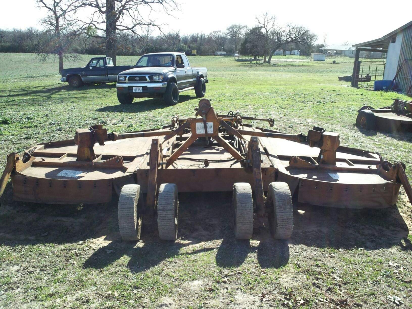

our county has some 20' schulte rotary mowers.
for stemmy stuff in dry WRA's they pulled em with the same 7610s that normally pull 15' mowers for ROW mowing.. Might want a touch more hp in grass though.. but then.. those are 95 hp tractors only.. 110-130 might be nice in lush grass...
/ Large Area Mowing #51
Just as the mowing season ended, I added a couple 20'ers to the inventory. I got to use one for a while behind my 4440 Deere (130pto hp "stock", but turned up to 145 hp) I was mowing Johnson grass that was taller than the cab of the tractor, albeit dried down from late summer drought conditions. I knew the ground well, and knew there was nothing in my way....so I could go as fast as conditions would allow. At one point, had 'er rolling along just above 5mph. Made for fast work of 40+ acres. Big issue with mowers that size is their weight....Gotta have a stout tractor to drag a mower like that through tough spots, especially if you hit any wet spots or hills.

I use my Kubota 5040(45pto)to pull 8ft LPView attachment 250090View attachment 250091,cut our bottum 4' tall weeds and have mowed my yard with it leaves a really good cut.I will say the wider you go,gonna have to really watch for the mower deck digging in. I do use our 12ft sometimesView attachment 250092 for shorter stuff around 1' but it will dig in when trying to mow low on un-level ground,found out on my yard first time. I just got a 15ft batwingView attachment 250094 and have also been using it for light clean up,really can make up some ground. I am going to sell my LP 8ft and looking at adding 2 more remotes and getting a 12ft batwing and if I get into some thick stuff can always scoot over some or just pick up a wing....
