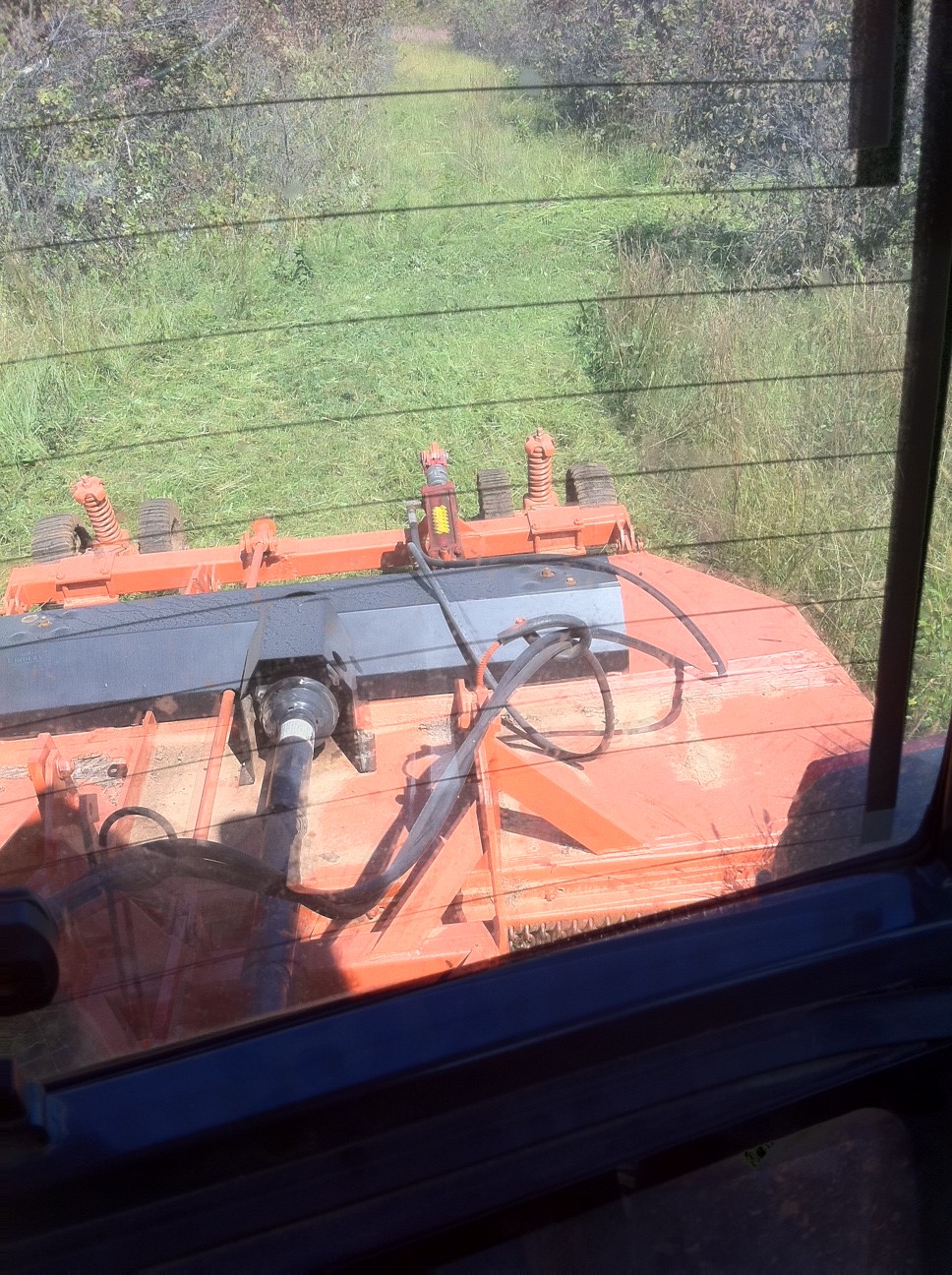

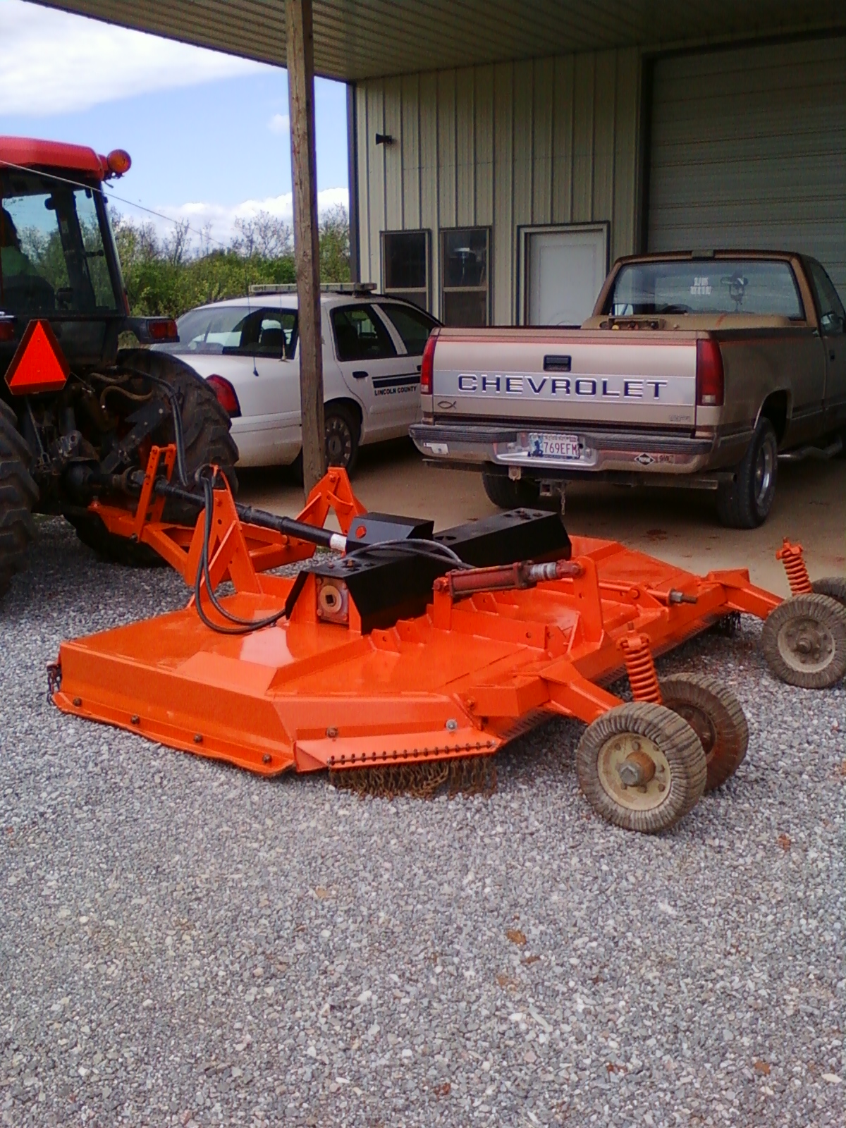

golfsuper I have a JD 3720 cab and I pull a woods DS96 pull type rotary mower (8 foot dull spindle type bush hog). My tractor is rated at 35 PTO HP. It pulls the mower great 5mph in horse pastures with the a/c on in the summer you could go faster if terrain permits. I do mow some hilly fields that I have to drop into A range but that is 3.7mph. Hope this helps.

I'd have to agree with FWJ.. having used flails doing roadside mowing.. we went back to rotary cutters.. saved a bunch of money and time.. and maintenance.
for the average user.. a rotary is a good tool..
all mowers have their niche and limitations.. but in many cases.. when one fills a niche good.. it costs alot to shoehorn another into it's place..
