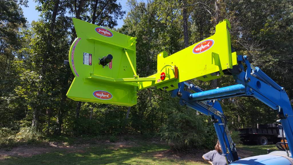

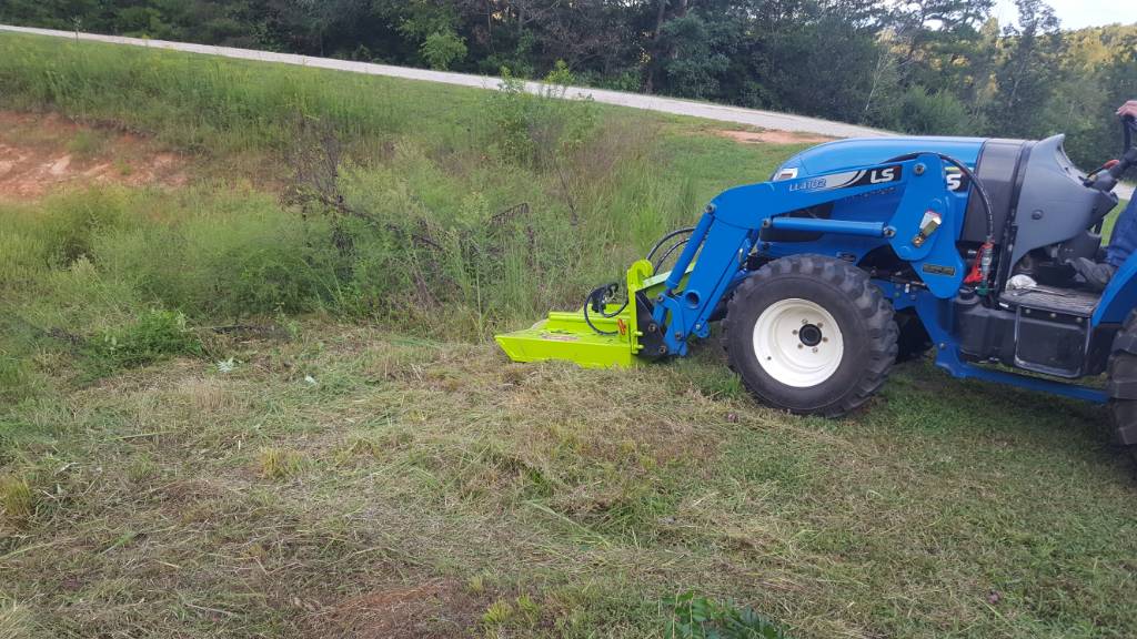

Yea it was easy to fix. Where the hinge was attached to a piece of angle, it had a slight twist. I was able to use a small hydraulic jack and push it back in line. Works fine now. When I get time I might weld a few small gusset plates to prevent this again. 20170908_140547.jpeg20170908_191053.jpeg

Thanks for that. Looks like it does a nice job too.
