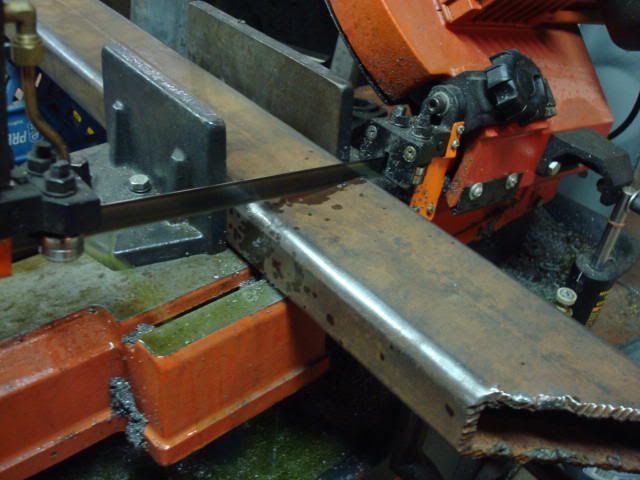

Two 45* angles were desired on the anvil business end. Two "V" blocks were stacked and clamped into the band saw, place the work piece bar on it's edge, clamp with a C clamp and proceed to cut down the length. As the blade neared the clamp, it was removed then placed above the blade so as to finish the cut......
The blade tracked perfectly square the entire 4" length of cut. The piece was then flipped over to cut the remaining 45* edge. A 1/4-20 hole was drilled and tapped into the center so as to retain the anvil in the anvil holder, which slips over the press stock anvil.
