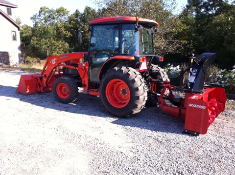

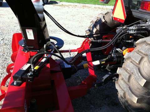

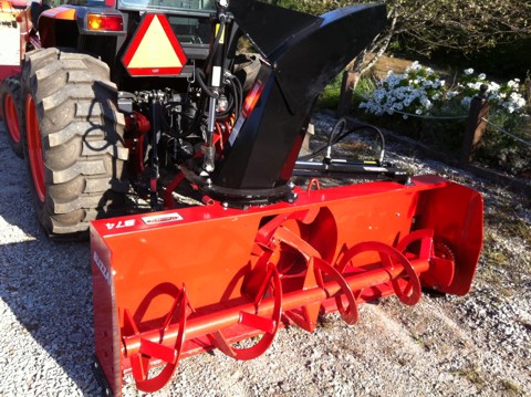

first landpride snowblower yesterday - very nice. Looks rock-solid. They weren't shipping at the time I placed my order and I didn't want to buy one sight-unseen so I ordered a Ber-Vac at the time. When I went to pick up my Ber-Vac yesterday I got a chance to see the LP and B-V side-by-side. While there are some differences between them, both are equally well-built attachments at about the same price.
They compared closely enough that it looked to me like a matter of availability and personal preference. I don't think you'd go wrong either way.
As to the B-V, I've added a couple of pics.
