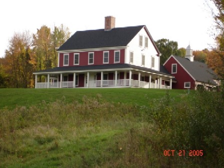

Looking for some advise. I have about an acre that I want to plant in the spring. It is old field that has grown up with grass, briars, and other things to about waist height. In the spring it is generally flat from the snow.
How do I prepare the land?
There is a lot of rich topsoil, up to 2' in many spots, but it is littered with bowling ball sized rocks that are either visible, barely visible or hidden by a skim of topsoil. Removing them all would be next to impossible.
My first thought was to try to plow it and then rake it. I think I will end up with a big mess this way and I really don't want a huge pile of weeds and stuff that I have to deal with. Also, I don't want to have to buy a middle buster, and a rake because I won't need them for anything else. A harrow would be nice, but again, I don't want a bunch of implements to clutter the garage and to spend the cash on.
Lately I have been thinking more about buying a tiller, however, I have to believe that I will destroy it when it finds these rocks.
I have attached a photo, in the foreground of the house, to the right is the area that I want to work.
Ideas?

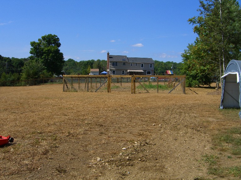

I own 5 acres in northern New Jersey with the same soil type. 3 1/2 acres are grass and 1 1/4 is a wildflower field. The house and a 40'x120' garden fills the rest.
First I killed everything with total vegetation killer - Roundup Pro, now it is called QuickPro (expensive stuff but is 1000 times superior to the Roundup you buy at Lowes or THD). I was able to buy it from a commercial landscape supply house.
To get the large rocks up I rented a L3130 with a 6'-0" C-tine cultivator. It did a fantastic job of pulling the rocks to the surface. Due to the shape of the tines it really does pull them to the surface. Once I felt that all the large rocks were up, I picked them up by hand or used the FEl bucket and then used my landscape rake to smooth it all out. I did end up renting a 5'-0" Woods power rake for my B7800 to redo half the grass area last year because I was unhappy with how the landscape rake left too many rocks.
I'll post pictures of the before and after when I get home tonight.

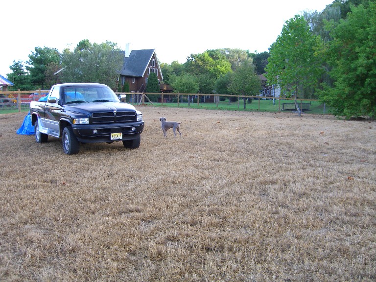

Below are the pictures that I promised to upload. I dont have pictures of when I used the C tine cultivator in the back, but it worked wonders pulling up the bolling ball sized rocks.
As for your questions about the pumkins and watermellons.. I always start my seeds inside under grow lights. Just follow the directions on the seed packet and you should be fine.

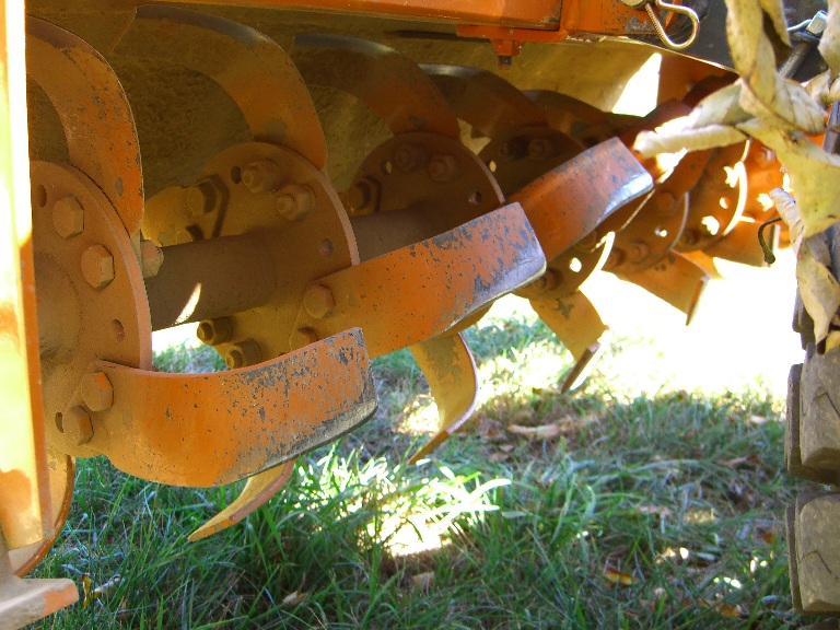

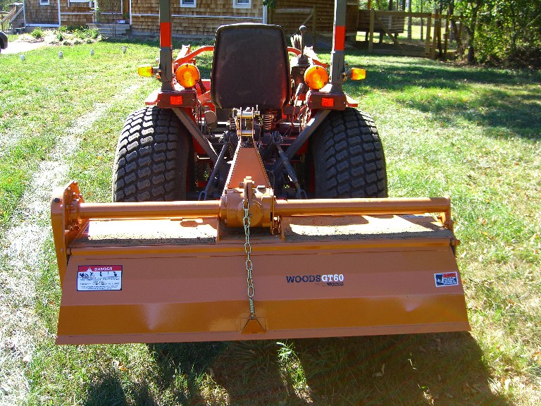

Keith,
Any decent C-tine cultivator (also called a spring cultivator) will do fine in hard packed clay. The one I rented was a 6'-0" unit by Landpride and I thought I was going to break the tines pulling up some of the 5 gallon bucket sized rocks, but it didn't. The only thing that happend was the backlash from the tine letting go threw dirt and smaller rocks at me.
I attached a few more picts. The first is to show how much the tines worn down after about 35-50 hours of tilling the front and the vegetable garden (not much!). 'Hardpacked' is when I started to till before realizing that it was going to damage my tiller and that is when I rented the C-tine. The last two are of my pride and joys until my human pride and joy is born.... 6 months to go....
