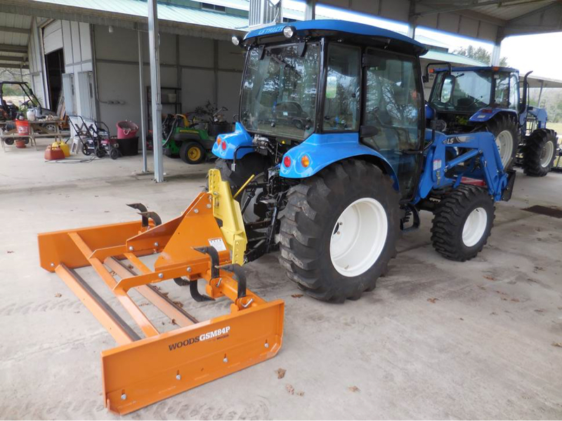

View attachment 417363View attachment 417364
I just got this unit after researching for months. For the same price you noted in your post I also got the rear gate option. It's called "The Bad Boy Grader" and is manufactured in Smithdale, MS. Probably too far away for you but there are other options out there. Good luck with your purchase!:cloud9:
Awww,, missed your chance. You should have posted a pic with the rear gate down. Not very many have that option. That would be at the top of my list of options.

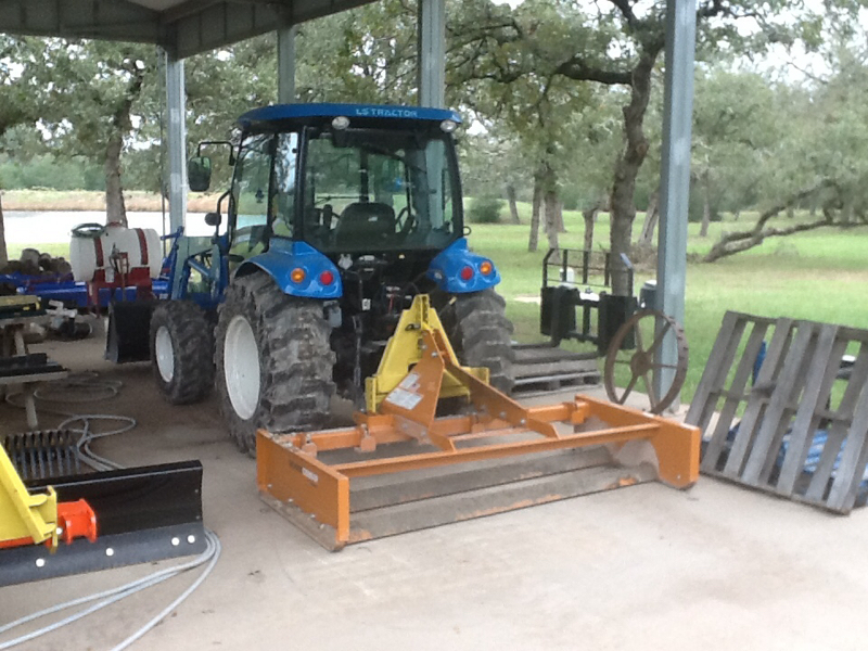

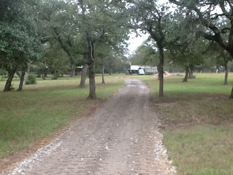

I bought the Woods 84" rear grader a few months ago and am very pleased with it.
I've started a new 300 yard driveway, between workshops and our horse barn, which was just a grass path. This spring, during the hard rains, about 100 yards of it washed out and became a river pointed at the overhead door on our big workshop. I used the Woods grader and my new Landpride 96" rear blade to level out the road bed.
Brought in two truck loads of crushed concrete for a base for the driveway and will get it packed down and then top with processed Post Oak rock. The Woods grader worked very we'll spread and level the crushed concrete.
Whatever you end up buying, I suggest you get one with scarifiers. You will spend a bit more but, they really help.
