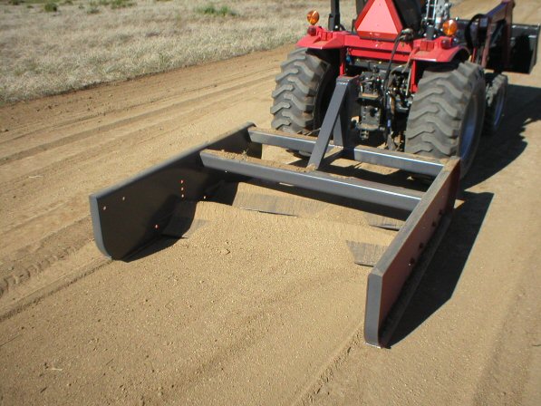

The Befco has 12" sides, the LP has 14" sides and the Woods has 16" sides. I prefer the 3pt mast attachment setup over either of the others. Of those 3, I would choose the Woods unit. I have found that with the type of ground that we have, the taller sides are a big benefit and I would not want to do without that feature alone let alone that I prefer that mast system over the others.

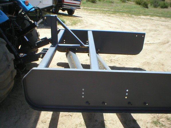

/ Land Pride, Woods, Befco Grading Scraper #5
My blades are angled 12* and the gravel-dirt migrates to the side less than 1" as it goes up and over the blade. Actually about 1" after it goes over both blades. It just does not move side ways all that much. ;)

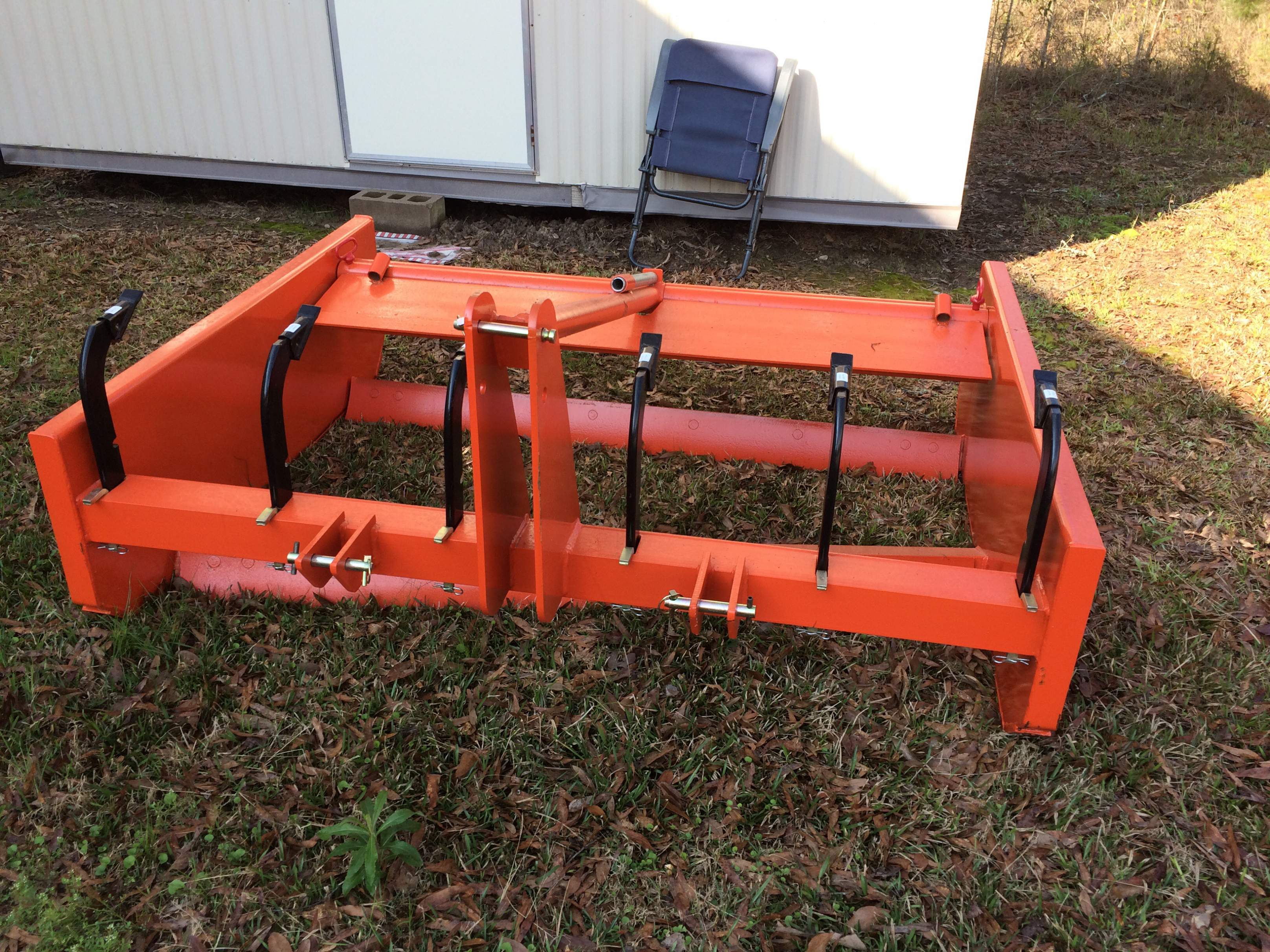

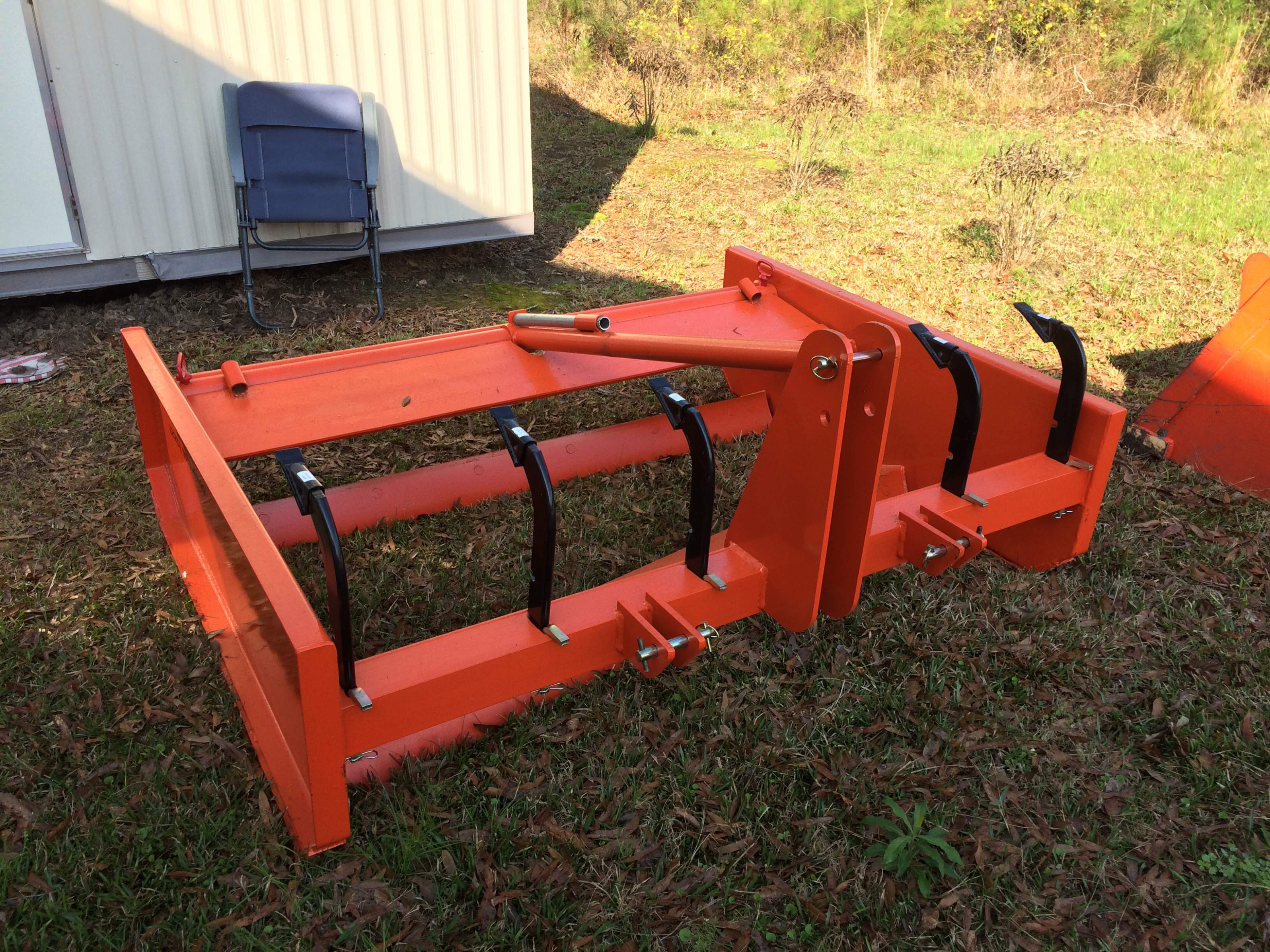

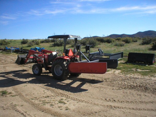

I just got this unit after researching for months. For the same price you noted in your post I also got the rear gate option. It's called "The Bad Boy Grader" and is manufactured in Smithdale, MS. Probably too far away for you but there are other options out there. Good luck with your purchase!:cloud9:

That looks pretty good to me. Besides the clean simple design with a top mast set up similar to Cammond a rural community such as Smithdale can use the jobs.
