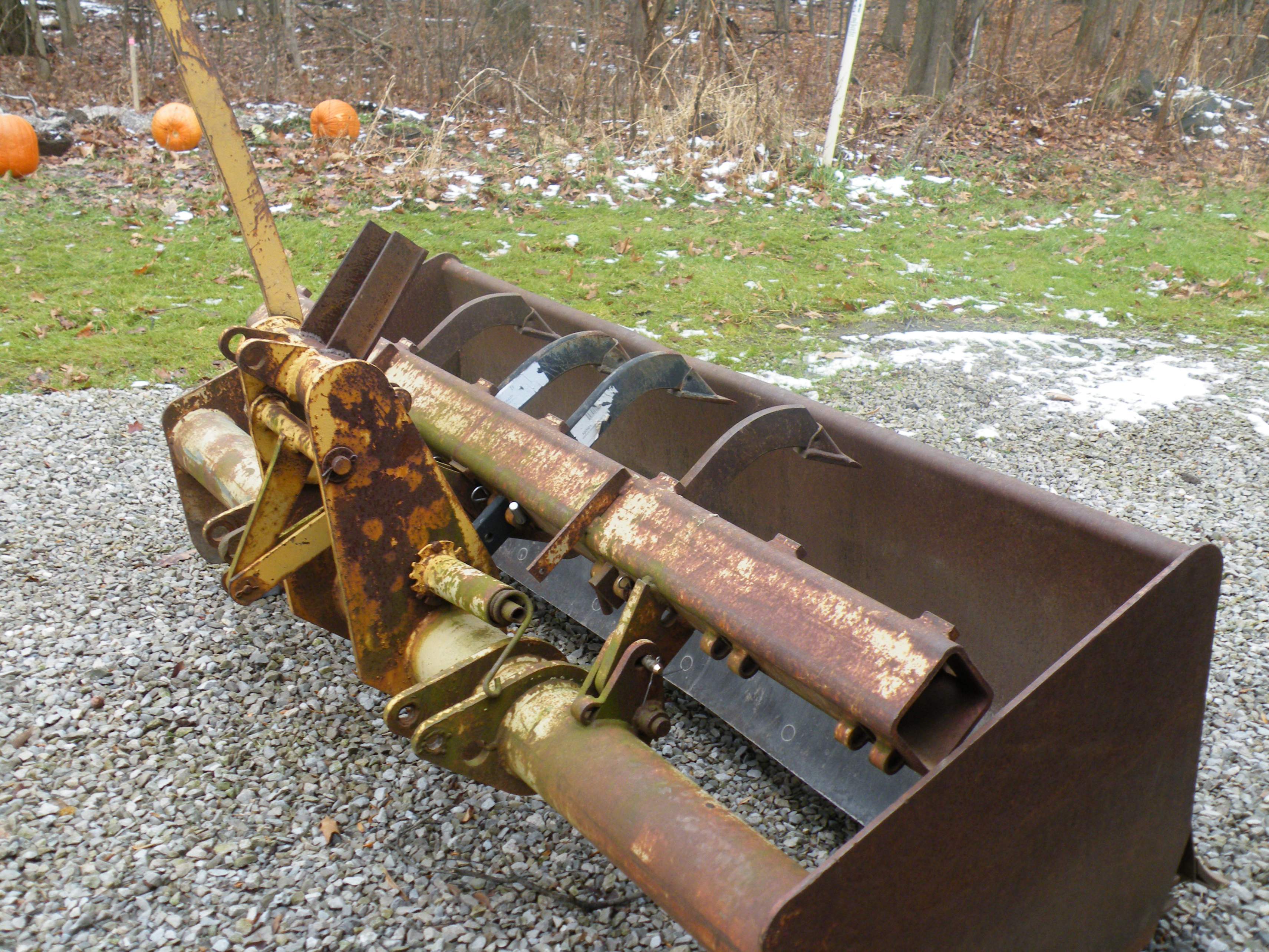

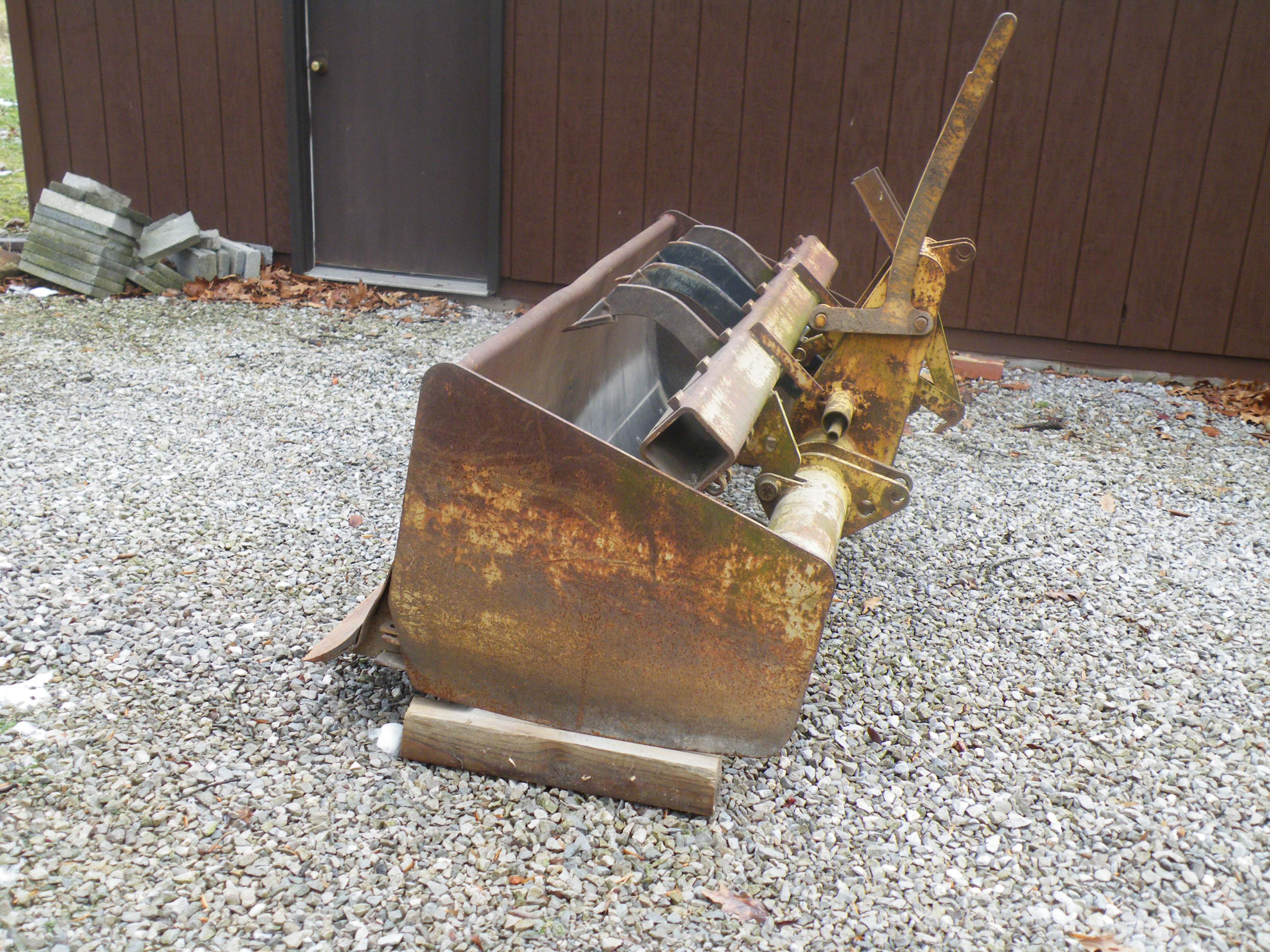

No, Thank you. I do have to go from Cat 2 to cat 3 on that Box Blade but it will need more work than that when I go Hydraulic this summer.
/ Land Pride Quick Hitch #70
No worries. Bump me when you start on that project. In the meantime I'll try to get some good pics. It was a ***** the way I went about it. I can save you a lot of work and hassle converting yours. Don't remove anything before you talk to me. You'll retain the torsion spring system.
/ Land Pride Quick Hitch #71
I need to rebuild the spring system too.
Let me brainstorm a little Murph. I found a parts manual online somewhere but can't remember where. It's handy to have.
