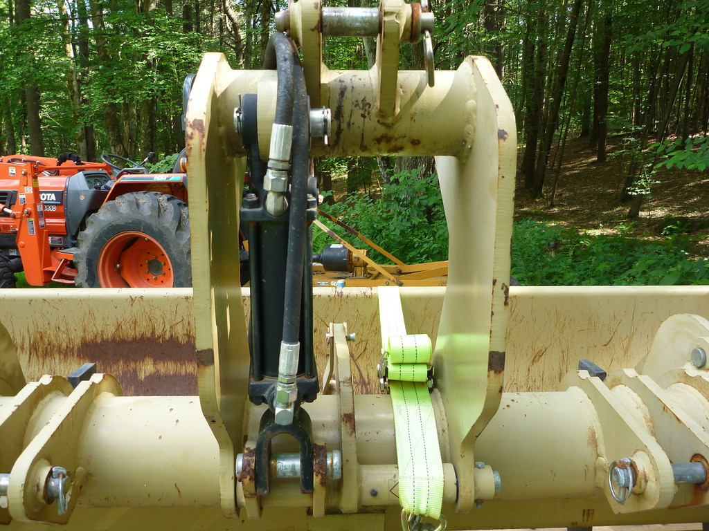

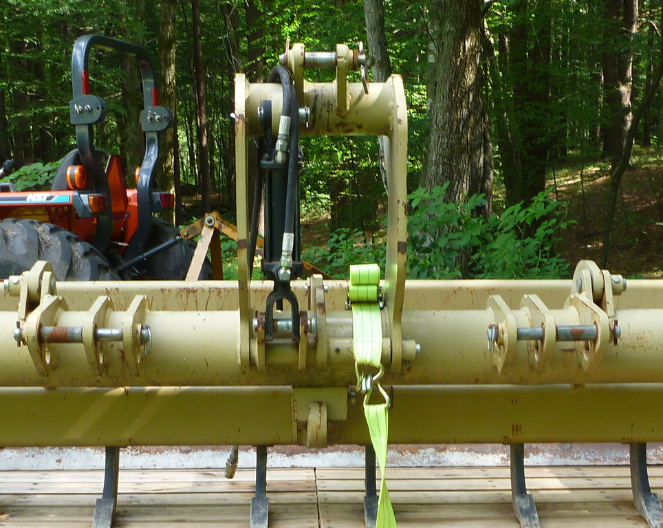

I went though every attachment and set them up so that they would all fit right. I even had to make an upper extension bracket on one of them so it would clear. I then made 3/4" treated plywood benches and block setups so that they all had a place to be parked. my grapple, bucket, and forks had to be set up higher so that I could see over the hood to make quick attach hookup. I have added cameras front and rear so I can see down low, like the pallet forks, now I can actually see the tips of the forks going into a pallet. I can also get a good look at the pto shaft on the back without twisting my neck out shape.
