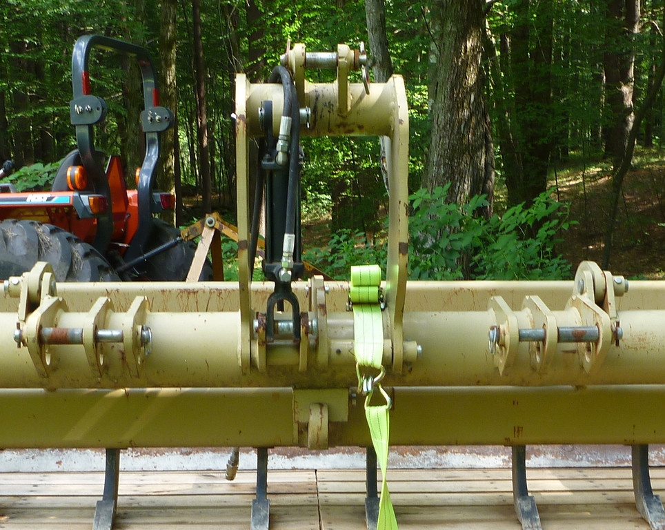

Piston, I've got a LP box blade MR3584 that I modified into a hydraulic raise. I had to modify the top link to make it work on my QH. It's sitting down at the farm. Next time I'm down there I'll get pics. The problem was the QH hook would hit the hydraulic cylinder when trying to hook up. I've also got an old Rhino 3pt blade there that I modified to fit QH, I'll pic it also.

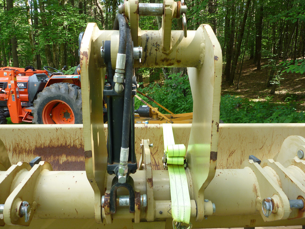

Thanks Richard, I appreciate it. The pics should help.
Here are a few pics of how my cylinder is hooked up. I wonder if I'd have the same problem?

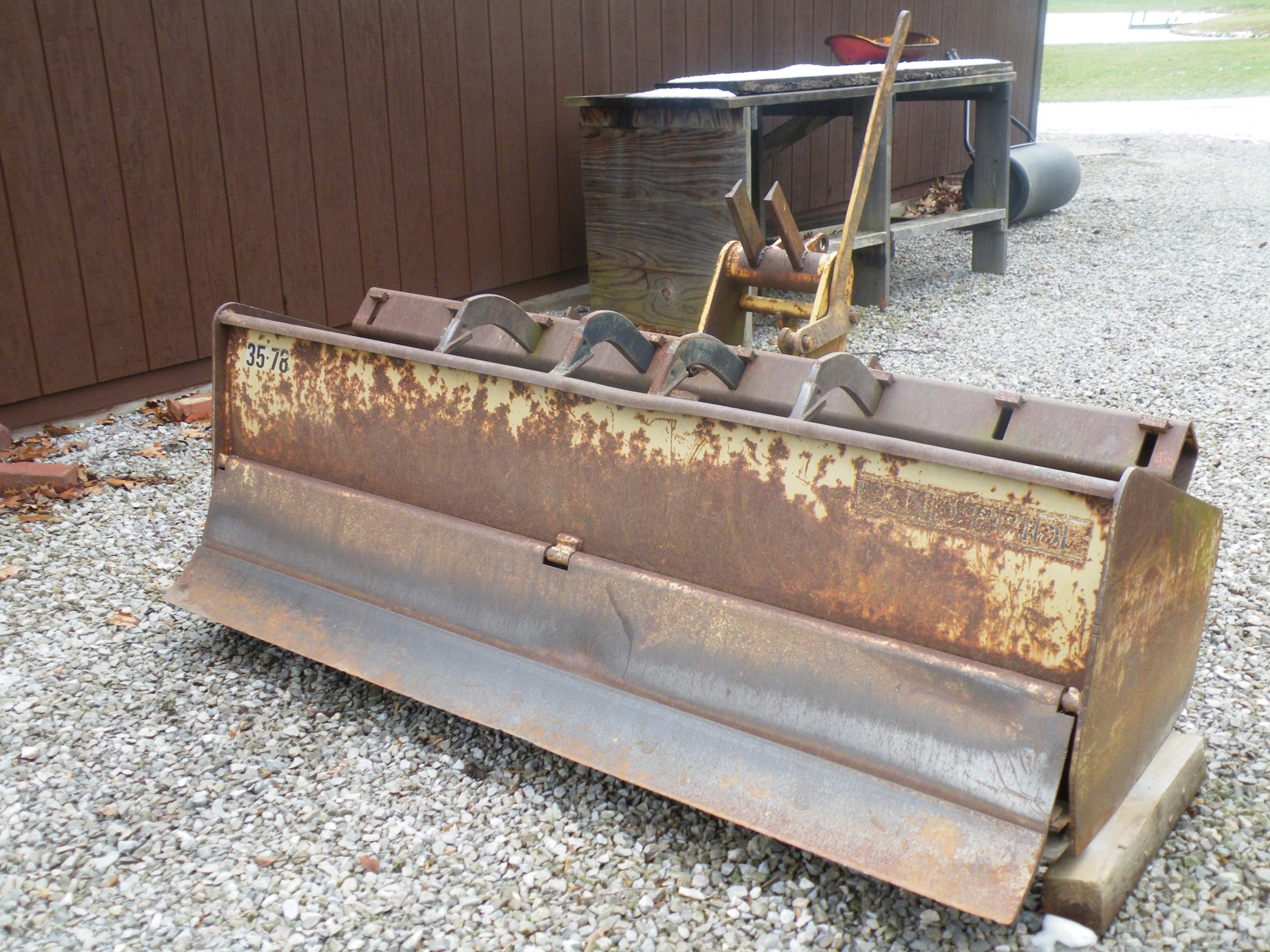

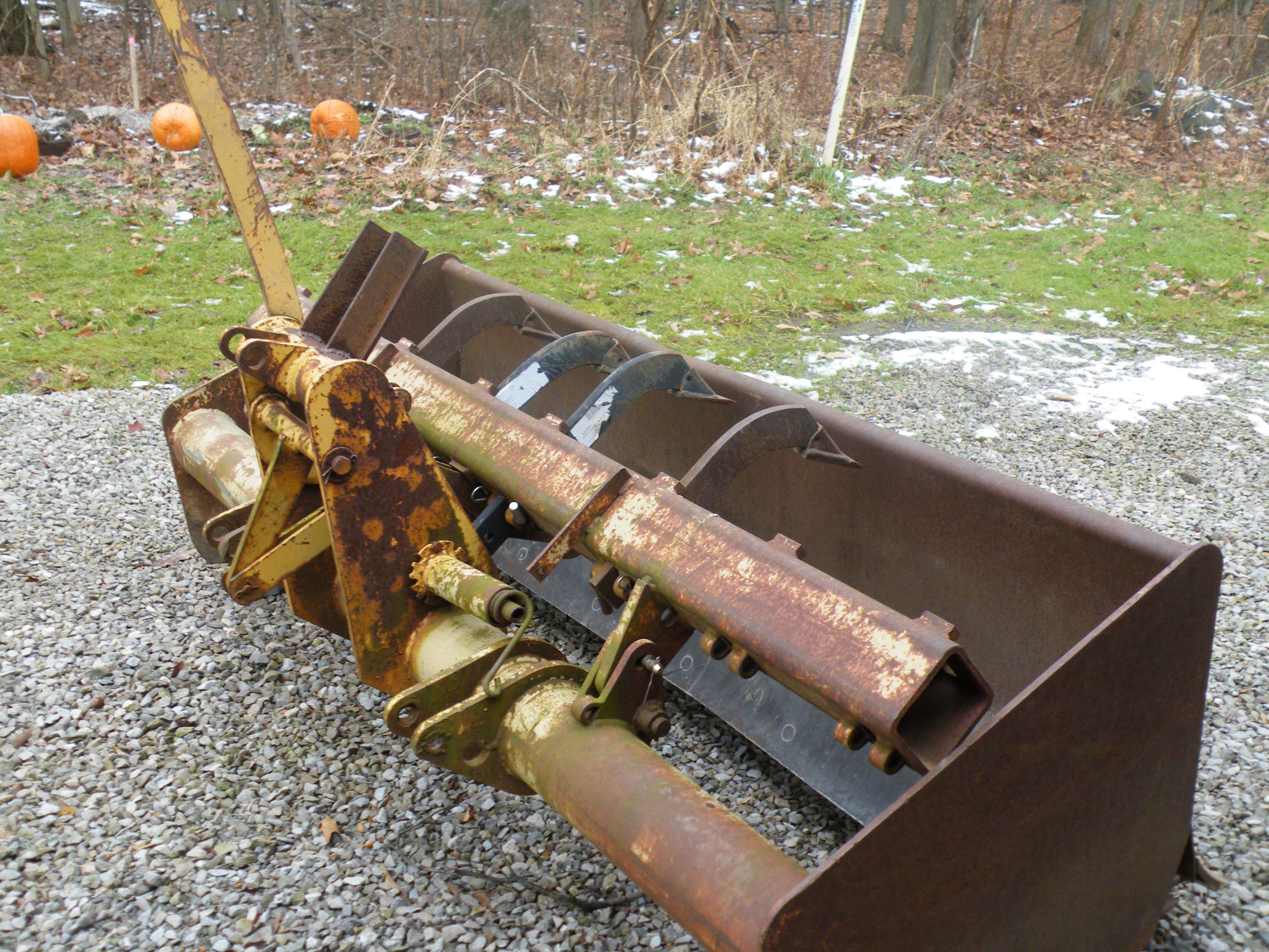

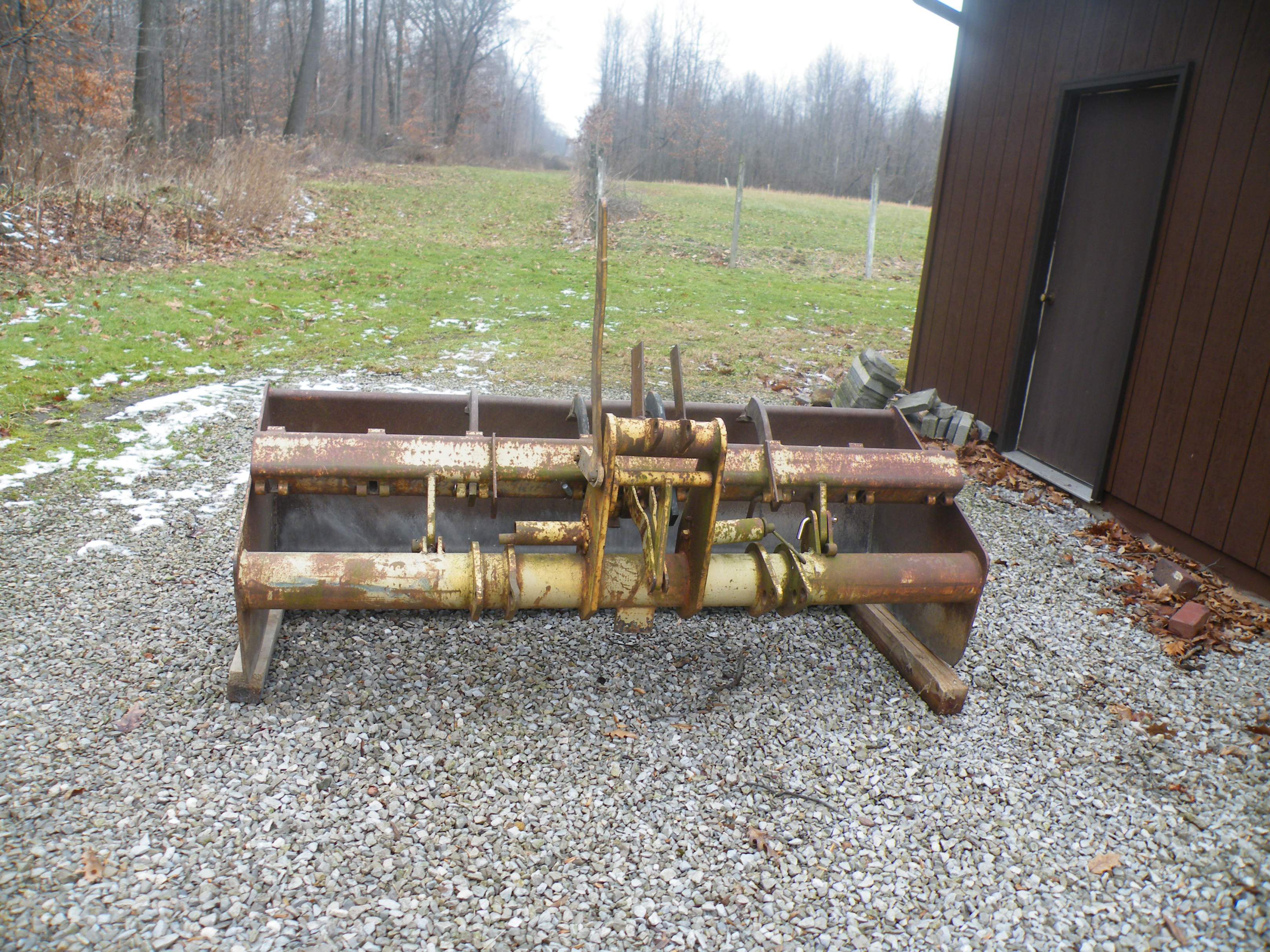

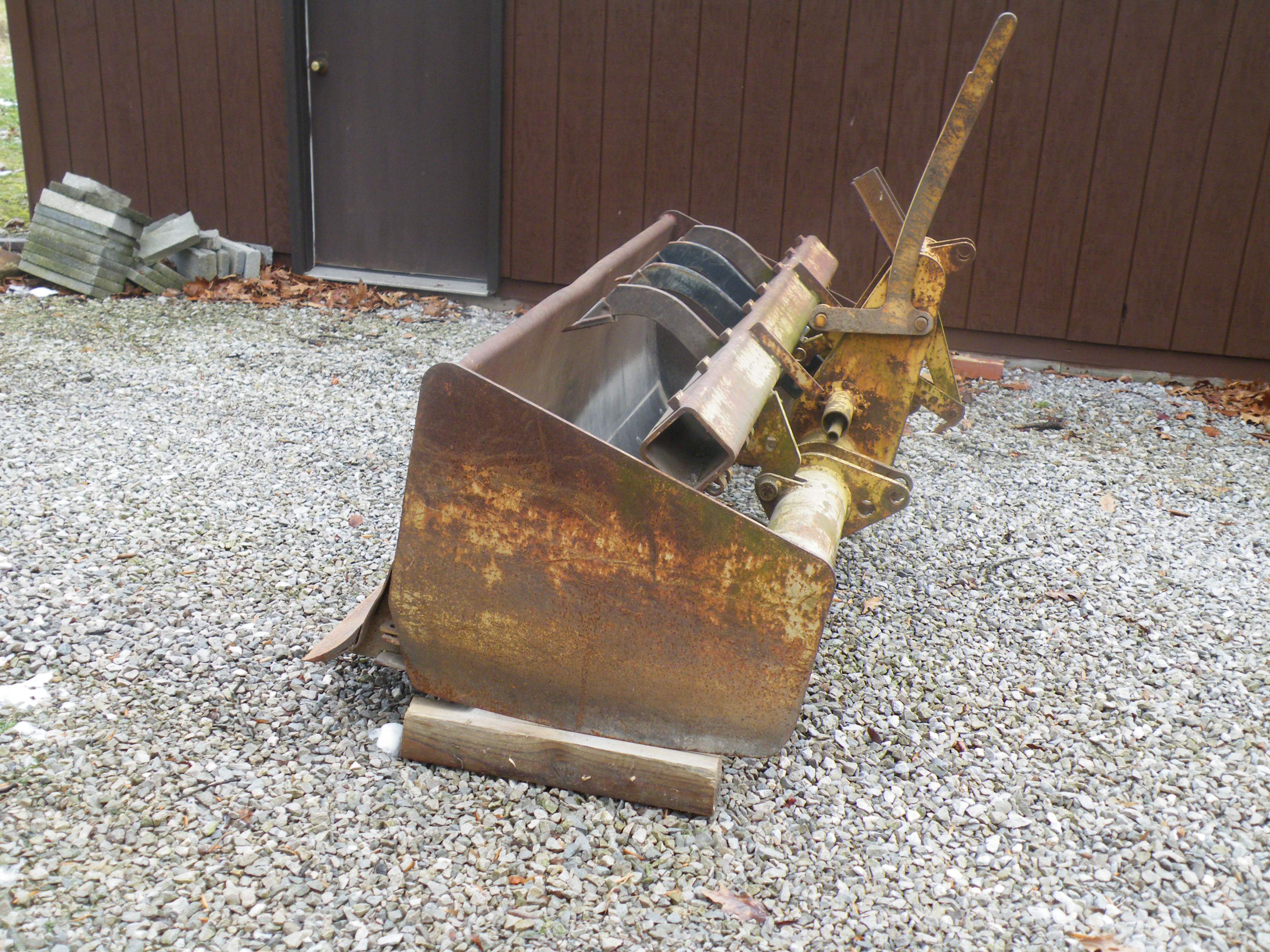

I would like to see some pictures of your 3584 as I picked up a 3578 that needs some work and a Hydraulic system installed.

Yep, you've got what I started with except mines 6" wider. I'll try to get pics today when I go to the farm.

View attachment 353885 View attachment 353886
Your top pin holding the hydraulic will need to be secured so that it will not migrate towards the center. A few washers on the left side should take care of that though. ;)
