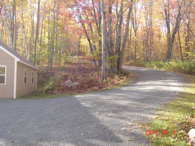

Pic's of the one I built last year . 7' wide x 7' + long pulled behind a New Holland TC 30 HST with loader . Driveway is 800' + feet with at least 1/3 being a grade of 7 to 8 % . Crushed Shale , ( not 3/4 minus river rock but actual crushed shale ) is our road base . Blades are just 1/2" x 6" flat stock that I beveled on the lead edge with plasma cutter . They are attached to 3/8" 3"x3" angle that is welded 1/2" above the bottom of side skids . Slots in blades allow for 0" to 3" cutting , but 1/4" to 1/2" is really all I needed . Pictures were taken before I added additional cross braces , beveling blades , and something else I did (???? ) , But dang thing works and tractor pulls it great .

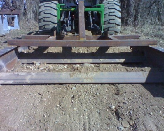

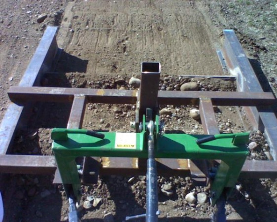

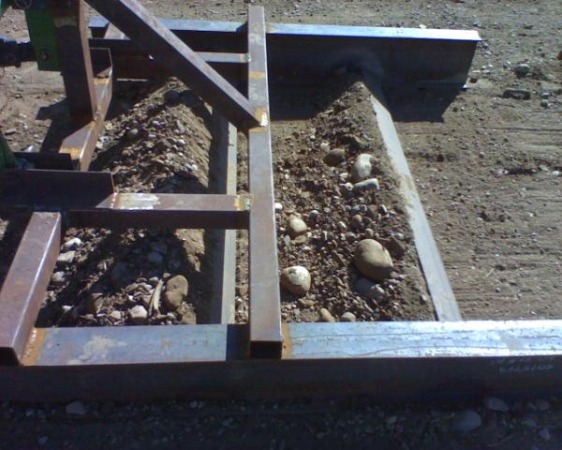

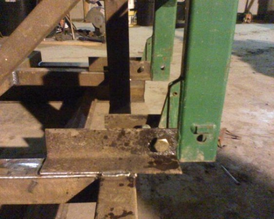

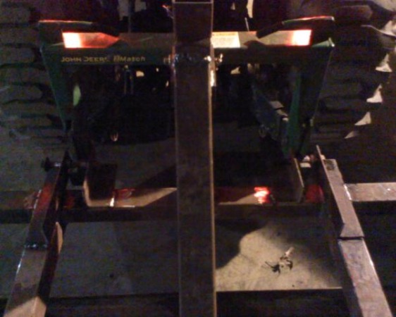

well here's today's build progress, went and borrowed a plasma cutter and wow does that do a heck of a good job. going to go hunt down some cutting edges tomorrow, a local welding shop is big into handling plows and he always has a little of everything. but im just going to do a happy medium and go half an inch below the skids and later down the road build something else for it. but in really dreading drilling that 1/2 angle iron for the bolts. i just got the two pieces of tubing welded on before i ran out of gas for the welder :eek: should have looked before i started. should get more done tomorrow. :)

/ Land Pride grading scraper #245
If you borrowed the plasma cutter once , try again . Rather than drilling , plasma torch will blow threw your holes in just a few minutes . I did all my holes and slots in blades with-out pre-drilling . Just hold torch at a slight angle pointed away from you and squeeze the trigger . Took less than 2 seconds to blow threw 1/2" plate . Sure hole will not be perfectly round , but mine are pretty close for farm implements .

/ Land Pride grading scraper #247
Looks like you are off to a good start.:thumbsup:
If you are not planning on rolling the ends as I did then recognize that you will need to put stiffeners in from flange to flange. I rolled the ends of my skids because that makes them ride over the ground better and also makes the flanges stiff.

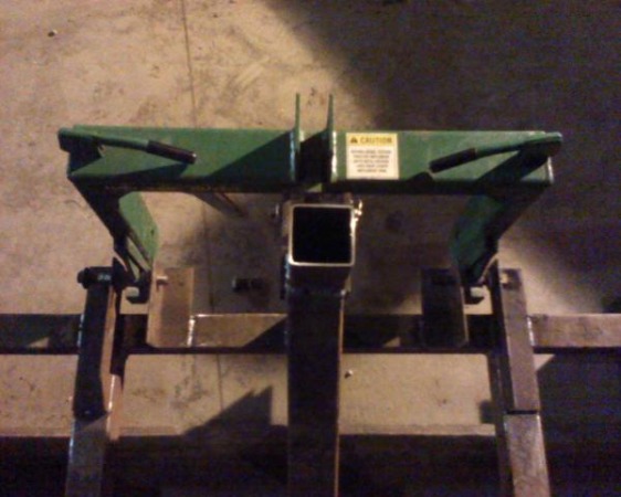

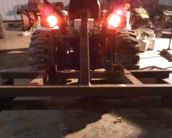

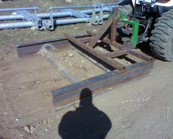

Looks like you struck out pretty good jenkinsph! I did get some more done on my landplane today, had to do parts errands today so didn't have time to stop to get a couple plow edges. also have to get a new 7/8 drill bit as I broke one in about 10 seconds. Should have it hooked up to the tractor tomorrow, then just have to make the rounded skids, finish the blades holes and weld on the blade support! The last picture is how I cut the upright for the toplink to keep it from breaking the weld, but it's all taking shape now!

/ Land Pride grading scraper #252
Looks good:thumbsup: Are you going to set the blades straight or angled.
Also do you see using it primarily for driveway work or land leveling?
/ Land Pride grading scraper #253
Thank you! I can't wait to see your "mini" landplane, I am setting them straight. In the picture there are just setting in it and won't be at that angle. It will be mostly for driveways and irrigation lanes but also for the big parking areas that are uneven and potholed. On occasion it will be used for smoothing and finishing new yards, also we do new orchards, plant grass, and trees. So this will be very interesting on how it works this summer.

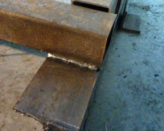

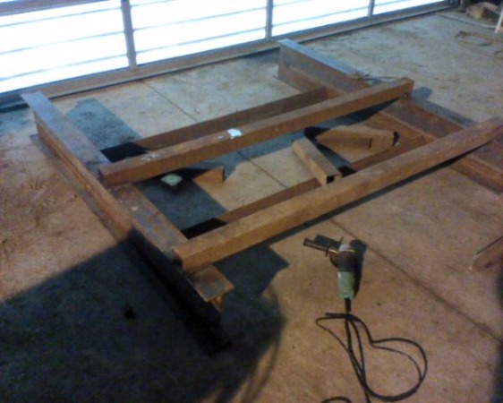

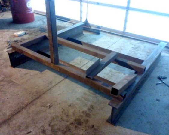

stopped at the plow dealer today he only had 1 cutting edge so i got that (which when i got home i cant use it), and then he asked how about some 3/8 hardened steel. so i got that to 3/8 x 3 x 64 1/2. perfect then got some 1/4 x 4 x 64 1/2 hardened steel. also got 20 plow bolts and nuts. then he said take it! no charge. its scrap anyway. all he said was to just keep buying snow plows from him! so i'm pretty happy :D .Now all i got welded up today was the hitch, was welding the top link on didn't realize one of the flat pieces got welded crooked but hey it works, going to pick up actual pins tomorrow (used bolts today). All i have in this right now is only a whopping $15 :thumbsup: as for the blades im going to to put the 3/8 on front and the 1/4 on back with straight blades and 1/2 deep! should have this working this weekend and with some better pictures.
