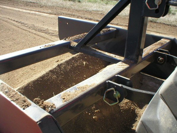

Yeah, that's one thing to clarify: Tractors don't seem to be intended to do any serious pushing in reverse. I broke mine doing that (http://www.tractorbynet.com/forums/owning-operating/204404-ok-push-trees-over-box.html). It seems they can handle some light pushing of loose material, but anything more & you risk breaking your 3 point hitch.

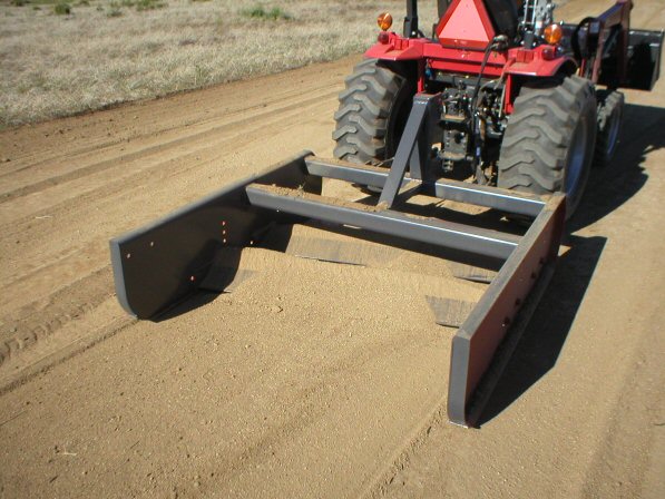

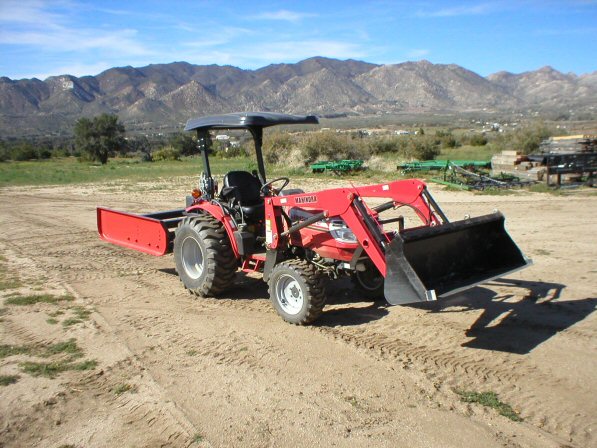

A LOT has to do with the size of the tractor. I have had zero problems with mine and that is going in reverse in virgin soil.
