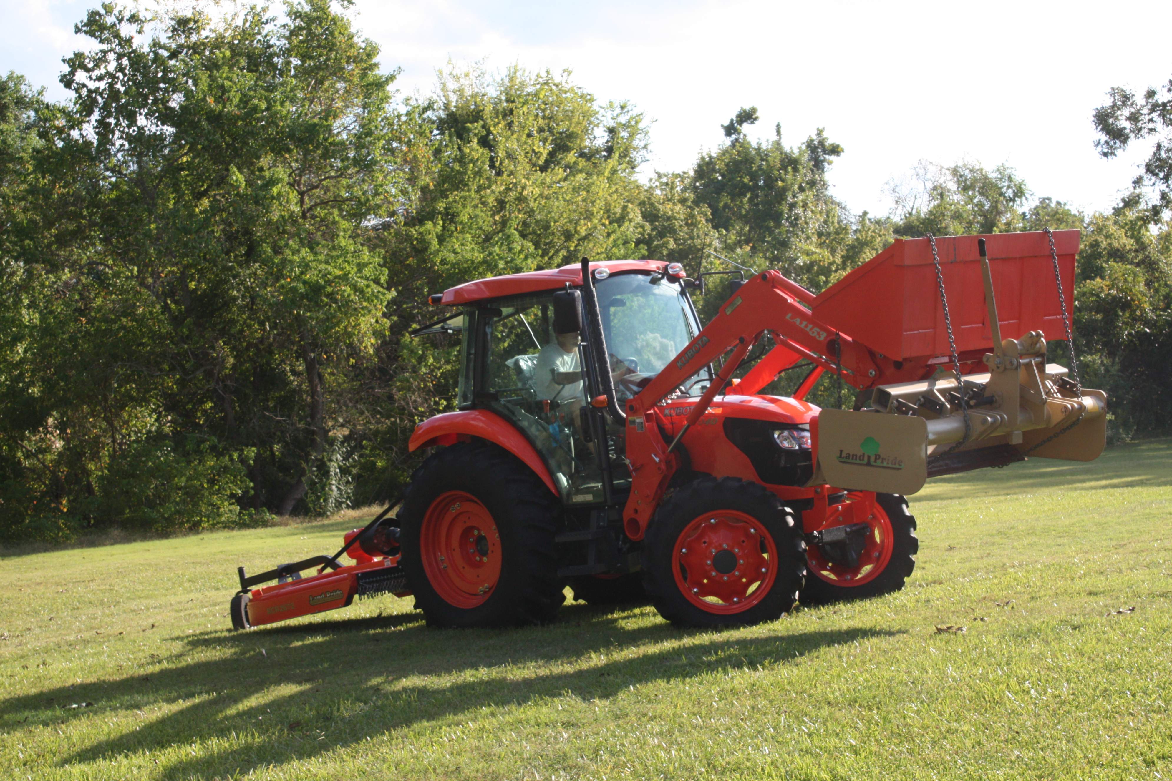

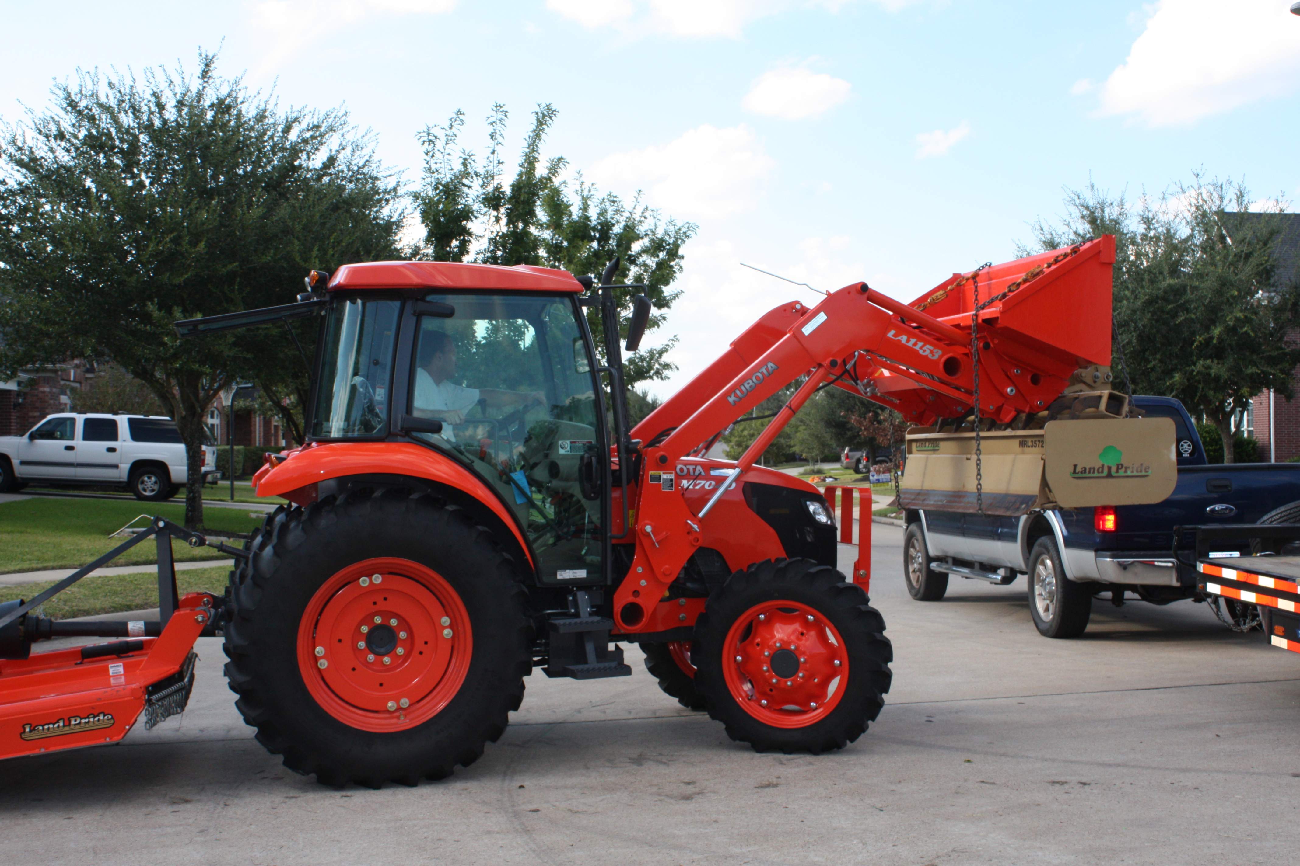

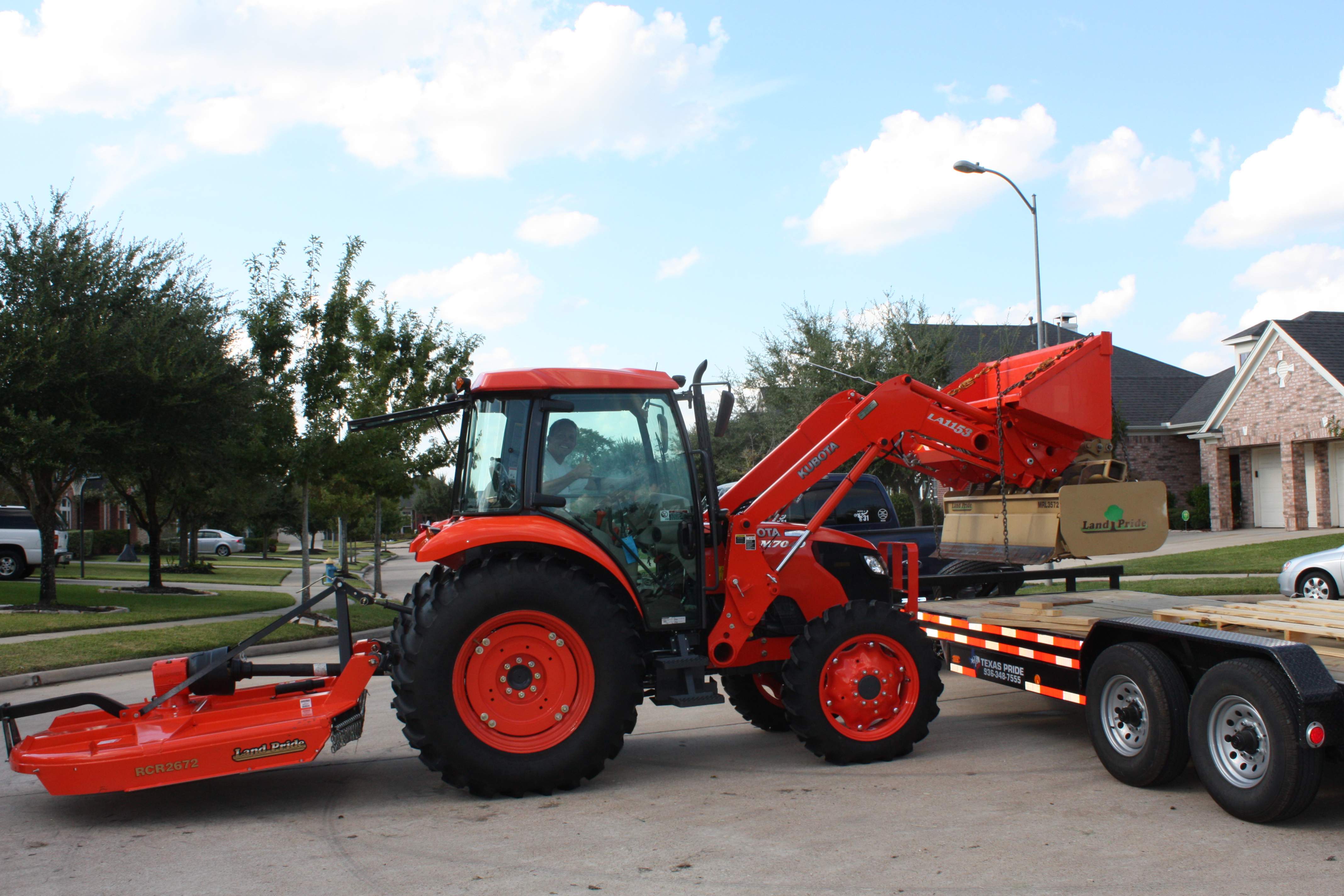

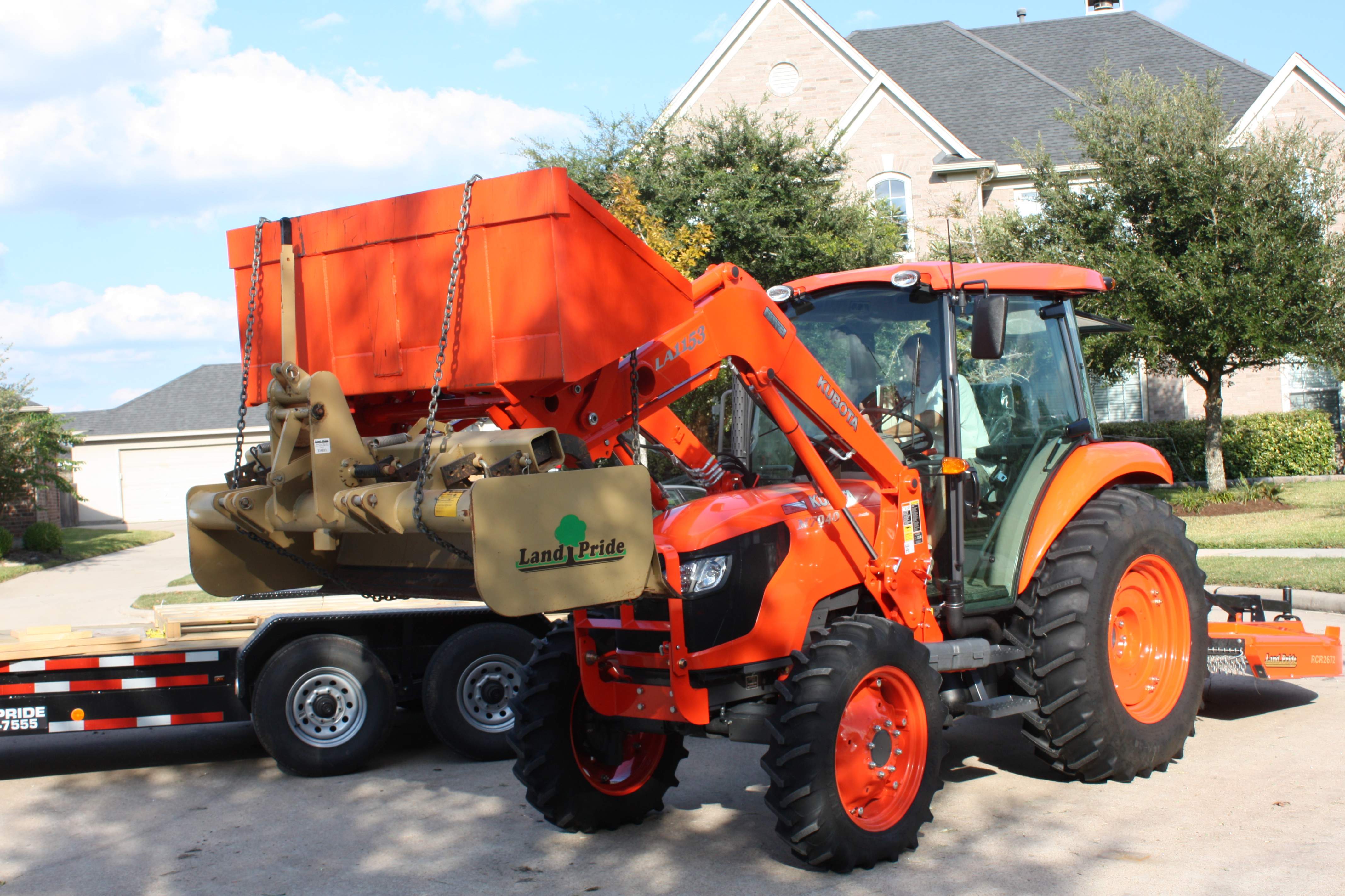

I built a landplane/grader in 2009 because of this very thread and built mine to plane and smooth out lawn areas. It also smoothes the occasional driveway with ease too. Mine weighs about 950 lbs. and has 8' blades set straight which are attached to heavy duty frames that are very ridgid. Cost with new blades and all hardware was about $900. This was a simple build compared to some things so is worth considering as a build your own project.
If I were to do it again or buy one straight up I recommend adjustable blade height independent each side, adjustable angle to aid in crowning, hydraulic rippers such as on a Gannon box blade and longer skids. This would greatly increase the cost but would limit the number of tools needed for maintaining most driveways and farm roads. Sounds like this is what you need to have for commercial work imo.
Here is a pic of the one I built for lawn leveling and pics of the results on my lawn area and a customers. It also works well for most driveway work too.

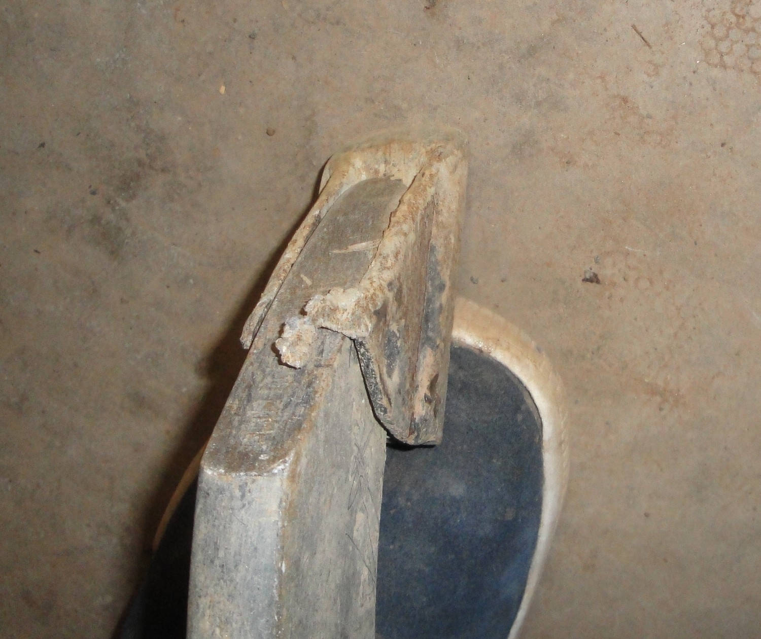

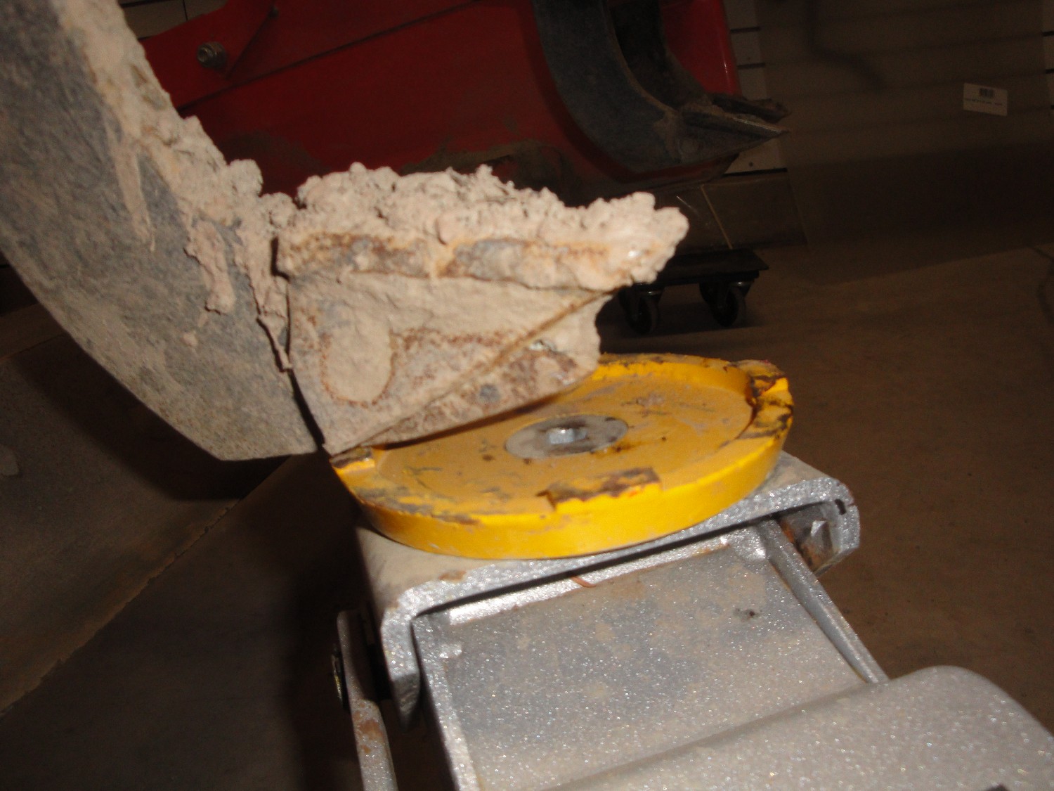

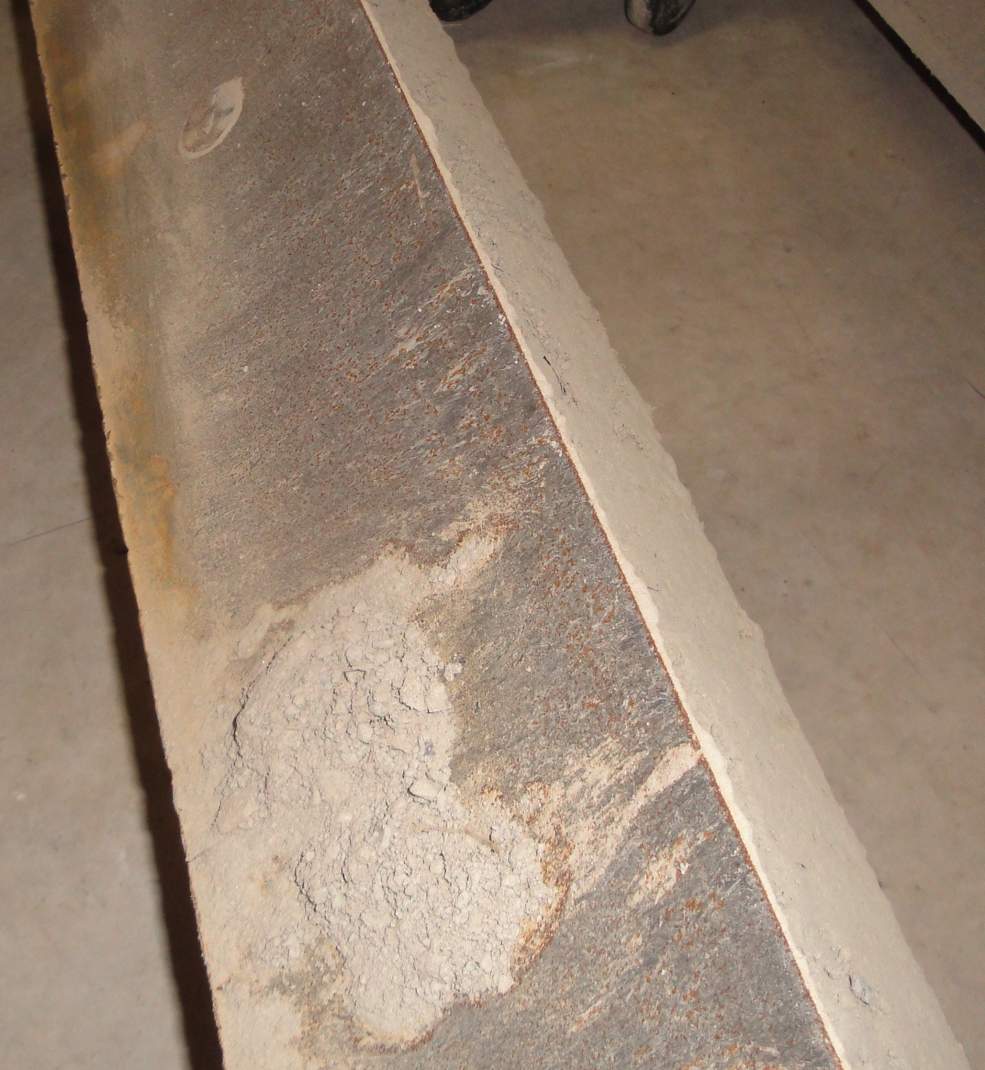

I see there have been a few comments regarding my post outlining, what I considered, abnormal wear on the blade and teeth of the landpride. Six months and approx 15-18 hours of grader use has accumulated since my previous post on wear so I'll update with photos. The blade is slightly worse for wear with more nicks than I reported back in May but the teeth haven't fared well. The last time I graded a few weeks ago I noticed two of the scarifier tips had rotated upwards on the shank rendering them useless. Further inspection has shown the bottom of tips have completely worn off allowig the tip to swivel around the dimple. The tips themselves have worn down considerably as well therefore all four require replacement.
I'm still estatic with the gader and the wonderful job it does grading roads/driveways but I'm less than impressed with the blade and teeth wear. My previous cheap-***** boxblade had considerably more hours on it with hardly a hint of wear on the blade or teeth so, in my opinion, Landpride has cheaped out on the wear items or perhaps inadvertantly sourced some questionable quality steel parts for the wear items.
Anyone know a good source for good quality scarifier tips?
About any agricultural dealer will have the shank tips available that are a friction fit and just need to be driven on with a 5 pound hammer. I had forgotten that one of mine came off when it was new. The replacement tip was $13. My dealer told me that the tips themselves are meant to be "sacrificial" and pull off if a large object is hit to preserve the more expensive scarifier shank. BTW, I only drop the scarifiers when I'm trying to pull up the base to help repair pot holes. 90% of the time my scarifiers are up and not getting any wear.
/ Land Pride grading scraper #191
I was just leafing through the owners manual and they have the tips listed, a "normal" tip and an optional "wide flare" tip with part#'s. I use the shanks often. the gravel gets hard enough packed that the blades just skim across the top and takes way too many passes to pick up enough gravel to spread properly. I also find there are more fines an inch below the surface than near the top which the scarifiers bring to the surface that can then get re-mixed and provides a much better closer to class-a spec mix than just the top 1/4-1/2 inch layer does. Unless the gravel is soft I always use the shanks first then raise them for the grading. Another benefit of using the scarifiers is that they provide a multitude of channels parallel to the road which any standing water will congregate lengthwise which seems to help prevent potholes in areas with less than optimal slope.
Not only do break-away tips prevent shank damage but they also prevent damage to the shank support tubes.
