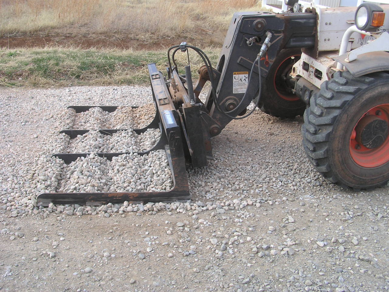

   / Land Plane #12

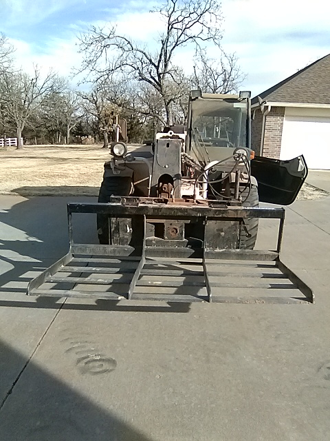

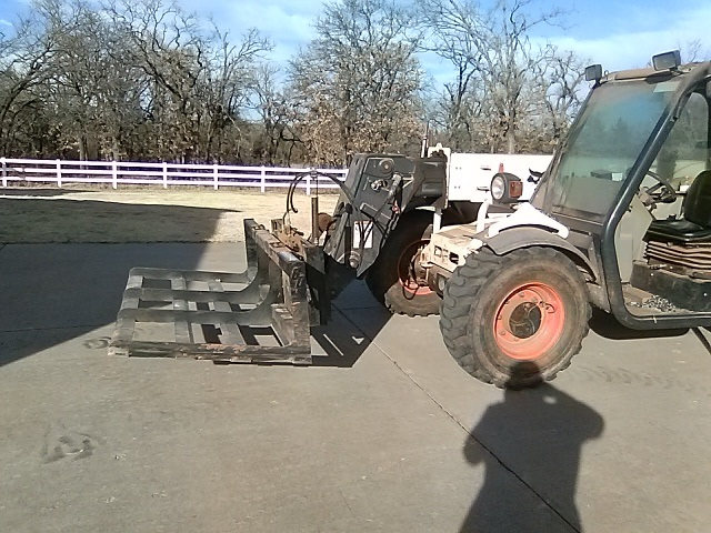

I use mine quite often. It's one I built. Can't beat it for leveling drives, etc.
Nice build!!!! I've considered building one for several years but have very limited need. I think they are the best tool for driveway routine maintenance.
If you built another one would you do the opposing blade method again?

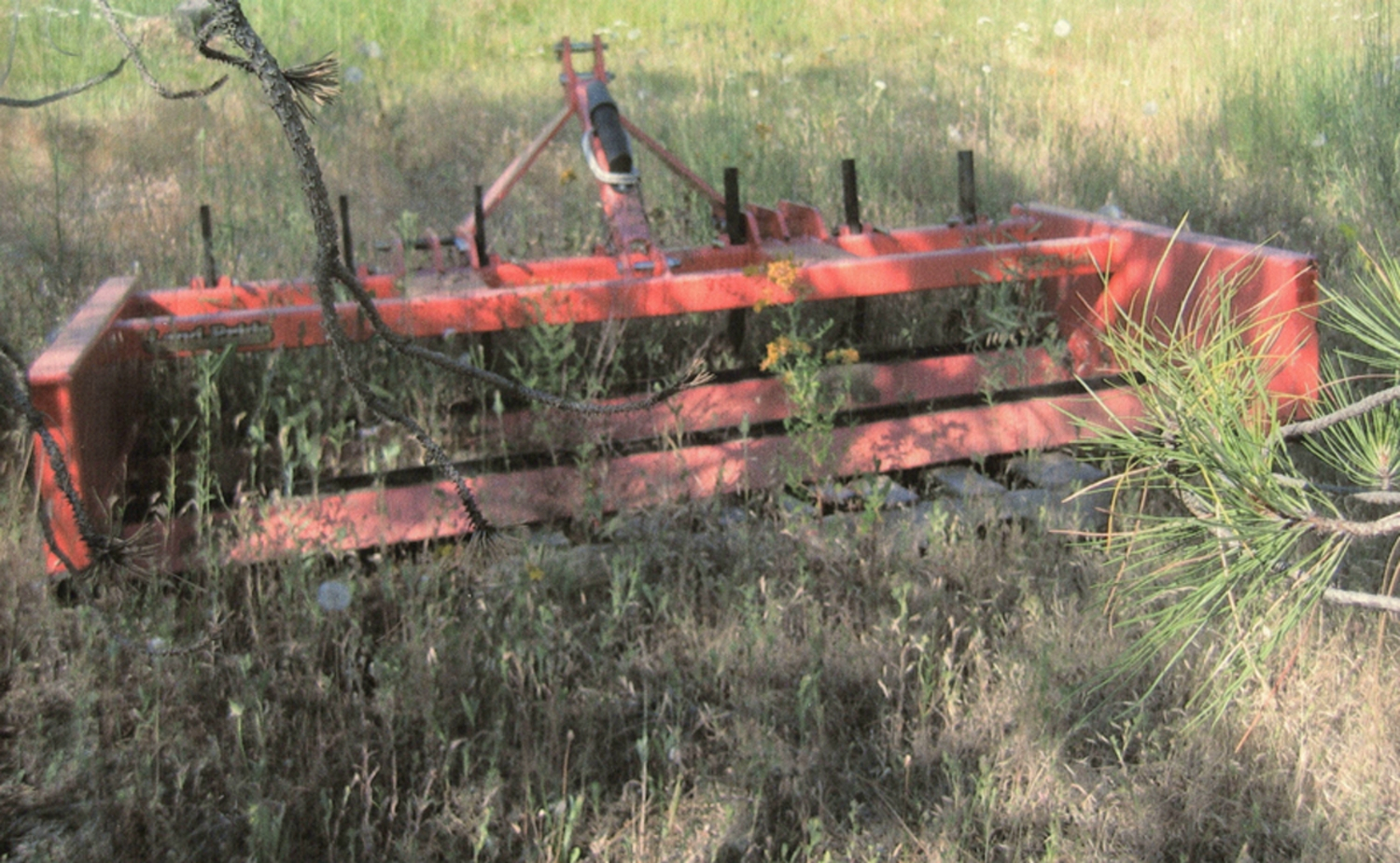

I don't think I will EVER get good enough with my rear blade to equal what my land plane grading scraper can do.
Unfortunately - each implement ( land plane grading scraper vs rear blade ) is best for specific jobs. The LPGS will smooth a driveway - like a babies butt. Mine has scarifiers - so I can easily get rid of potholes and the like. However - it won't do much else.
A rear blade is a truly multi-use implement. Grade material up out of the ditches - spread it across the driving surface - reverse & drag for a truly smooth surface. But it's not really the implement to repair potholes and the like.
If you get a rear blade - look for one that will offset - angle - tilt.
My LPGS is out in the weeds and between some of my smaller pines. It's "day in the sun" is rapidly approaching.
   / Land Plane #15
Absolutely. No question. There's no other way to build one in my opinion.

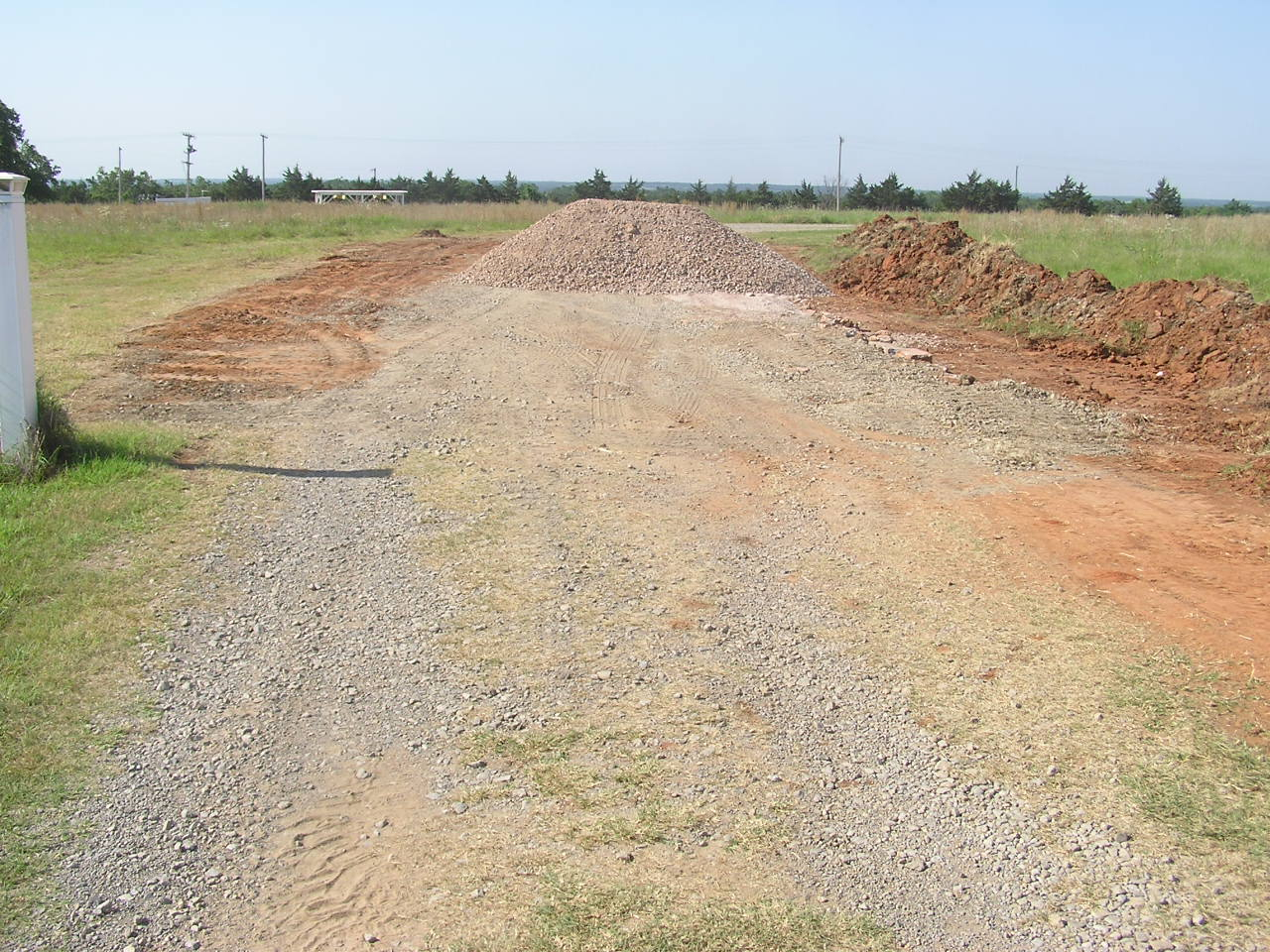

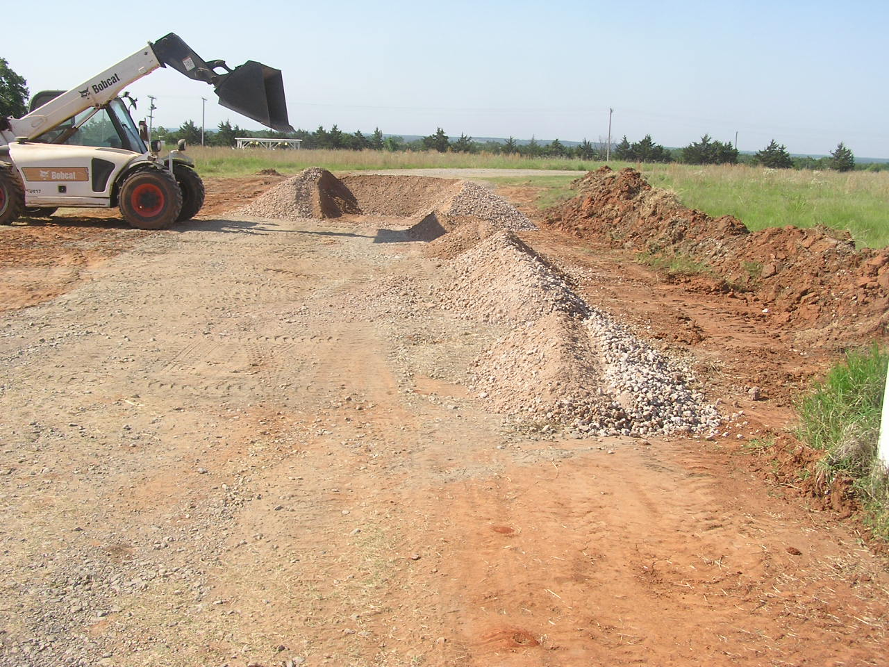

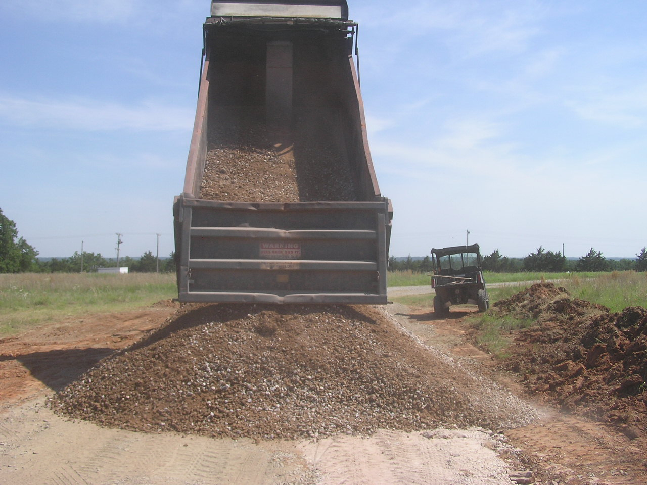

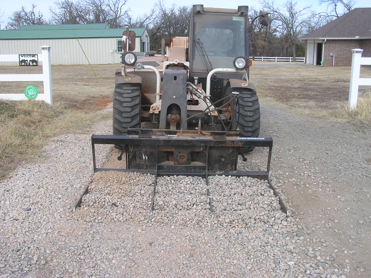

14 tons of crushed concrete, cheaper than gravel:
