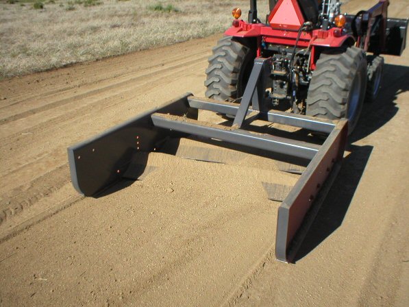

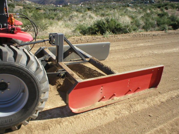

10-15 degree angle is typical as is a 20"-24" spacing. Don't count on moving material side-side. It just does not do it more than an inch or so. They are great implements though, I have two of them. A 5 footer at 800lbs and a 7 footer at 1400lbs.

Material doesnt move side to side. The angled blades help to prevent the whole blade from jumping or stalling when hitting a bump (washboard). That way only part of the blade is hitting the lump at any one time, increasing its cutting power.
Which basically means angle isnt that important.
The longer your LPGS is & the further apart the blades are the smoother it tries to make things. Essentially the same reason a road grader is so long. It averages any bumps out across the length of the machine.

I have a Land Pride - land plane grading scraper - LPGS. Its the GS2584 - 84" wide & 800 pounds. There are two down turned angle irons( 7/16" thick - 3"x3") with a reversible 1/2" thick by 6" tall blade bolted on each angle. These go across the unit at a 5 degree angle and are separated by 20" between blades.
Like Brian - and everybody who has used a LPGS has said - the unit WILL NOT move material horizontally.
This unit does a great job of smoothing. It has a zero learning curve - - hook it up - pull it.
