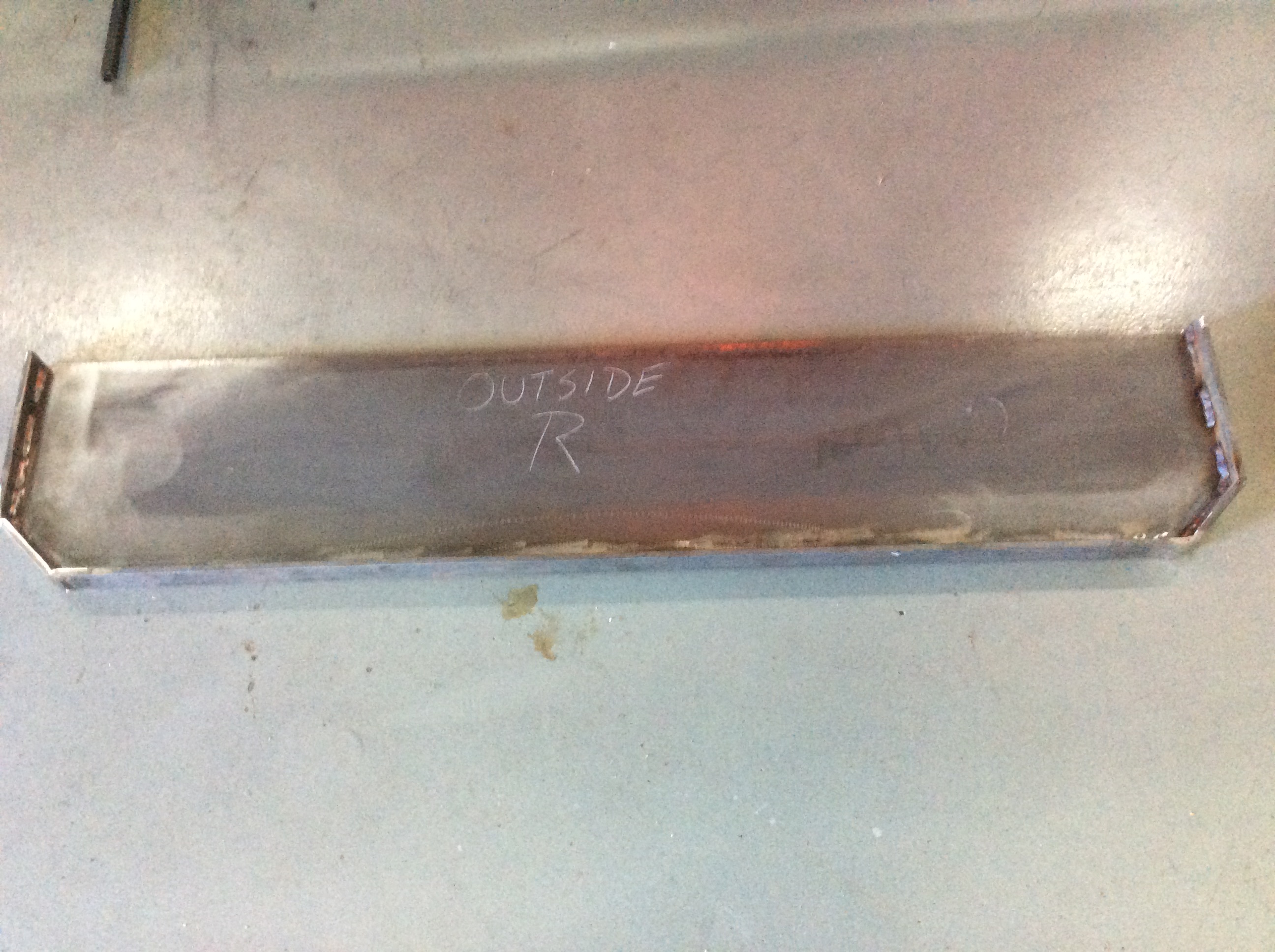

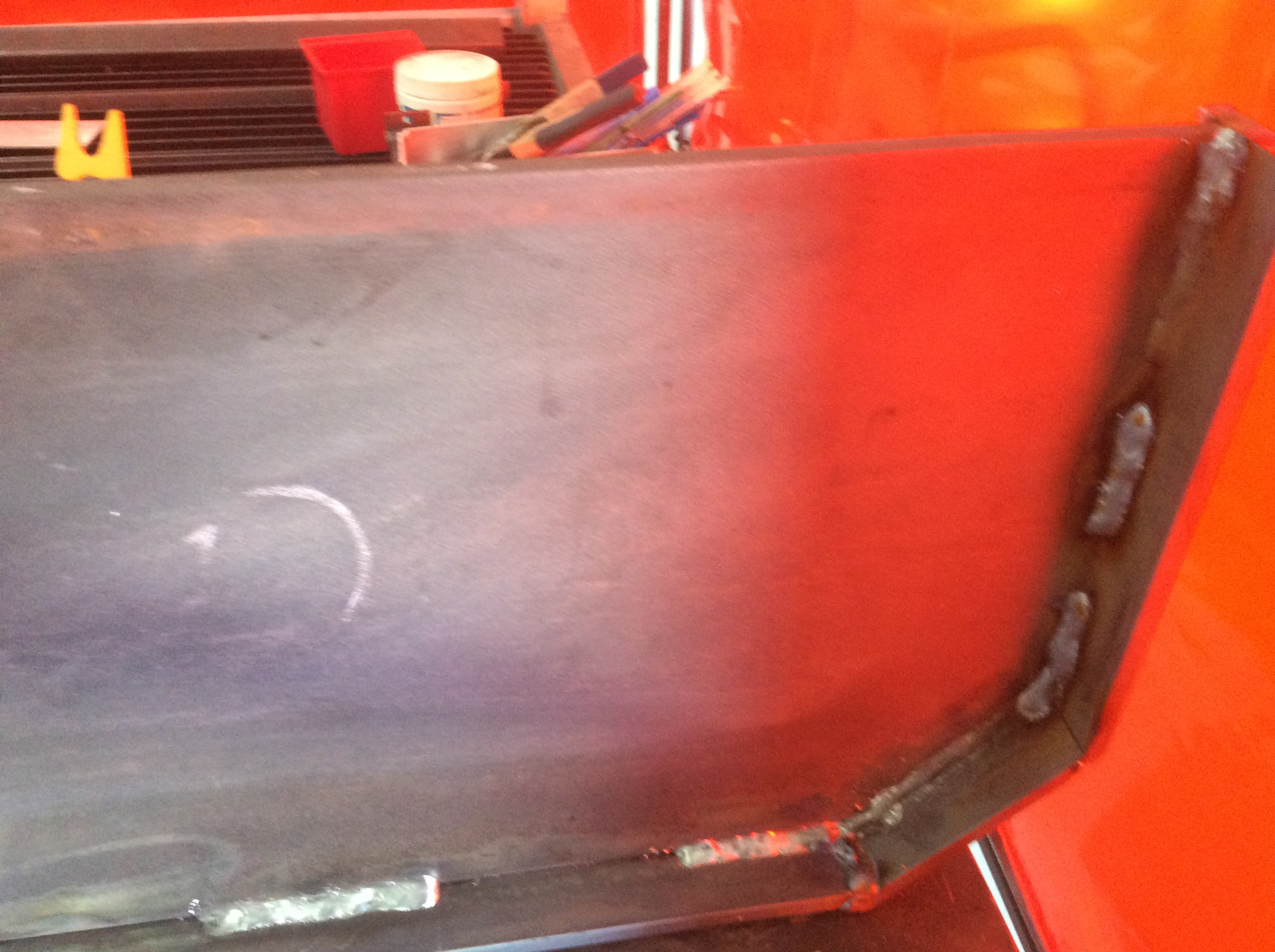

Afternoon #1 of grader project started with a visit to the steel yard where I picked up materials using Gordon's list. $460 which included probably $50 of extra materials for another project. Back to hangar to unload and begin. Pulled out the plasma cutter and first made the 3x3 triangle cuts on the side boards. Using a Hypertherm 1000 and a Miller 350P on pulsed spray for the welds (MIG), getting good results. Cutting and welding runners. This is going to be so useful. Mine will be 6' wide x 5' long, using used motorgrader blades. The upper structure I did not have to buy as I had scrap tubes for that. Although I was once told there is no such thing a scrap metal!! LOL

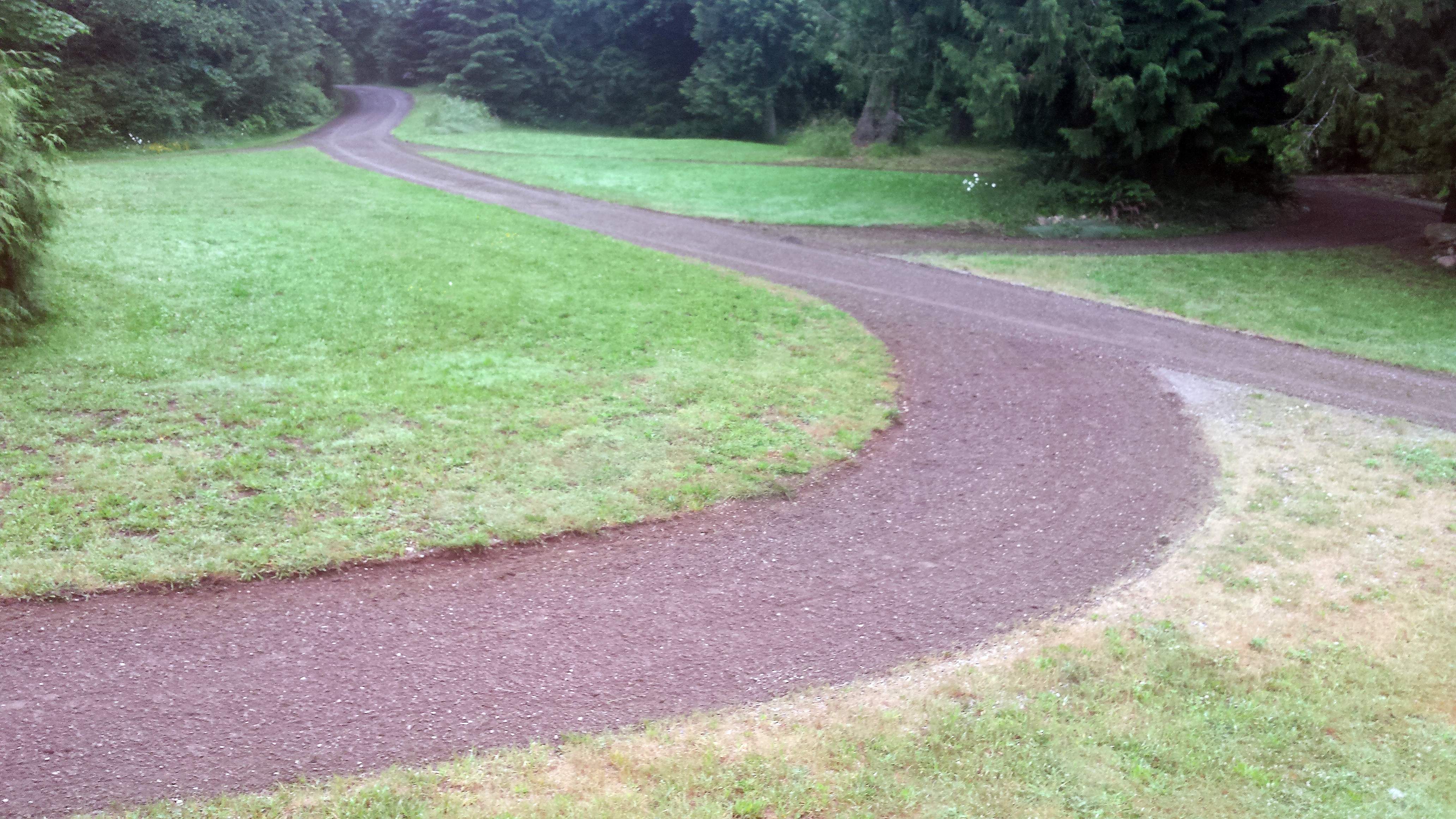

I am surprised that no one else has tried the ridiculously simple train rail solution to grading (see post #63).
Here is a picture of my driveways after yesterday's 'tune-up' of my hard packed gravel during some damp weather ...
The dark fines will be washed down during the next rainfall so the gravel will look like gravel ;)
Please post photos of your train rail grader. Those I've seen are usually a single rail or several chained together, with no front-to-back structure. They do good work side-to-side leveling, but do little for full width direction-of-travel dips and bumps. They don't cut the high spots and fill the low spots in that direction, just sideways.

As i mentioned, see post 63 for pics :) I have since added end plates to reduce the spillage off the ends of the rail.
You raise a good point regarding the dips and crowns. My driveways were already established when I started using the rial but I can still move crowns into the dips on the fly using my 3 point hydraulic top cylinder to tilt forward for digging/lowering and back for smoothing/filling.
