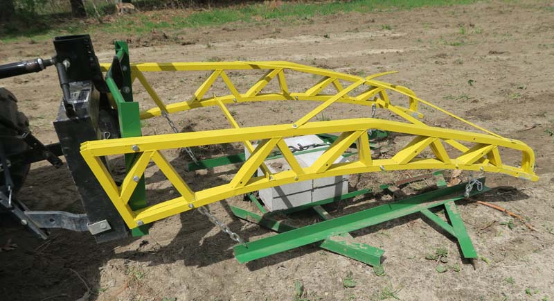

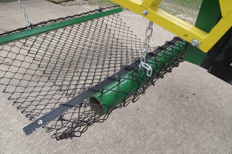

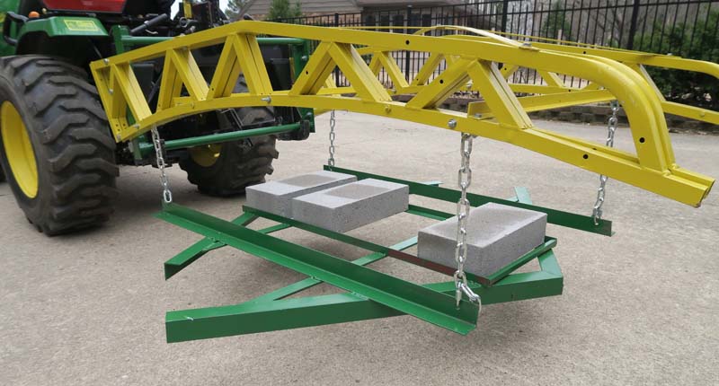

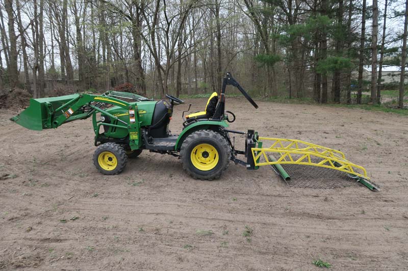

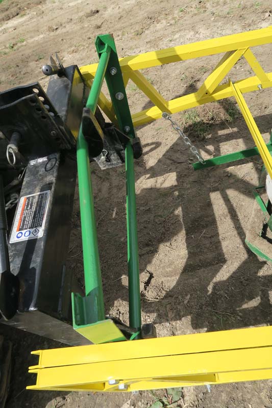

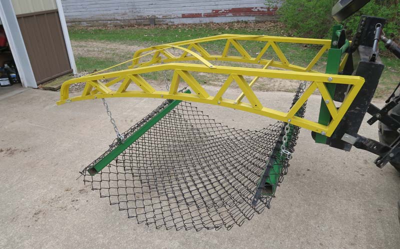

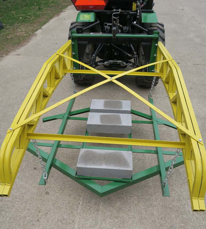

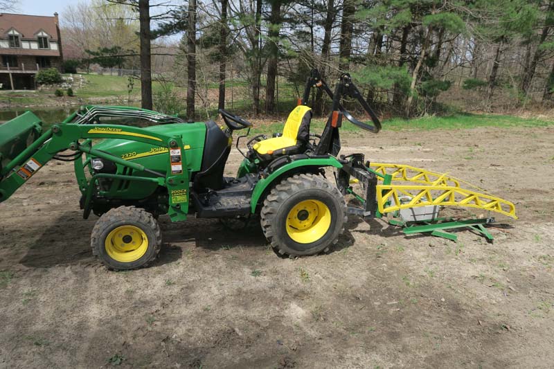

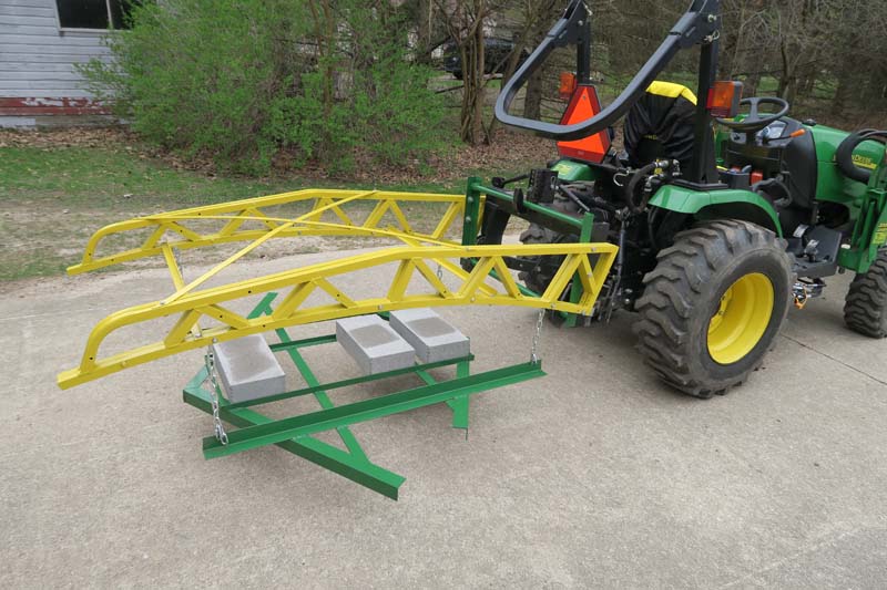

I built a plane and drag for my tractor from scrap angle, pipe and chain link fence. I built it so I could lift it with the 3 point, but you could downsize the idea and just drag it. With minimal welding skill, it's an easy project.
