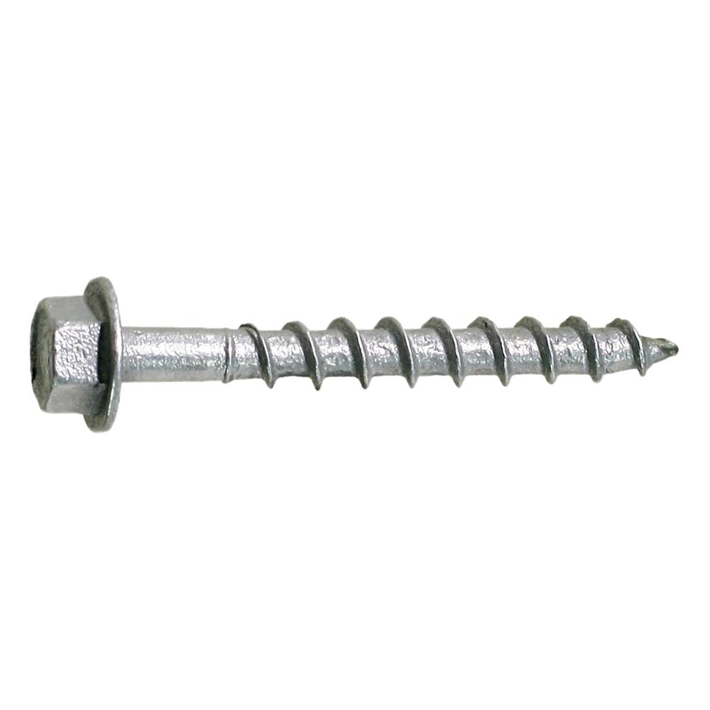

general Information on construction screws.
[video]https://www.familyhandyman.com/project/structural-screws-vs-lag-screws/[/video]
Simpson screw which I use quite often.
Note: my knowledge of screws is very limited. In the last few years many different job specific screw type fasteners have come on the market.
