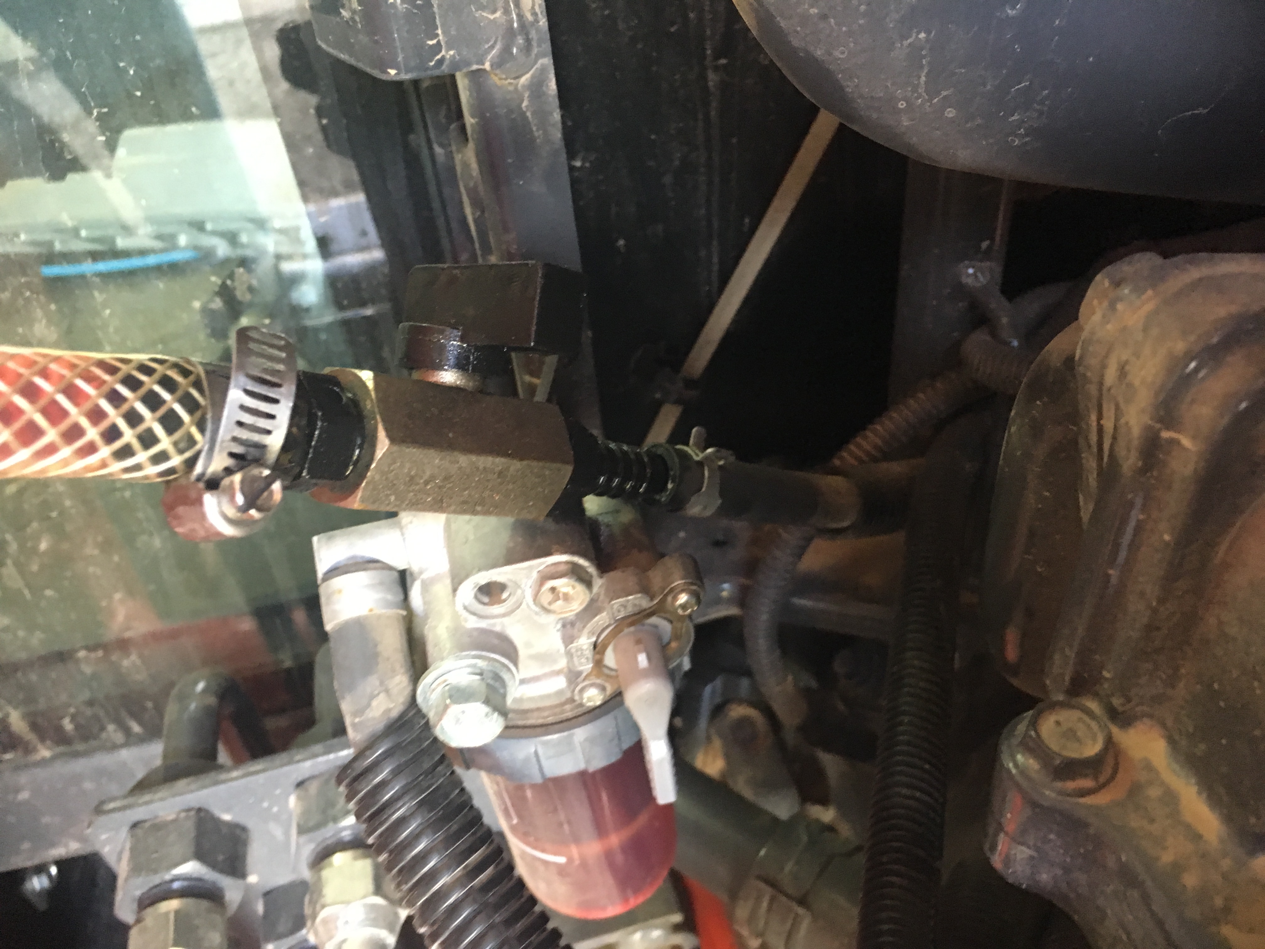

Charged up the battery and I tried again.
I am getting fuel to both sides of the filter. But, I was able to get a wrench on one of the injectors and got just a tiny bit of moisture there. I could not find the solenoid shut off to attempt to test it. I ran out of time last night.
I'll look at a parts diagram and see if I can find the solenoid.
